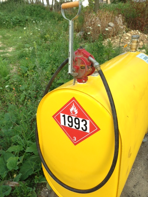

I built one using a free 175 fuel oil tank that had been pulled out of a house which was converted to gas. I got it from a oil wholesaler who had several of them. The tanks are also on Craigslist. Be sure to flush it out because there will be some sludge at the bottom. What I have noticed is that there are several different tank bung configurations. You will need at least two 2" bungs on top. My tank came with a fill gauge, and that gauge also takes a 2" bung, so now you are up to three 2" bungs. My first tank didn't have enough large bungs, so I had to sell it and look for another. I mounted my tank to a pallet so I can move it around with my skidsteer. Because of the fill lid would allow fuel to slosh out, I added a ball valve to the riser. The pump or gauge seems to allow enough air in so the tank doesn't form a vacuum when it gets cold.
Here is the pump that I used: Piston Hand Pump with Steel Telescoping Tube and Nozzle Spout
This is the fill cap I used: McMaster-Carr
If your tank didn't come with a gauge: Liquid Level Tank Gauge for ASTs-Direct Reading Gauge-Type D
Now they will sell direct to you, but it's actually cheaper to order them from here: Fuel Transfer Pumps, Gas Station Supplies, Fuel Nozzles, Transfer Tanks - John M. Ellsworth Co., Inc. Very helpful people at three locations.
Ordered my signs from here: Safety Signs and Labels - Easy Shopping with Guaranteed Compliance: ComplianceSigns, Inc.
If I purchase 100 gallons of fuel, my dealer will deliver it for no cost.
