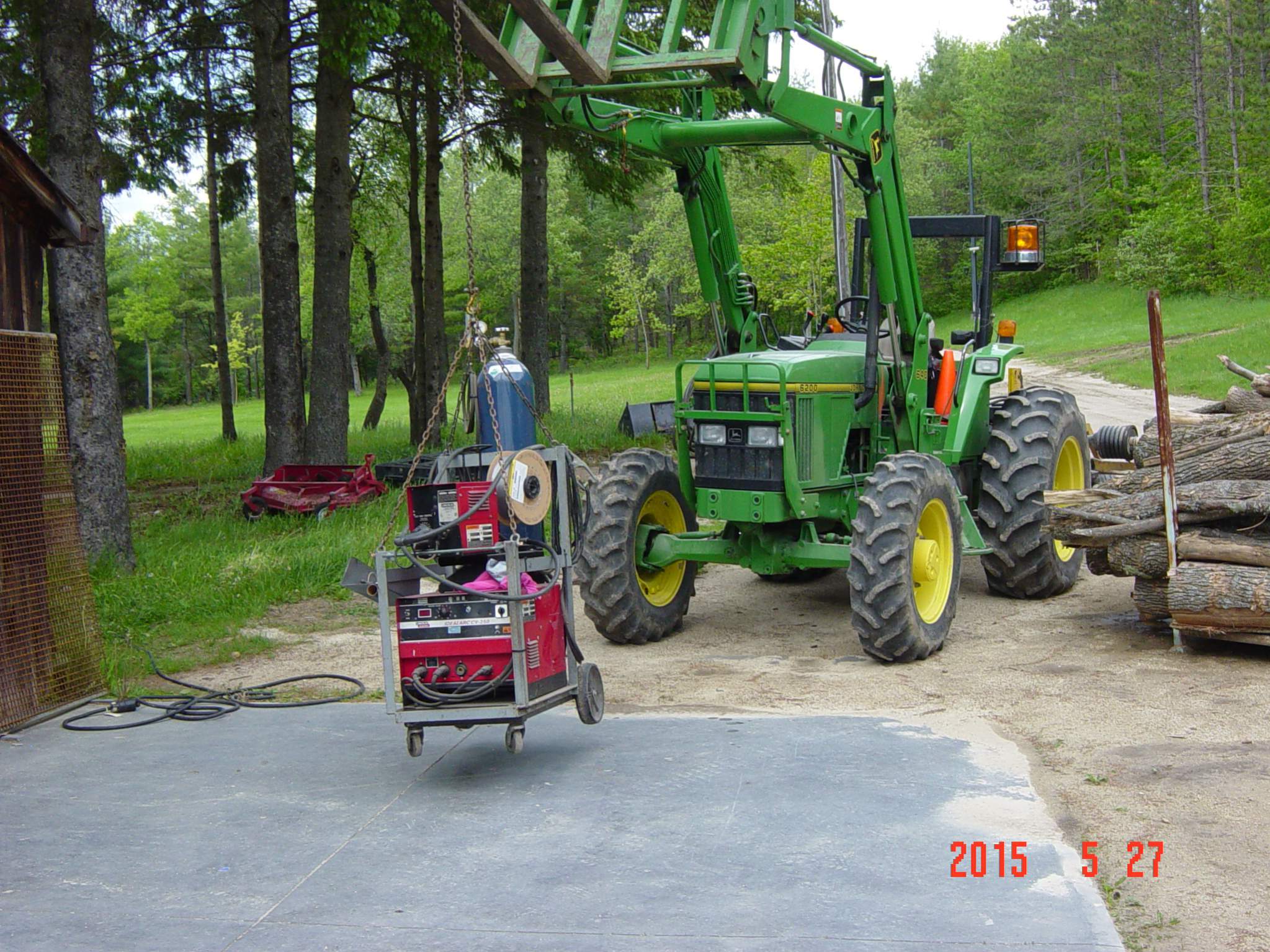

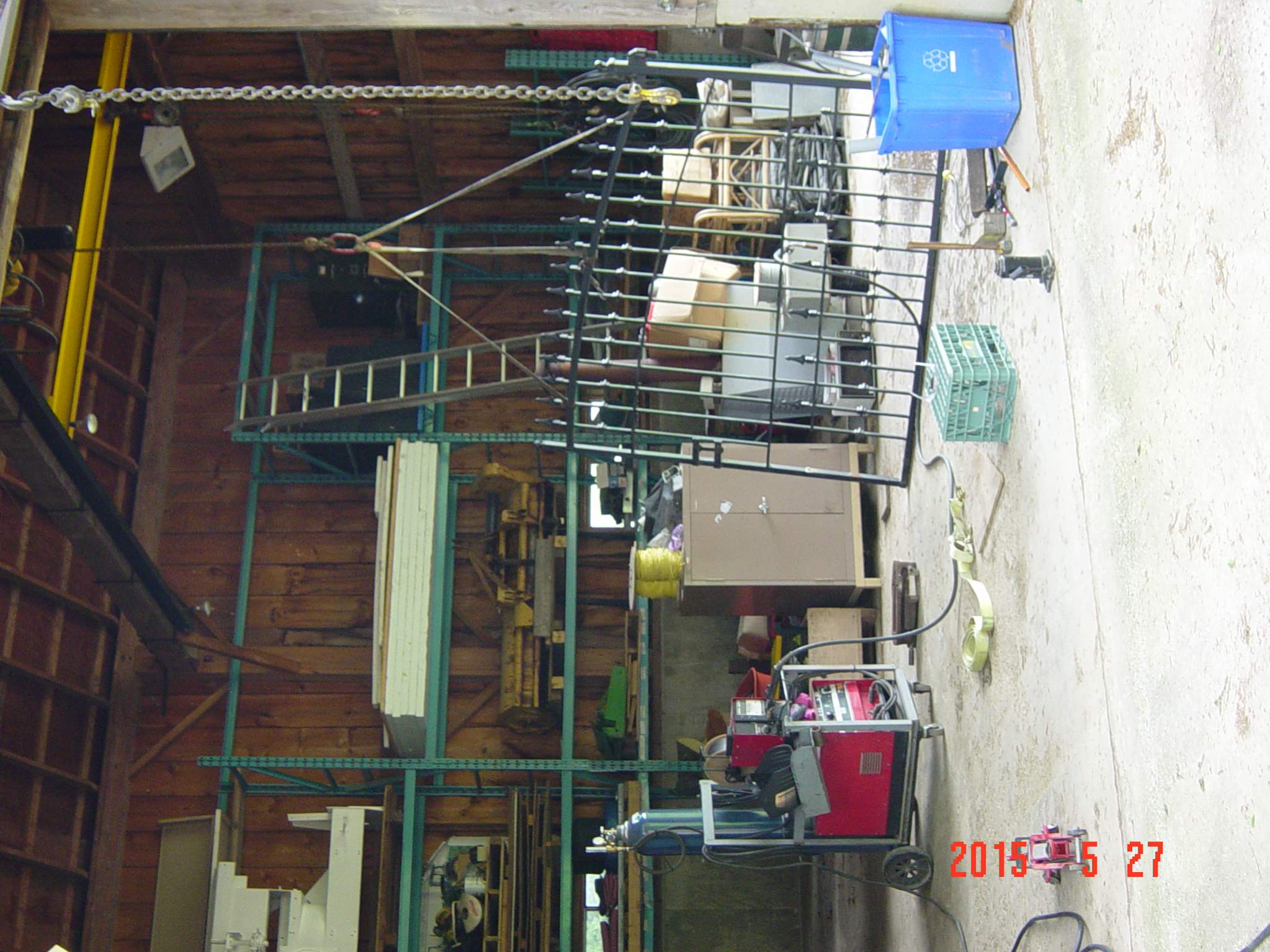

   / Anybody Weld With Batteries
#20
I don't really want or need another welder. This is not what I do. I am in the security business, and offered to fix this gate of a customer. The daughter closed the gate on a lanscape guys trailer.
