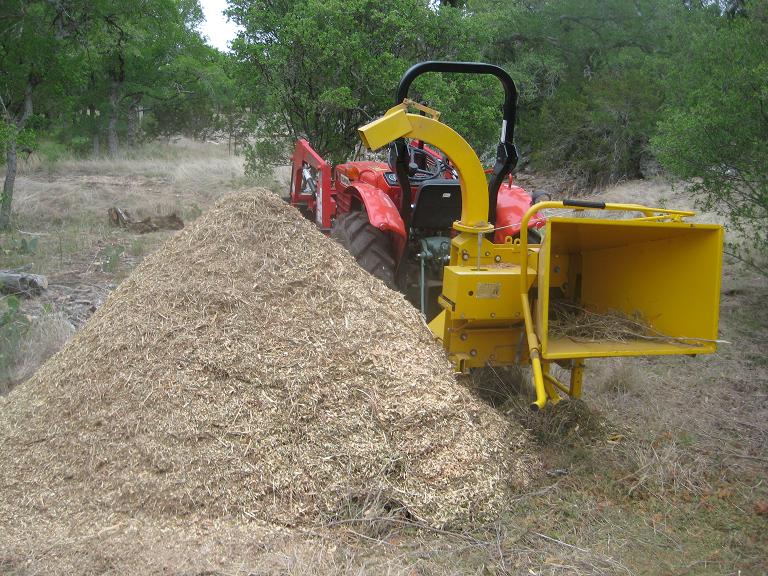

Well you can be proud and buy nothing or you can sometimes buy Chinese made items and get on with your life. Why does it matter, we're over-spending $1.44 trillion this year, the Chinese are going to own America anyway so I'm going to chip some cedars while I'm still living...
