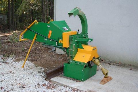

I recently bought an "Agri-Machinery" WC-6 that looks like the same chipper. I was quite happy with the quality and workmanship of the unit. I have only given it a test run so far, but have 8 acres of 30 year old logging debris to clean up so it will get a real workout. I got it on the auction site (seller Betstco) for 1349 and think it was a good deal. We'll see..........

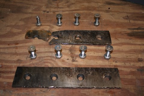

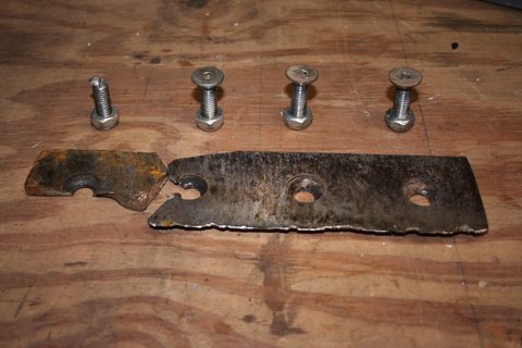

Just had a blade break. Again, it was frustrating to try and get hold of anyone from KPX. Their 'tech' number just went to a generic mailbox. Called the 800# and after about 15 minutes finally got a rep. He asked for pictures and said they would ship out new blades and bolts in 3 to 5 business days... no charge.
I think the blades are of very poor quality. I do not believe that the bolts are Grade 8. Also, when I was removing what was left of the blade it appeared that the bolts were over torqued... a real bear to get off.

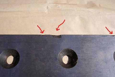

Received the bolts Friday afternoon (late). Today, Sunday, I decided to use the extra set of blades I purchased with the chipper. On inspection I saw that one blade already had a nick in it (pic attached).
I did not get the blades KPX promised.
Another thing! I read in the manual that the blade bolts should be torqued to 50 lbs. The safety label on the chipper says 30-40 lbs. What is it?
Also, I had noticed that when I removed the broken blades, there was the bolt and a nylon lock nut. The parts manual says there should be a bolt, washer, lock washer and nut. I was sent the parts from the manual - BUT - there is no way to get the nut started if you put on the washer and lock washer! The recessed holes were milled/bored 2mm to shallow!

How many hours did you have on those blades? Besides the break, they have a lot of chipping/damage along the edges. I have about 60 hours on my Jinma, I have reversed the blades and sharpened them, but they had basically no nicks in them. Makes you wonder what metal those blades are made out of?
Just for reference, I ordered replacement A8 grade tool steel blades from Mill Depot, ($35 each blade). I am hoping they hold a sharp edge longer, we'll see.
/ Anybody using a Liberty Chipper? #34
Moot, I have not seen everything nor do I know everything, sooooo here is just another opinion.
It looks/appears that when the end of the blade broke/cracked it sheared off that bolt.
What I have seen under normal conditions that the blade/knifes edge will become more rounded as they dull.
When/if the blade hits something hard (metal,rock etc) they chip, break,crack.
If the blades lacked proper hardness, the blades would not hold there cutting edge very long and the cutting edge would become more rounded quickly.
A set of blades with proper hardness are brittle. Meaning they have little to no flex. So if they hit something hard the cutting edge gets chipped up.
A good set of blades & anvil can be broke / cracked when tightening down (torque down) if the bed / surface they lay in is not perfectly flat/clean. They are so hard they are brittle .....no flex. They will break/crack before they bend.

I would not install the new set of blades you have pictured .... nor would I have even of sold them. So far all of my replacement blades have looked good / normal.
I had under 20 hrs on the blades. The chips you see are from the pieces of shrapnel that came off the blade and from the bolt head that sheared off.
I never did find the bolt head or about two inches of the blade.
I did a visual check of the blades the day before this happened. The blades where clean, without any damage to the edge and even felt 'sharp' to the touch. The anvil still had a edge, i.e., not rounded. My routine is to take 30 minutes after each use of the chipper and clean up/dig out any stuff caught behind the blades, in the Cutter/Feeder Assembly, etc., and squirt in some grease to all the bearings. That way I'm ready to go the next time I want to do some chipping.
I believe the original blade bolts were WAY over torqued at the factory (or whomever put them on). The manual said 50 lbs -but- the warning on the PTO shield said 30-40 lbs. I would be betting that the bolt where the break occurred (and all the other bolts) were well over 80 lbs. They were a bear to get off - had to extend the handle of my ratchet to get them off. The bolts were 8.8 grade. From what I remember from the DIN specs, 50 lbs was max for that grade bolt. Anyway I replaced them with 10.9 grade and next time I change the blades I'm going to 12.9 grade.

OOPS... I installed the blades so I could get some work done. Put two hours on them yesterday. I'm keeping a eye on them and will replace ASAP.:eek:
The original blades measure 9 15/16 (10) X 2 1/4 , holes are 2 1/2 o/c (close as I can measure). The anvil is 9 5/16 X 2 1/4 , holes are 3 3/4 o/c (close...)
The replacement blades were approx. 1/4" shorter. I noticed that because the stock migrates to the center of the flywheel as it feeds, just the 1/8" difference leaves a thin stringy 'tail' that is not cut.
KPX claims the WC-8 has a heavier flywheel vs. the WC-6 and that the chute opening is larger. That is why I went with the 8", I wasn't planning on putting anything larger than 5" anyway... now I revise that to < 5":rolleyes:
Do you have more specs on the blades you recommend and do you think they would work on my Liberty WC-8? Really does look like a Jinma knock off heh?
As for the clearance between the blade and anvil - I have mine set to .025, about the thickness of a credit card. The manual says .010 to .030, what do you suggest?
Also, I thought there was a dye/black light trick that could show stress/cracking on metal. I'm searching the web now. Any insight there?
