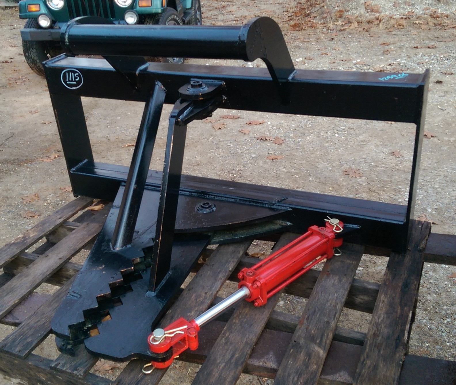

We have a generic one... pic below... Great attachment for small stuff, just have to remember the limitation of the FEL... We use it all the time... (& we purchased still new... for a crazy low price at an auction, which made even a better deal...)

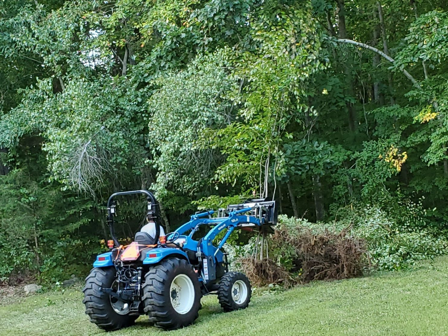

Pic of it on our TC40D...
I have an adaptor plate for the 3 Point hitch which will allow us use it on the 3PT also... but haven't used it that way yet... but should have much greater pulling power for stumps...

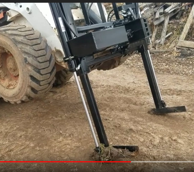

I recommend increasing the budget and getting a higher quality puller: Buckthorn Puller
And then there is this version:

Do you know the brand - it looks pretty nice with a push bar. Would you say it will handle 2 1/2” trees?

@TmbrWlkr - we pull 2 1/2 - 3" stuff (especially if it is shallow root stuff), if it is stubborn stuff we just rock it back & forth & it usually pulls.
The most important thing is awareness of your tractor's FEL / hydraulics capabilities & not push it... You can definitely break stuff...
I believe ours is made by Mid-State Attachments (I can check)... again we bought it at an auction (actually 2 of them) & a 48" grapple... all new... super cheap. They are not the heaviest built nor the quality of some of the above mentioned units. I looked at them all & decided for our use & the ability of our machine these would work well for us. They are also lighter in weight then most I looked at, which was important to me as every pound a the attachment weights it takes away from the loader. If I had a big machine or a skid-steer I might have purchased a much more robust unit but our machine will never pull the stuff those implements are designed to pull...
So, for us this was an incredible purchase for the price & has worked very well for our needs...

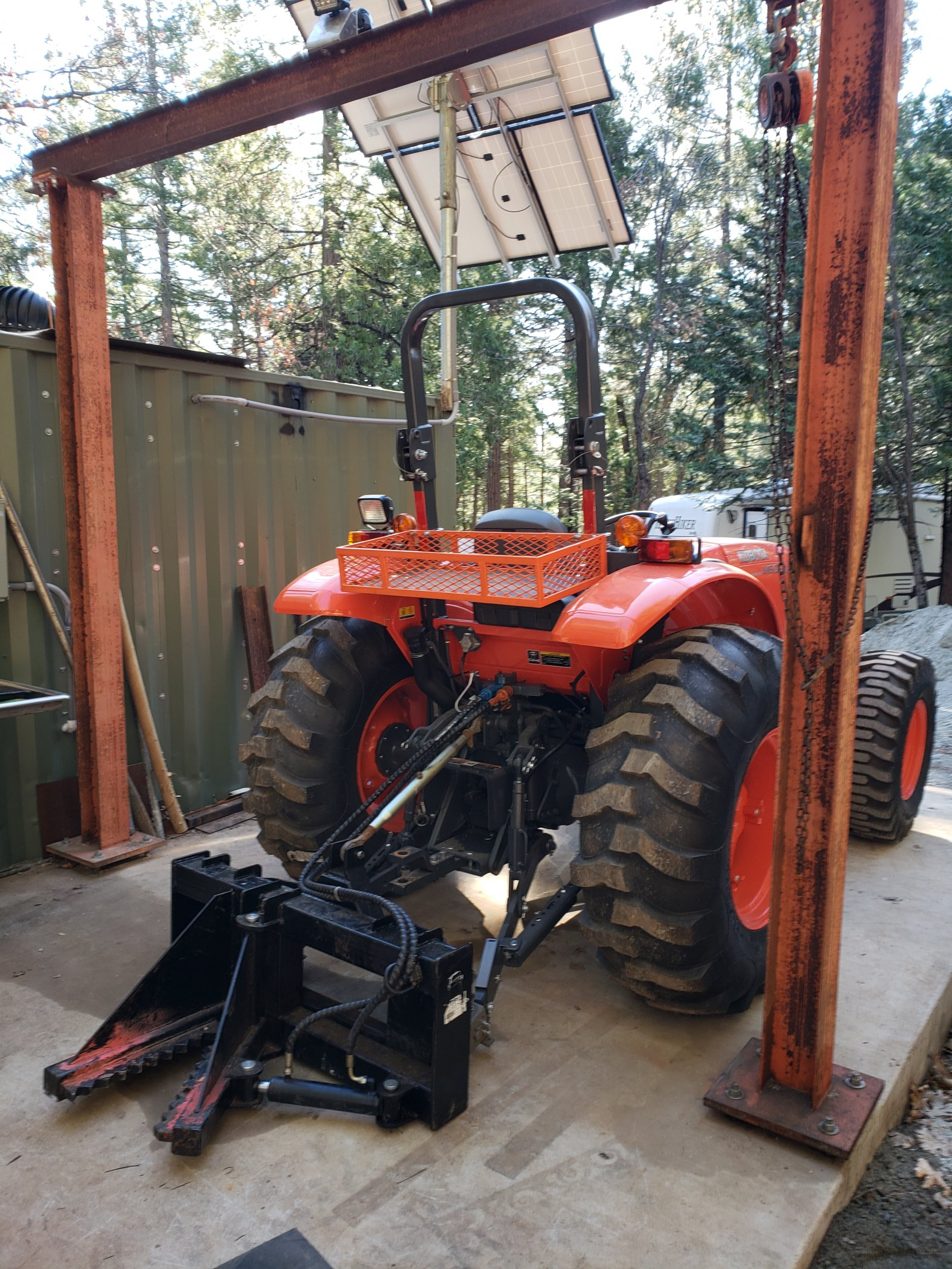

I've had mine for 4 years. Pulls tree's up to 6" easy and 8" with a little extra work. I pull ceanothus bushes about 3" around and 30 feet tall with ease. I use the " jaws of death" on the 3 point and a grapple on the the fel. Makes for quick easy work!

@ranger danger how is yours attached to the 3 point? i world like to replicate your setup
/ Anybody use Titan shrub puller #17
I have a quick hitch to 3 point adaptor so I can run all my fel implements on the 3 point as well. I got it from Titan. I looked but I could not find a pic. Ill look some more.

I used mine the same way.
Puller on the back, grapple on the front
Cleared out several acres of 2-5” gum tree saplings. Worked great.
