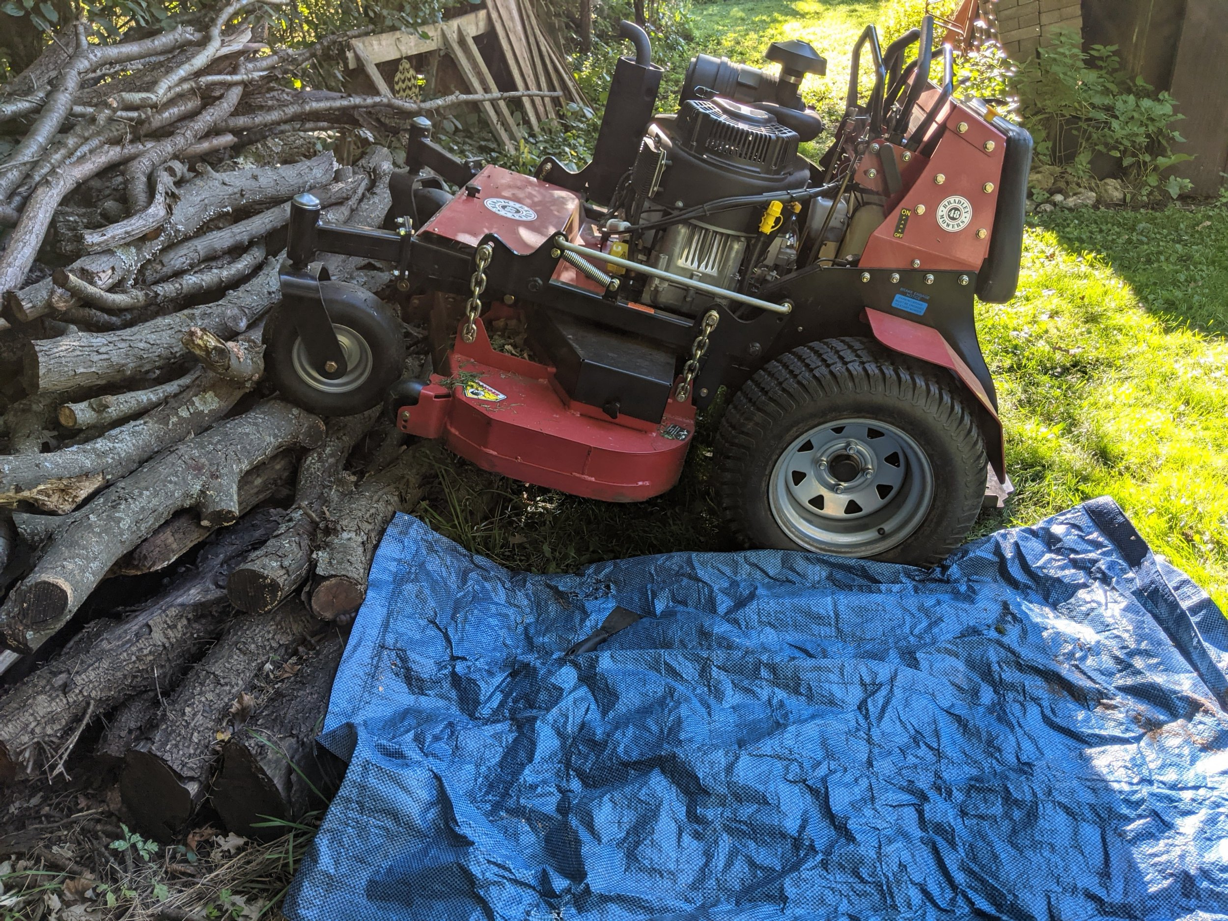

What my front end loader is for...
I used to do this:
Then I got lazy and started doing this:
