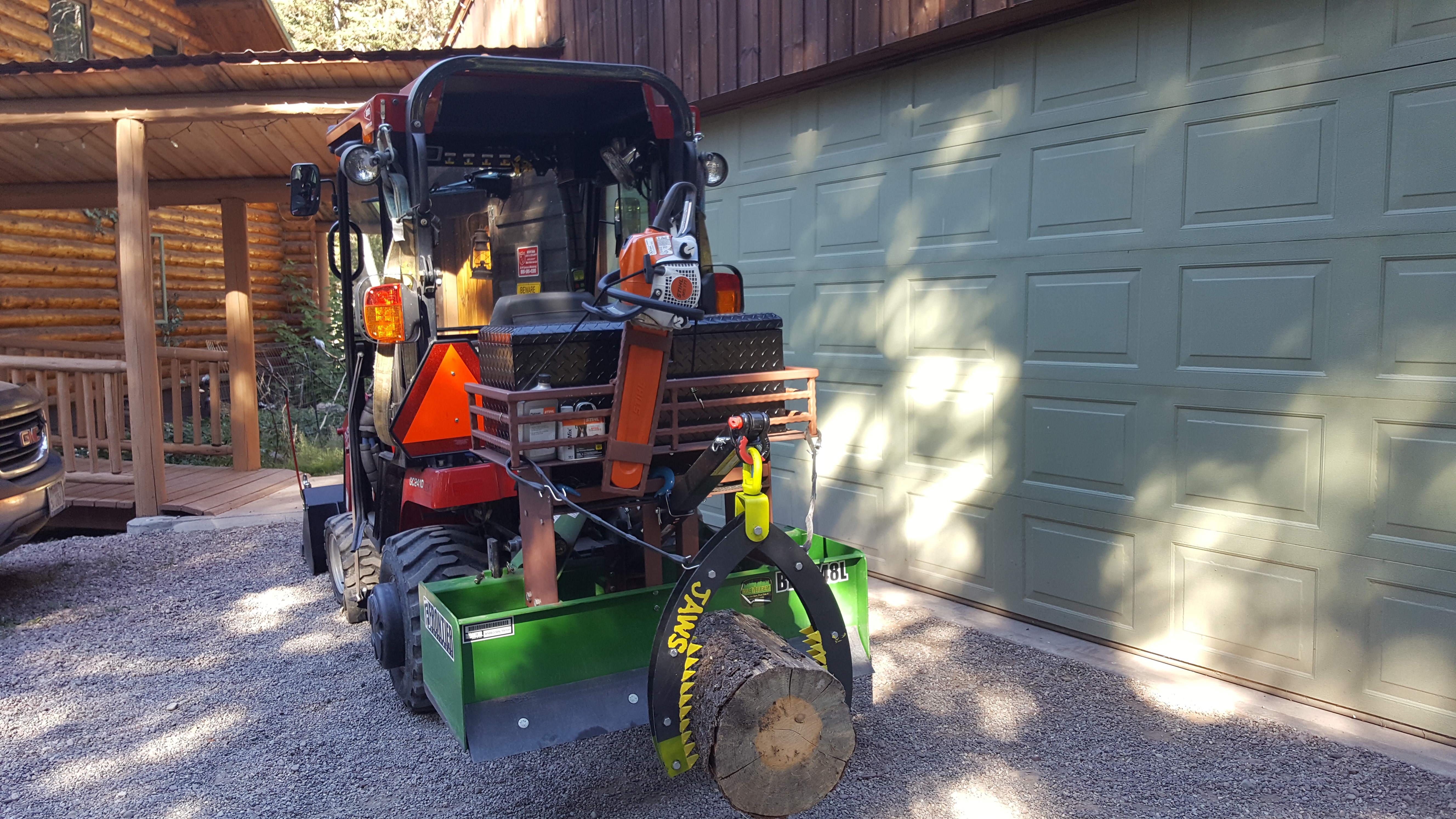

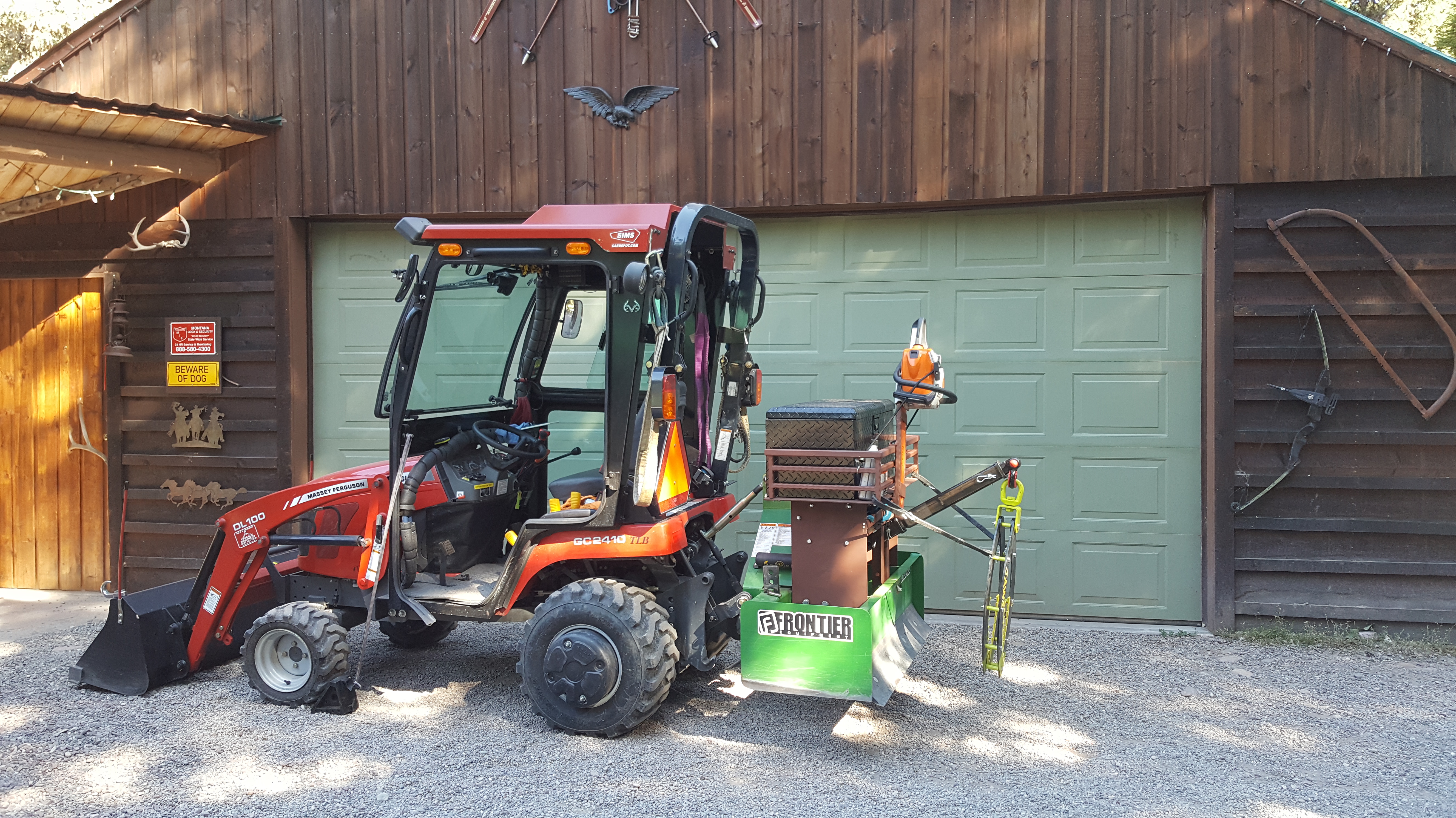

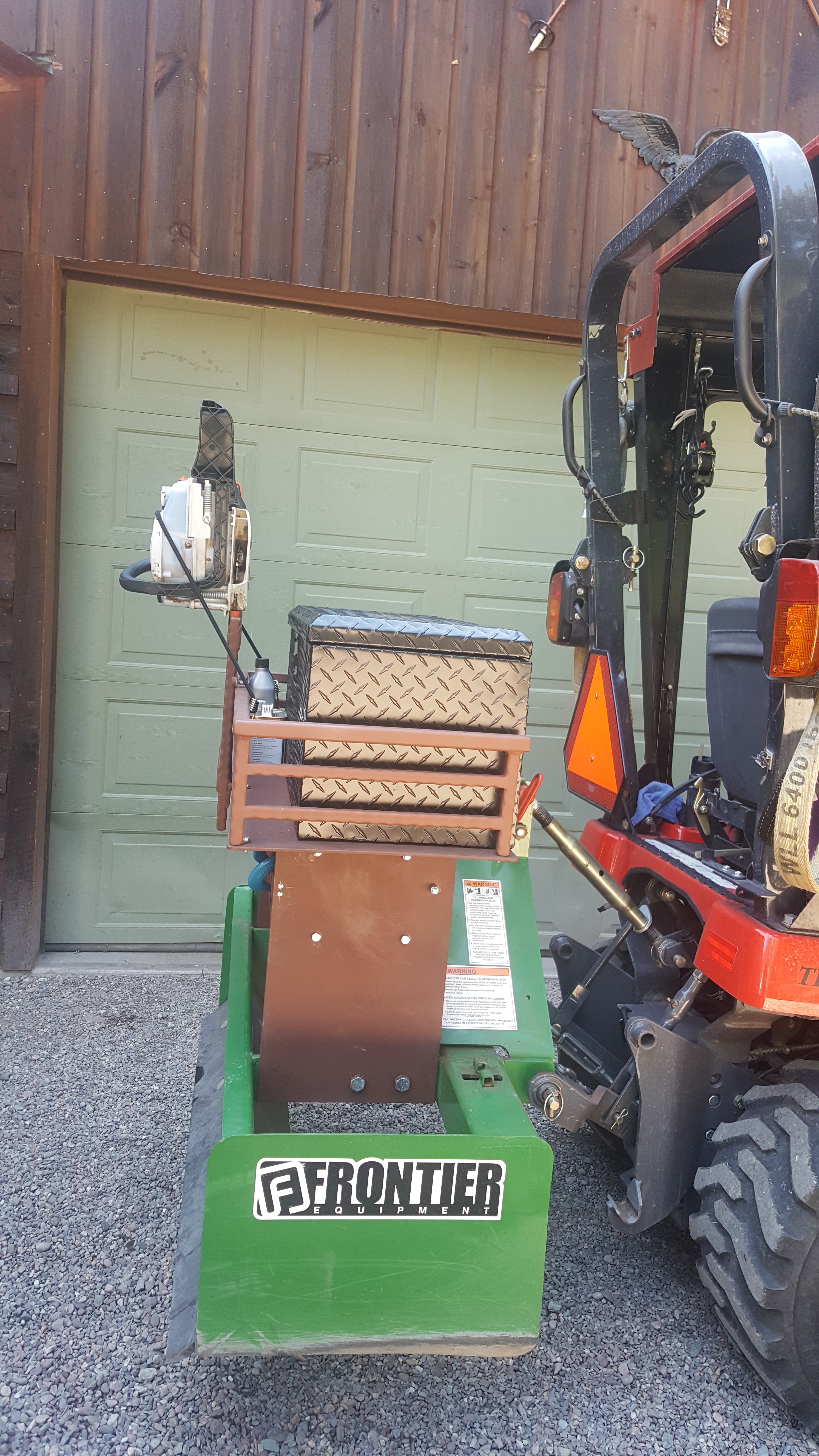

Last summer I added 1/4" plates to the top of my Frontier 48" Box Blade.
I have been thinking about adding a few accessories to the BB for a while: 1st, wanted to add a receiver hitch; 2nd, needed more weight on top of BB for leveling out road mix; 3rd, needed somewhere to carry my chains, straps, etc...; 4th, needed somewhere to haul my chainsaw, fuel, oil, chaps, etc...
I purchased an aluminum ATV box and some 1/4" thick A36 material, and ended up with what's shown in the pictures below:
Spreading/leveling out 4 full dump truck loads of road mix for a neighbor was so easy with this added weight.
I also added in my "poor man's grapple", JAWS to drag logs.

Glad to help you with my modification, and it's great to see others giving you options also.
Look forward to see what you will decide for your added weight.
KC
KC
View attachment 636620 View attachment 636621 View attachment 636622
KC, now that setup deserves a Rube Goldberg award of the month for ingenuity!! :thumbsup::laughing:
