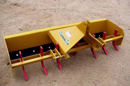

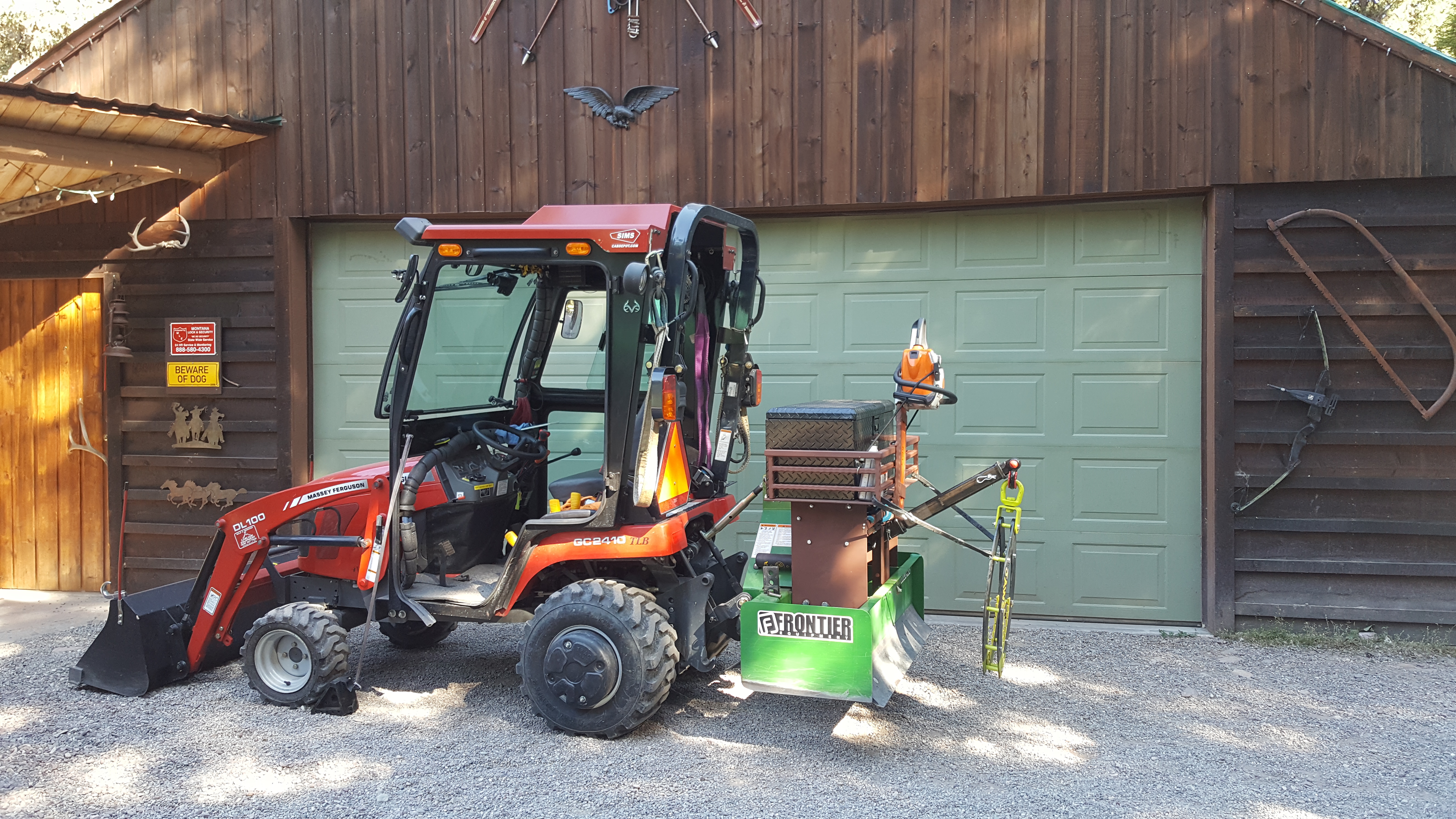

Thanks for all the ideas. I don稚 have any Rails , nor do I think anyone around here sells them. Great idea though! I considered the filled block, but I didn稚 think they weighed that much. I do have a bunch of 3x3 angle, so maybe make some holders out of them. Problem with that is how the box blade is built (see pic), I can稚 go straight across the back of it. I might be able to get 1 1/2 blocks on each side, maybe 2 each side if they are vertical. I will have to get some measurements....
I also like the idea about getting some used barbell weights, but have not seen any around here in a long time.... I think most have gone to the scrap yard long ago.... you can cannot even find any used tractor implements around here!

Ya, it's not rocket surgery. There are just 2 factors, is it heavy & can you strap, chain or attach it well enough so it wont fall off. Even a stack of lumber or rocks can meet that most of the time.
That tower brace does make things a bit harder.

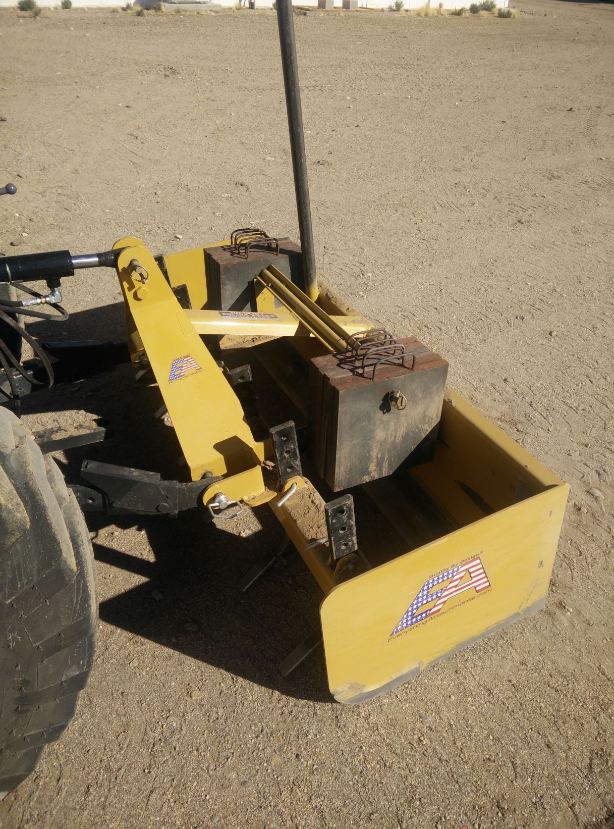

I used a weight lifting bar and put on all the weights I could find, one at a time obviously, maybe 400# and was able to lay it across the bracing on the rear of the blade.
Weights are easy to find fairly cheap because not many people want them laying around.

Look at yard and garage sales and get 25 and 50 pound barbell weights.... You can add or remove weight as necessary... All you need to really add to BB is some vertical rod of sorts to keep them mounted...
Dale
This is exactly what I did. Welded a piece of 1 1/2" pipe vertical on the back of the box blade and stacked up the plates. Works well with Olympic style weights.20181125_140548.jpeg
