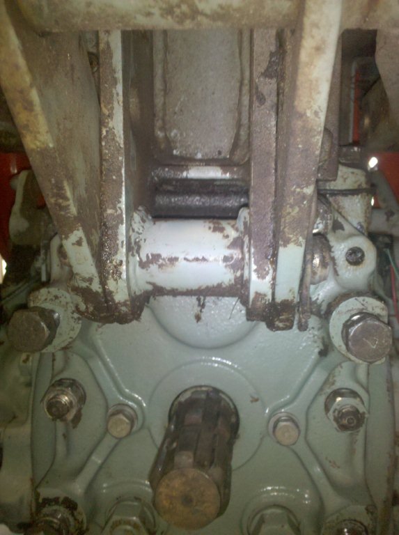

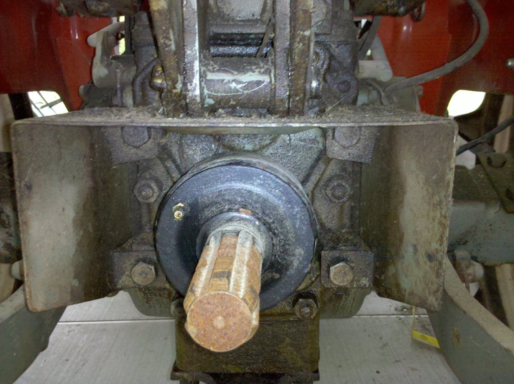

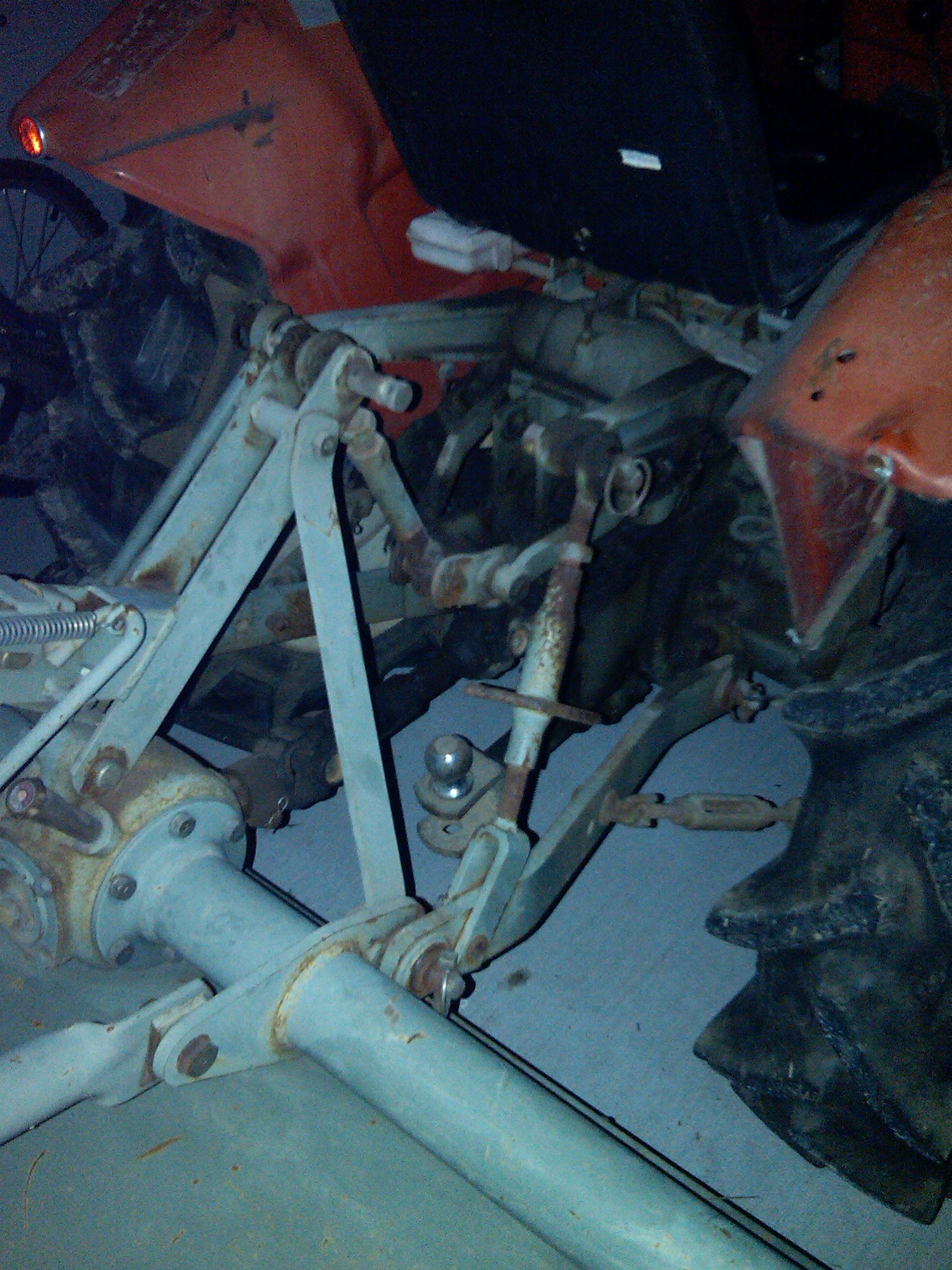

I've run into a problem. The Top Link Bracket (TLB) on my 1610 extends down further than on some of the other 1610's that I been able to find pictures of. It actually fits into the indention in the top of the PTO shield. Because of that, the top of the lower rollbar mount (LRM) will not clear the TLB and therefore the four holes will not line up so that I can bolt the LRM in place. I've attached some pictures to help explain what I mean. The first picture shows the PTO shield and the TLB actually resting on the shield. The second picture shows the TLB with the PTO shield removed. The third picture shows how my tractor is setup with the tiller attached. It uses the bottom set of holes on the TLB (there are three sets of holes) to attach the top link bar to the tiller. I'm not sure what to do at this point. Maybe I could take the TLB off, turn it upside down and reinstall. I know that means I would have to reconfigure how the tiller top link bar attaches. Anyone ever run into this situation? Any suggestions?
Monte, stop & pressure wash that machine before you mount the roll bar !
The 1610 comes with two styles of top link tiller bkts you have the lower mount kind. Maybe you could find a dealer with the other style, the non folding type.

I don't have a rops so I don't know about that. I do have a tiller that looks very similar to yours. Mine is an rs1300. I do not have that special tiller bracket on top. I just fabricated a shorter adjustable top link and it can hook up on any of the holes in the top link bracket. Don't know for sure yours would work like that but if it would you could turn your top link bracket over.:thumbsup:

I bought some Simple Green and did some cleaning this afternoon. Plan to fire up the pressure washer in the morning. A couple of those pics were taken before I did any clean up.
I didn't realize there were two styles of top link brackets. I think I'll try turning mine over. If that doesn't work I'll follow your suggestion and see if I can find a dealer with the other style of bracket.
I have the rs1303 tiller. It does a great job. Thanks for the info. I should be able to attach my tiller the same way you do. As you suggested, I'm going to turn my bracket over. That should take care of the clearance problem. I have a couple of different size top links. Maybe one of those will work for my tiller. If not, I can envision a trip to my local Tractor Supply. I've got to know those folks pretty well in the last few weeks! :D

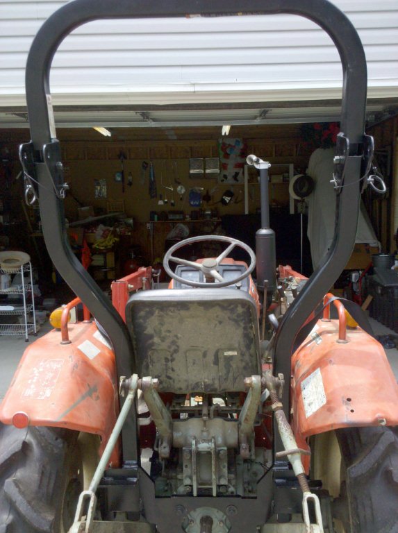

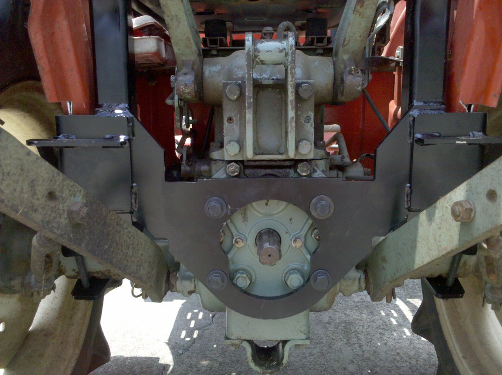

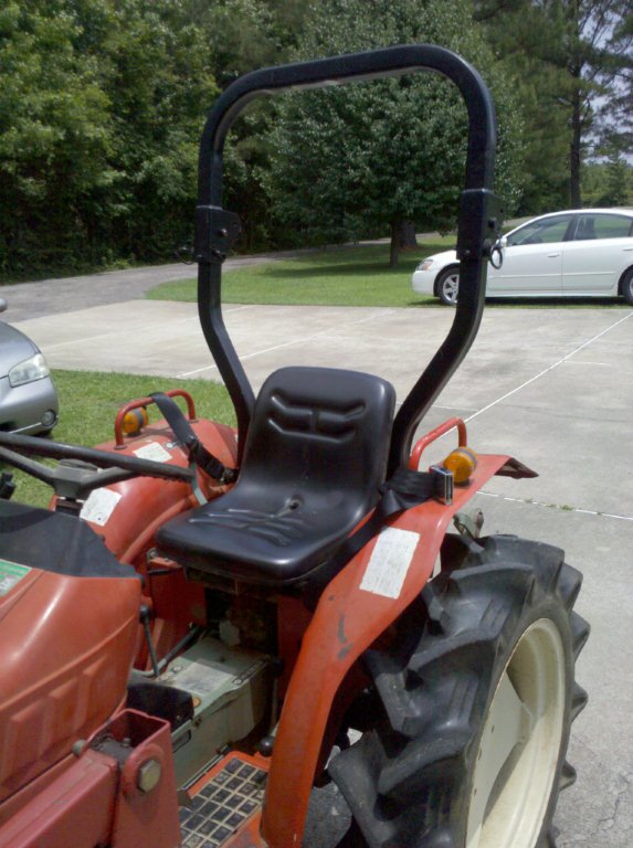

Success! I got the ROPS installed today. It only took about two and a half hours. Thanks to everyone that offered tips/suggestions. I would also like to thank a friend of mine, Jason Haney, for his help. He made the installation easy. I did have to turn the Top Link Bracket over to get clearance for the lower rollbar mount. We ran in to a small problem with a stuck pin in what I would call the middle lift arm. We had to remove the left upper lift arm so that we could hammer out the stuck pin. Once the pin was out we reinstalled the upper lift arm. We removed the remainder of the "Tiller Attachment Setup". This can be seen in the forth picture. It is what the top link is attached to. After that was removed we installed the ROPS. It was a very straight install. One thing to watch out for, not already mentioned in this thread, is to snug up the lower rollbar mount before you drill the holes in the fenders that you will use to bolt to the ROPS. If you don't, you will drill the holes in the wrong place. Fortunately, I realized that with the first hole I drilled. Thanks again to everyone. I appreciate the help!
