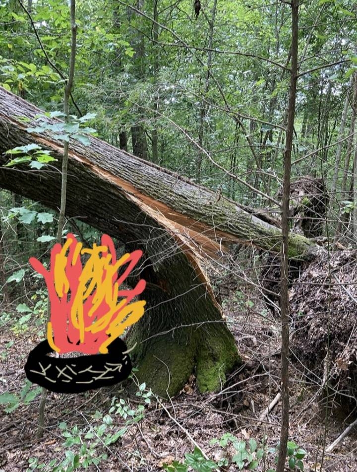

It looks like a good portion of the root ball has come up.
First thing that I would try would be to hook about 40 feet of chain
to the base of the tree and using your tractor, pull perpendicular to the tree.
The root ball may just roll out like a wheel.
(Make sure to chain to the tractor below the axle level)
If that's a no go, you could try cutting some of the exposed roots
on the other side of the tree and try the same pull again.
