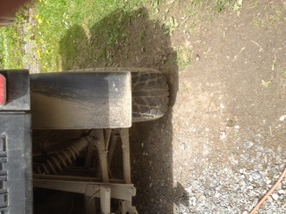

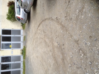

i uploaded pics of the track the right hind tire produces during turn and of the right hind tire.
original tires produced the track also
tire in pic has road profile since i changed to Chineese tires with road profile because the original
Carisle tires wore heavily on road surfaces.

i got a Polaris Ranger EV and have the problem that in turf mode the right hind tire makes marks on gravel
surface.
Is it always the right-hand rear tire no matter which way you turn?
Did you check to see if the brakes on that one aren't perhaps dragging a little?
Is the wheel sitting square on the hub? Is it tracking true to the frame?

i did more testing and had a friend look during the turn.
we found that that the outer front wheel is producing the markings on the gravel.
looks like the hind wheels are pushing the front outer wheel out of track in the turn.
but the front wheels are turning freely when jacked up.

Yes that's front tire scrub... Mine will do that too in tight turns. I wouldn't be too concerned as long as front wheels are in alignment.
   / Any Polaris 4WD Experts? I'm Disappointed With My Ranger 500 In Snow #56
A little scrubbing in the front will be normal. But checking your alignment is probably a good idea. Rangers are typically 1/8" to 1/4" toe out.

Yes you have to remember that the right tire on a left hand turn is taking most of the steering effort as the left inside tire is light so to speak and the right has more pushing forces. The vehicle is trying to go in a straight line. Ask any NASCAR guy, they know all about push. ha ha
