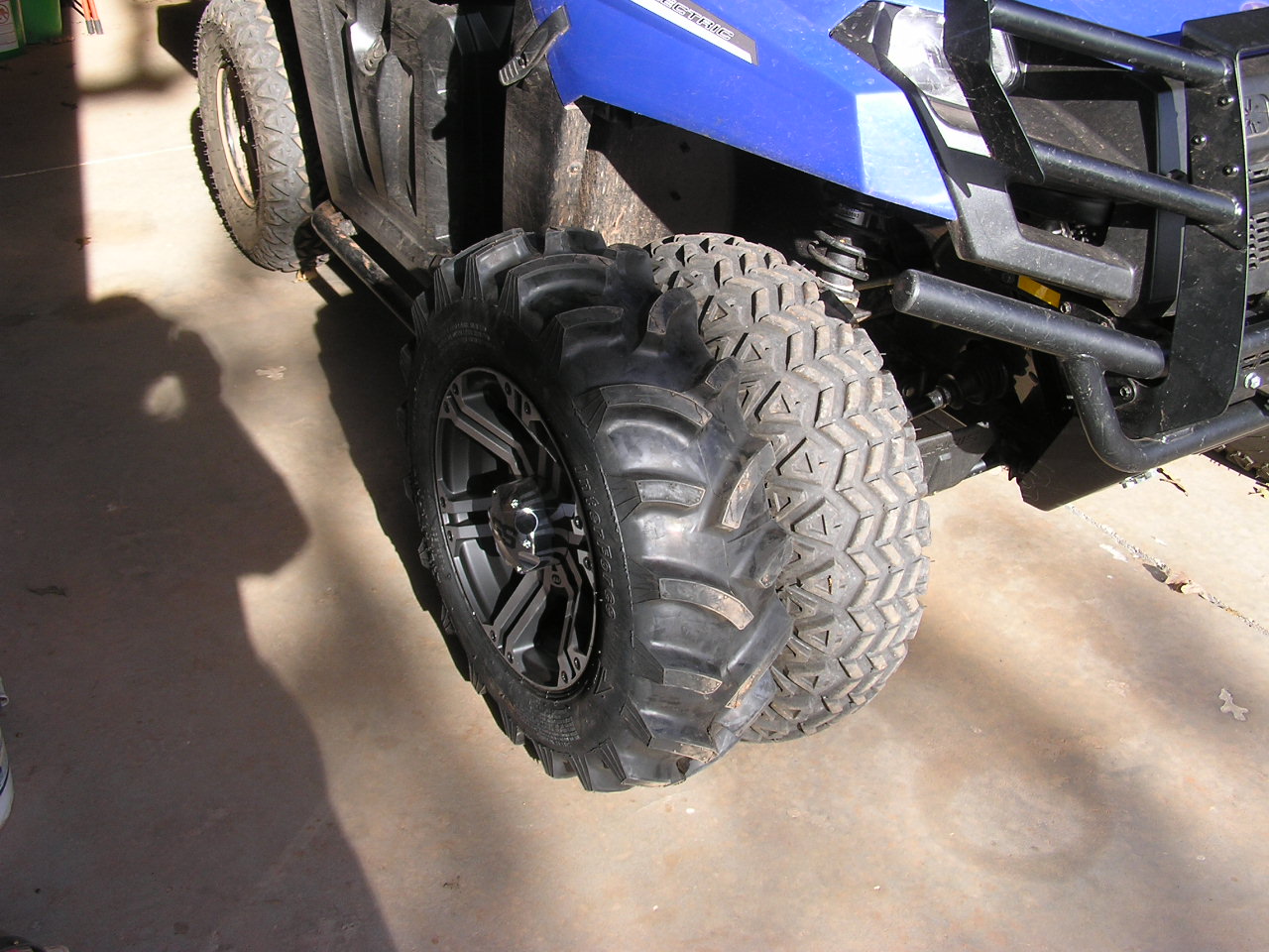

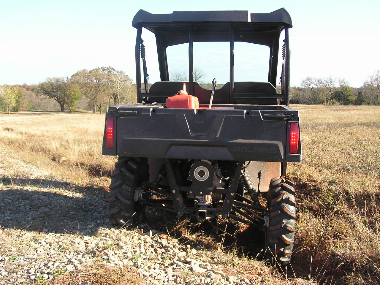

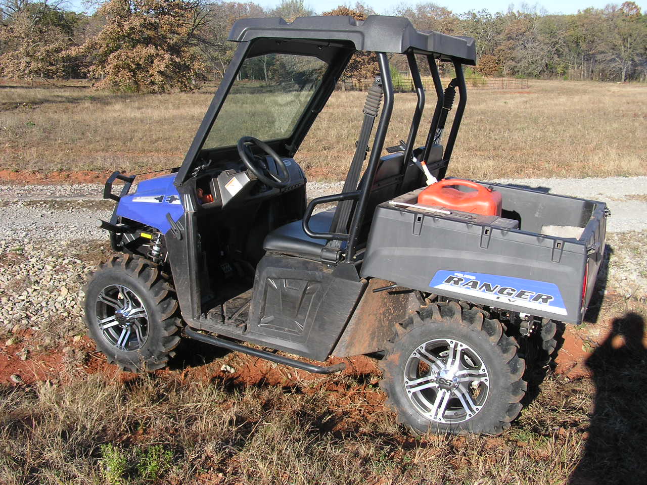

My EV did the same thing if I made a sharp U turn. I think it is because there is so much torque available from the 30hp AC induction motor. I haven't noticed it as much since I changed the tires.
My EV thread: http://www.tractorbynet.com/forums/atvs-utility-vehicles/287792-electric-polaris-ranger.html

Can you post a pic? It maybe just from tire scrub during tight turn. The wider the tires, the more the scrub.
