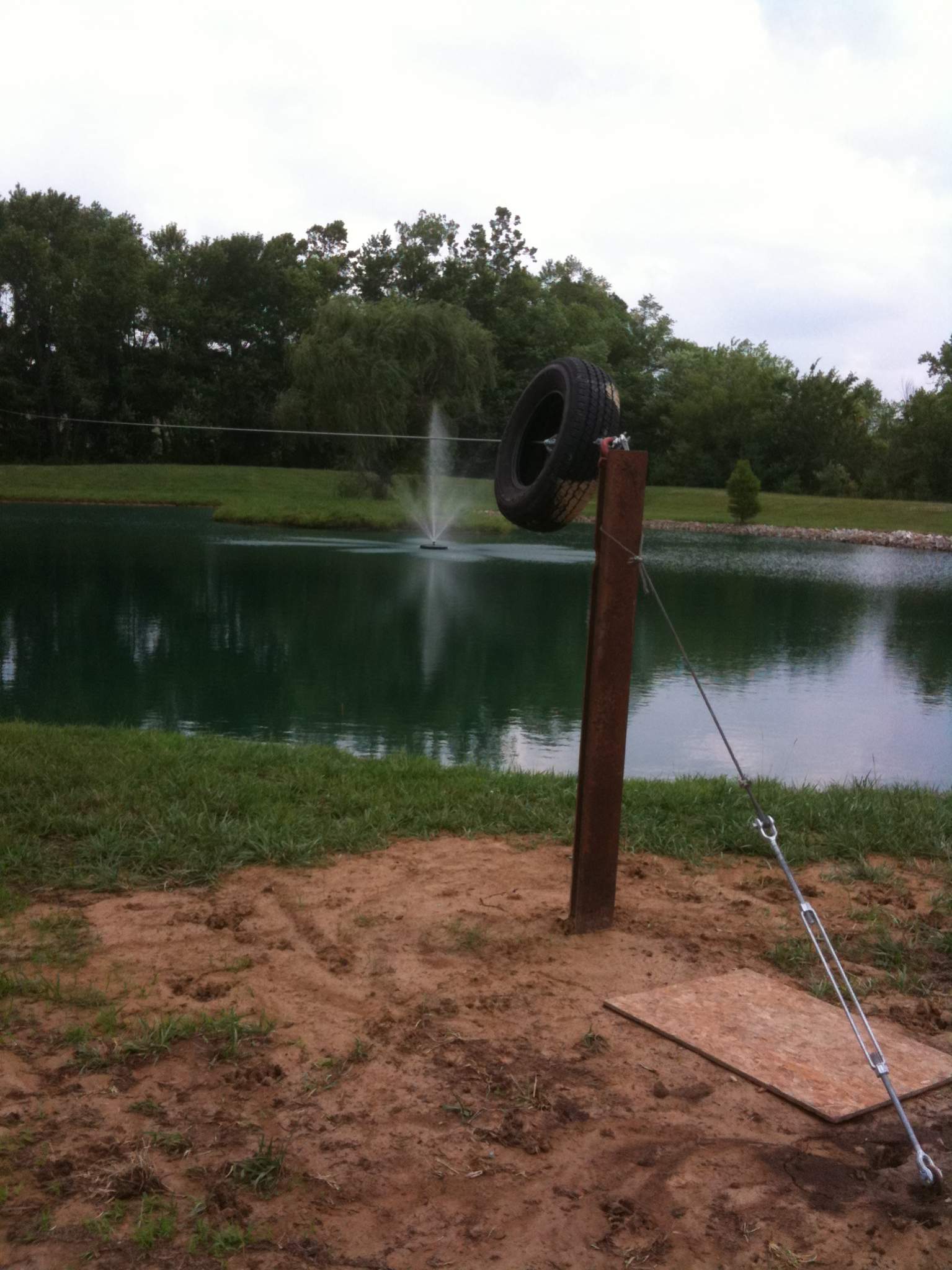

Well, we've had a lot of short but heavy rain showers in the last week, so I've waited to put the guy wire and turnbuckle on the RR track. I figured that it's been long enough, so I pulled the RR track back straight and hooked up a 5/8" cable and turnbuckle for a backside anchor. Once I released the RR track from holding it with the excavator, it seems to be holding fine. That 6' piece of 8" I beam that's completely buried with only a 5/8" eye bolt showing above ground hasn't moved. I even plated to top half of the 8" I beam and, I assure you, you can pull it out of the ground with the eye bolt before you'll pull the eye bolt off. :D
Doesn't it seem like everything takes longer than you plan? Gees, I figured to have already have had the launch platform built by now and be working on replacing the surface of my dock this weekend. Oh well, I sent my son's (fat) friend across the zipline this morning after my work and it never moved. He weighs about 350 lbs. Now it's time to run off to get the posts, lumber and concrete for the launch platform. Then when I get back, I'll have to decide if I want to begin the work on a sunny 95 degree humid day though. :( I'll get the materials anyway. ;)
