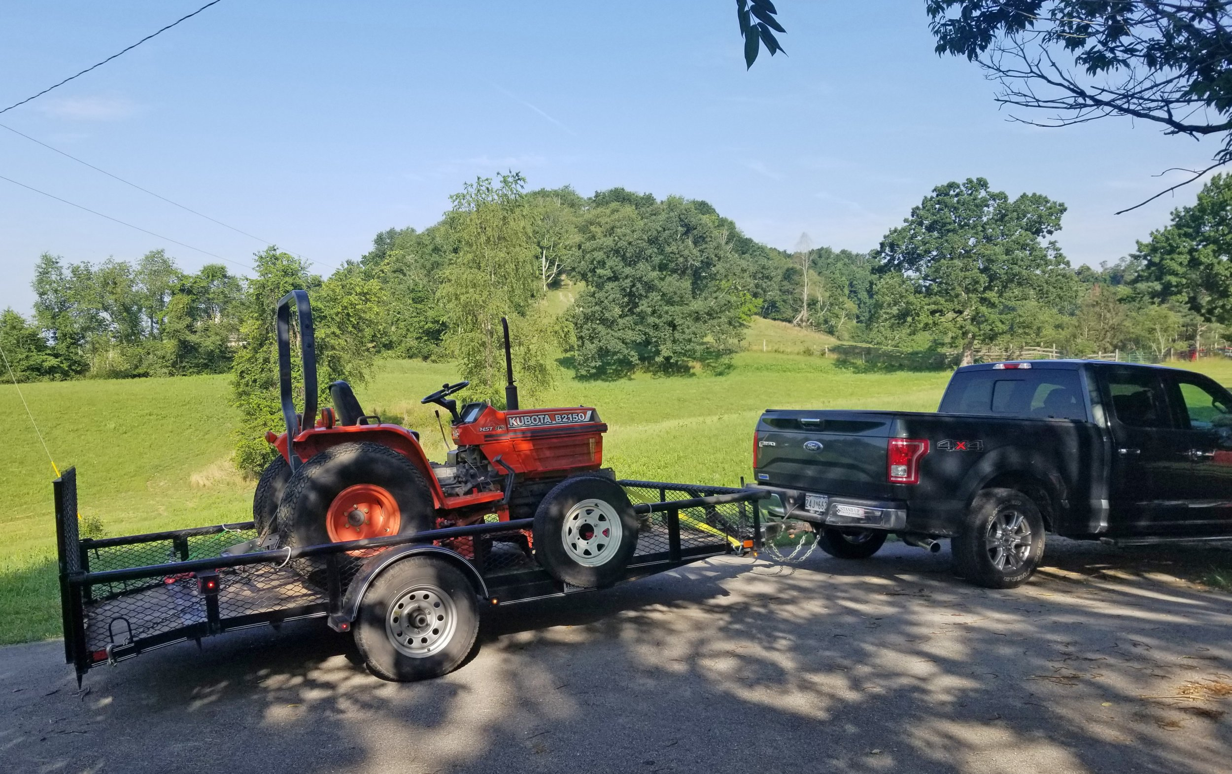

Mine:
this picture does have me thinking a 18 or 20 might be better for my B.the problem is I havent seen ANY of these. I dont use a mower behind it but my favorite use is with front forks and backhoe......it would barely fit and not leave any room if i need to balance the load for the right tongue weight etc

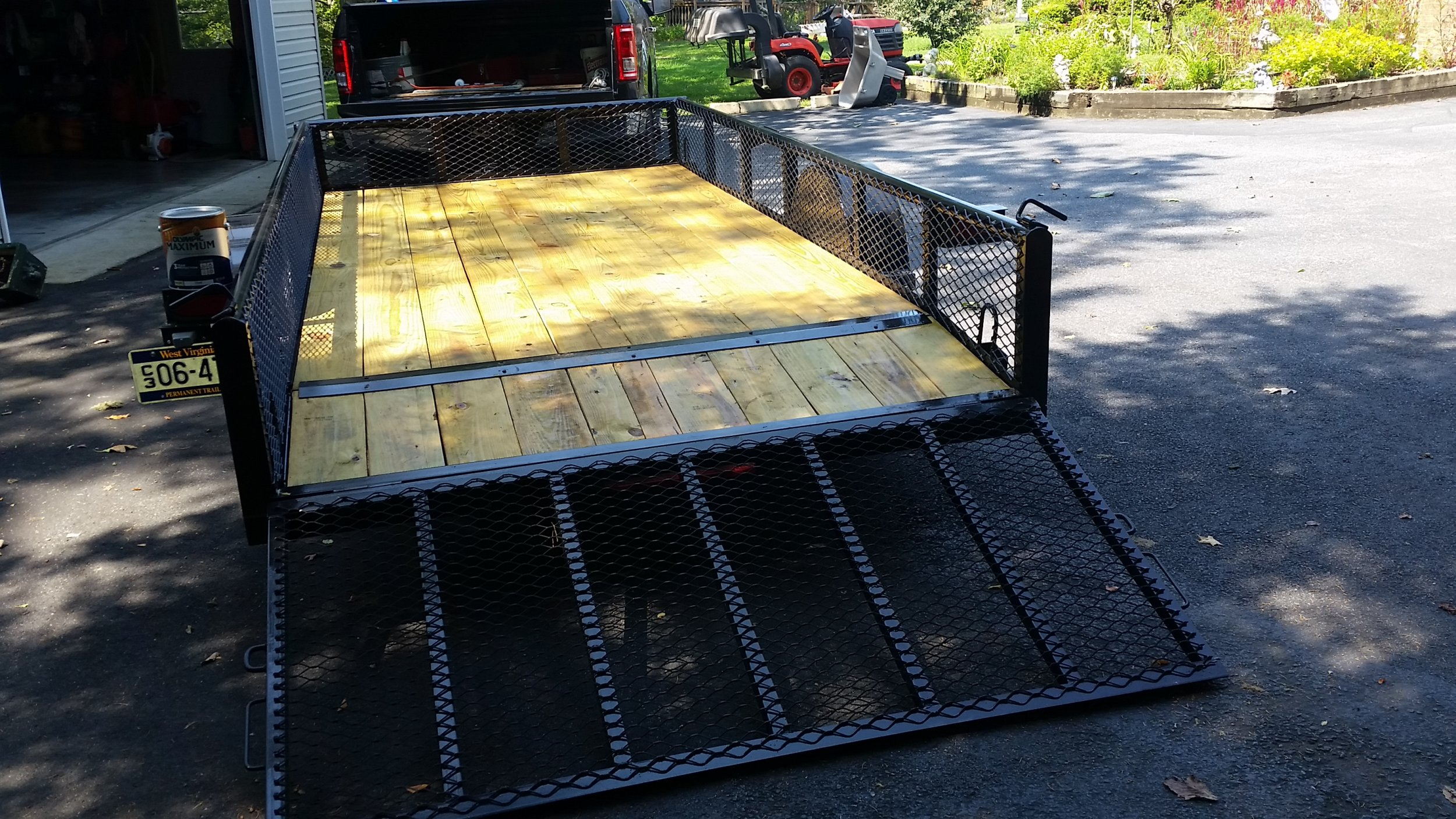

For example my Stagecoach brand has an upgrade stronger axle, stronger than std tires, 78" wide bed, small amount of beavertail which helps a huge amount when loading AND makes the tailgate much shorter and easier to lift without springs. It would very easily handle your loads that we know about. It cost me a hair over $2000 via dealer in Bossier City LA 4 years ago. See Utility Trailers For Sale New & Used | Topps Trailer Sales in LA dealer website in Bossier City. I do not know where all Stagecoach has dealers but they are made in TX, are VERY well made and durable. The mfr is super receptive to doing mods and custom stuff to suit you at not exorbitant prices.
The top rim frame is heavy 2"+ size pipe, a lot stronger than thin angle iron. I've owned both.
I added mesh sides, extra post holder slots, a spare tire holder, etc.
