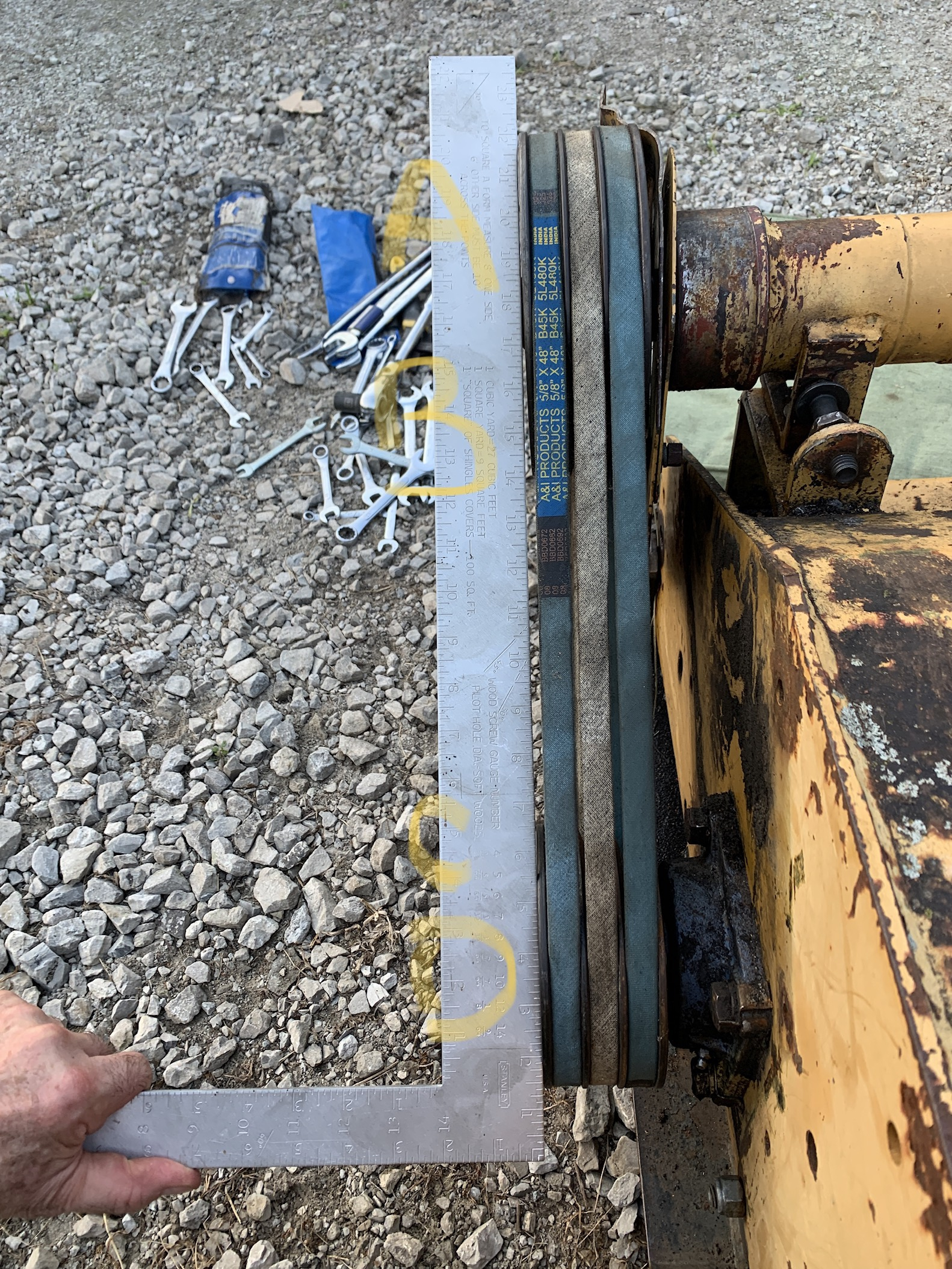

So I’ve got it all together but when I put a straight edge on these two pulleys there’s a slight gap on the top pulley. What would be the way to straighten this out if it’s even necessary. I’ve messed around with the jam bolts
but it doesn’t seem to do much.

how about the alignment issue? how critical is that. I mean they are “pretty straight” and mower seems to run smooth. But do I risk ruining the bearing if it’s 2 mm off??
   / Any Ford 918H owners? #27
The gearbox needs to go toward the back of the mower while the pulley end needs to go toward the front. It will get straight, just takes some playing with to get there and keep the tension right.

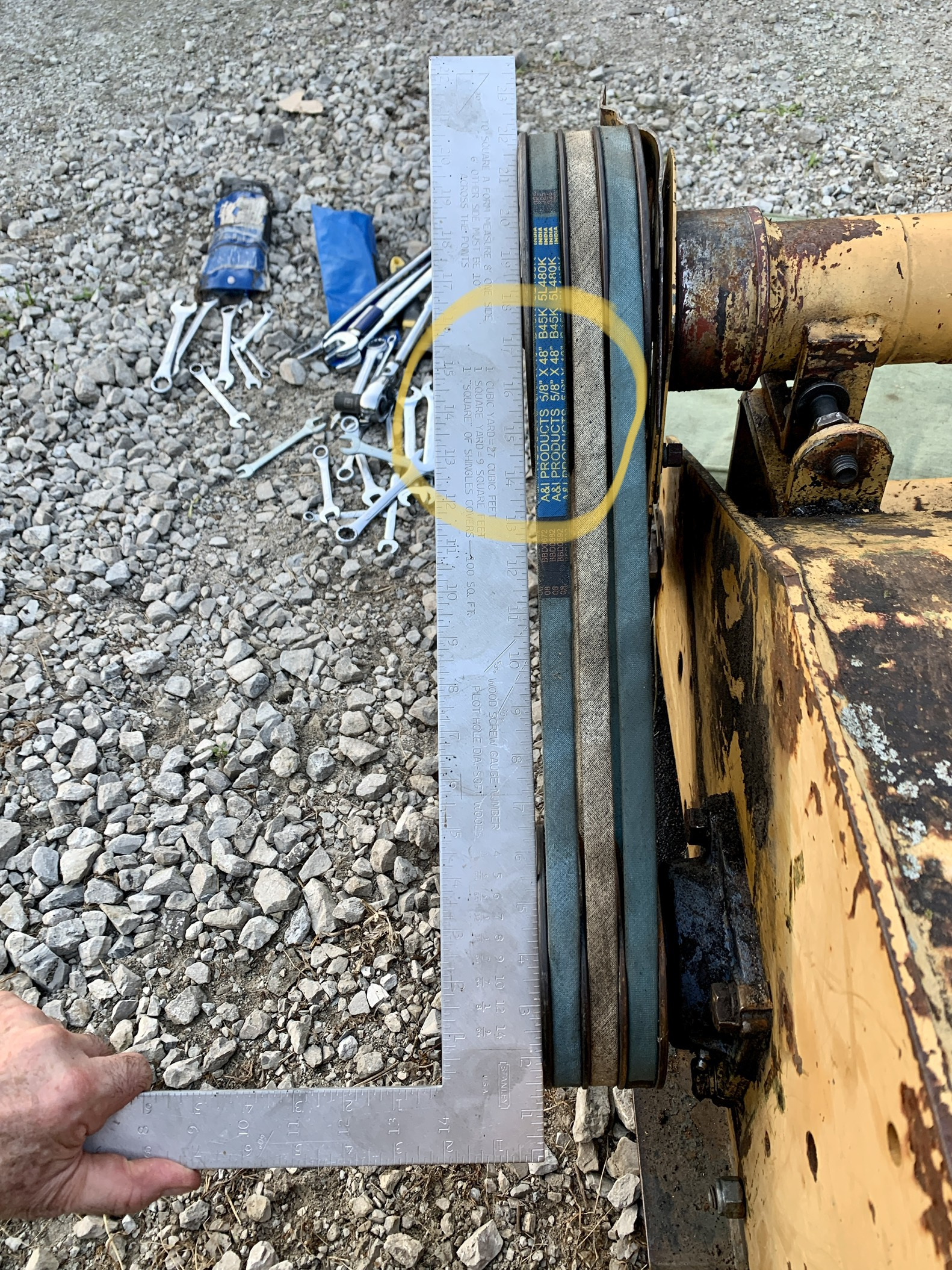

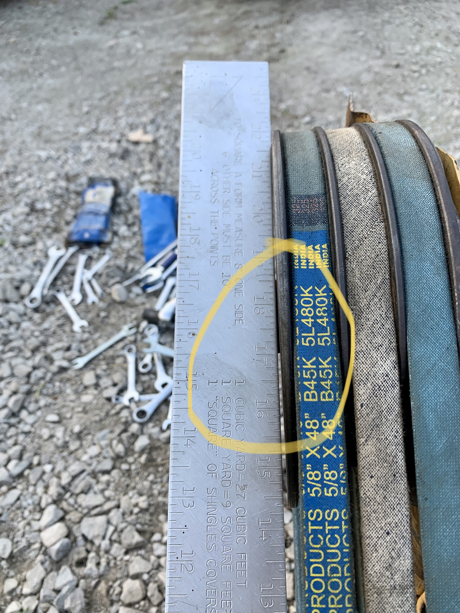

   / Any Ford 918H owners? #28
So originally I could put a straight edge and line up points A CD. But that obviously meant that the top pulley was canted in a little bit. And that was generating way too much heat when I ran it. I can’t get all 4 points aligned. The best I can do is get AB perfectly parallel to CD but that leaves the drive shaft pulley about 3/16 inch inward (to the right) compared to the lower pulley. The jam bolts just allow movement forward and back, not left and right. I don’t see how it’s possible to move that top pulley out toward the left and keep it parallel.
   / Any Ford 918H owners? #29
I would add shims under the pulley end to eliminate or reduce the cant of the pulley. Lastly you can add some shims between the extension tube and gearbox if you need the pulley more to the left after you have figured what is needed to get the cant out of it.
   / Any Ford 918H owners? #30
How hot would you normally expect the pulley to get after running it for about 20 minutes? I’m getting a reading of about 195F. That seems pretty hot but I’ve got no reference point on this. I’m assuming the geometry of the pulleys must have been like this before I put on the new belts so seems like I must’ve been running the mower like this for years. I do notice that the pulleys are held on by hex bolts. Would adjusting the position of the pulleys on the shaft make more sense than using shims?
