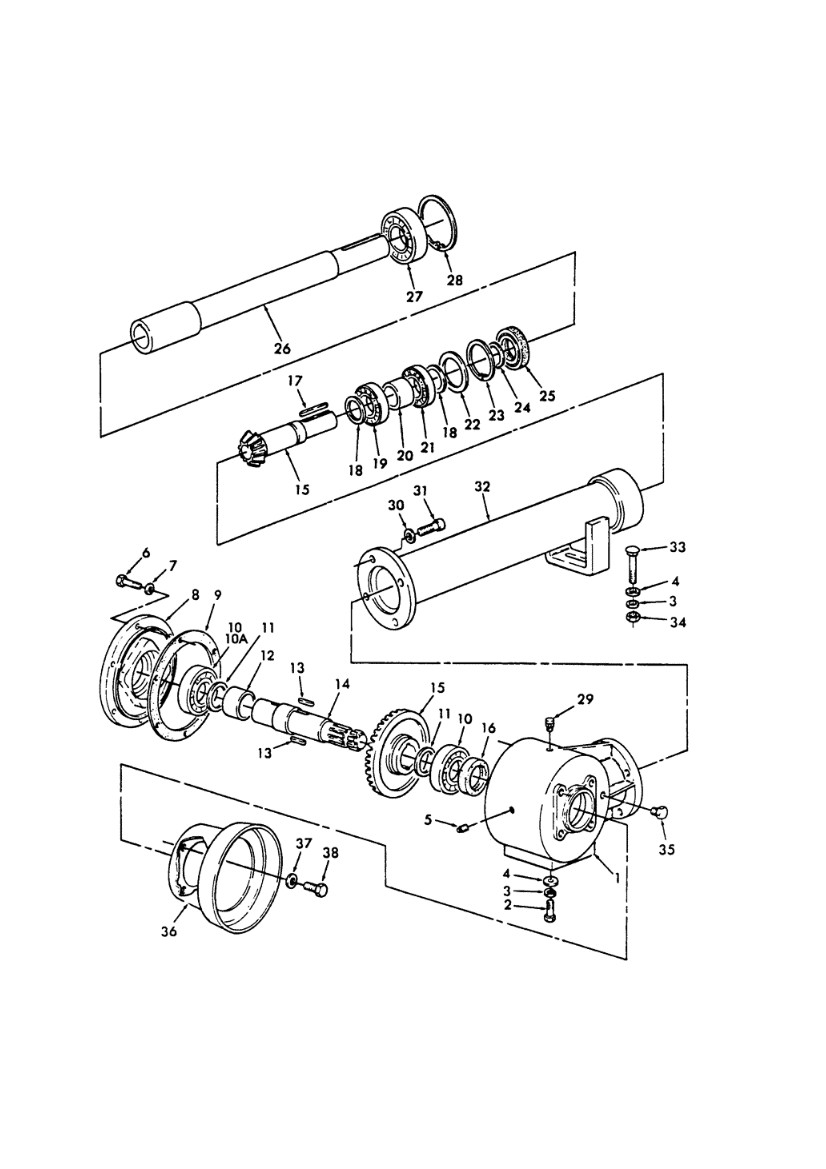

Have a Ford 918H that I picked up at a good price. I have searched every document/ forum I could find for info on this specific mower. I did find a spec sheet that said it could be set to run in forward or reverse rotation but can not figure out how that would be done. Anyone with an owners manual or experience with a 918H that could educate me? I've found the owners manual online but I hate to drop $40-$50 just to find out if it can be reversed. Any info would be greatly appreciated.
/ Any Ford 918H owners? #2
I was going to scan the page from the manual for you but my scanner has decided it's toast but the long and short of changing direction of rotation is swapping the drive gear on the input shaft. Here it is word for word from the manual:
1. Remove the drain plug and drain the oil
2. Remove the bolts (6) securing the rear gearbox cover (1) and the side shaft support. Tap on the input shaft to loosen the cover. Disengage the side shaft.
3. Pry the rear cover and bearing off the input shaft (14).
4. Remover the input shaft from the gearbox.
5. Remover the gear (15), shim (11), and keys (13) from the shaft. Remove the spacer (12) and shims (11) from the other end of the shaft.
6. Install the gear with the keys and the shim to the end of the shaft that the spacer was removed from. Install the spacer and shims to the opposite end of the shaft.
7. Install the cover and the side shaft support setting the gear properly. Check the gearbox backlash with a dial indicator. The backlash must be from 0.008" - 0.0014". If the backlash is not to specification, re-arrange the shims. Replace the old gaskets.
8. Install the drain plug. Fill the gearbox with 3 pints of gear oil.

Thanks John. I had looked at the parts schematic and it almost looked like swapping the gear and spacer around might work but I hoped to hear for sure from someone who knew. I will go ahead and download the service manual, found it for $30 finally, and get it running the other direction. Thanks for taking the time to help me out.

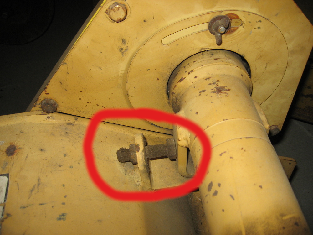

I’ve got one of these Mowers also. I have to replace the belts. Can’t figure out how to release the tension between the pulleys to let the belts slip on. Any help??
/ Any Ford 918H owners? #9
Not a Ford flail but I bet typically, for me to change belts (2 B-size) I just to remove four bolts holding the lateral shaft's bearing mount at the top and push it down by hand to make slack. The holes are slotted for adjustment when I put bolts back in. If a bit stiff I'd loosen the bolts holding the gearbox but haven't had to do that yet.
btw, my mower specs 69 1/2" belts, rare and not at TSC .. but I can get 69"s and 70"s to work easily within the adjustment range. Costs ~1/2 as much and 3 stores within 10-20 min if I catch a few lights.
/ Any Ford 918H owners? #10

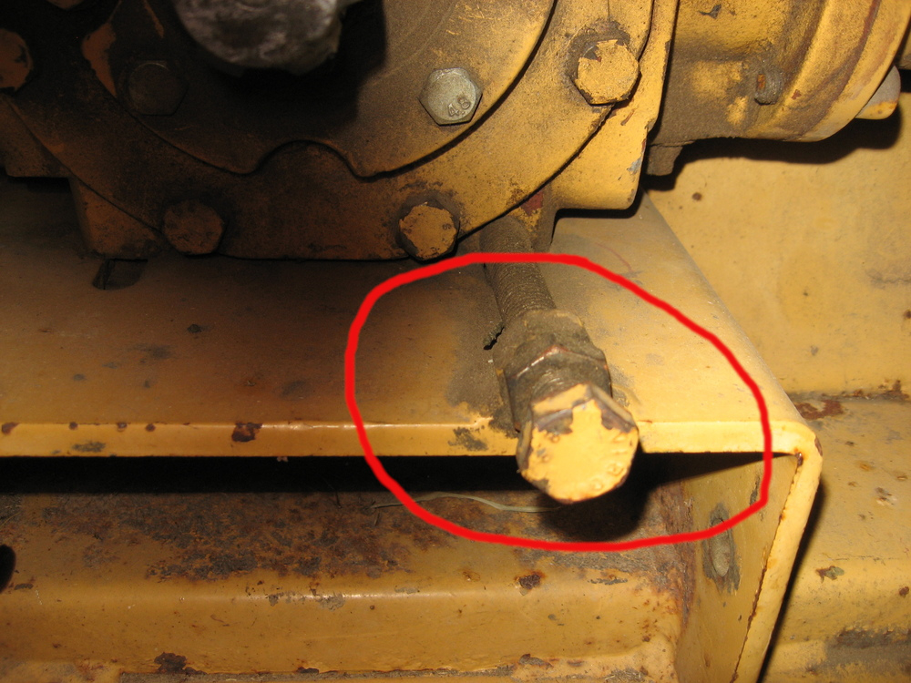

To loosen the belts first you loosen the 4 bolts holding the gearbox and back off the push bolt, then loosen the two bolts holding the pulley end and back off the push bolt on that end and then you can slide it back enough to get the slack you need to remove or replace the belts. To tighten just reverse the process trying to keep the pulleys straight with each other and not canted.

/ Any Ford 918H owners? #11
Could you post a picture of the 4 bolts holding the gear box? Also the push bolt on the pulley side is broken and I can’t turn the threaded piece that’s still there. Any suggestions?
/ Any Ford 918H owners? #12
Time to apply the blue wrench? Looks like the OEM bolt froze and snapped off when trying to get it freed up. I've had 'em budge after cooling when they didn't seem to while still hot, roasted 'em good either way. Gear box bolts look to be accessed from the bottom. btw, nice pics, guys. (y)
/ Any Ford 918H owners? #13
Penetrating oil and a small hammer will work on the bolt. Spray it and let it soak for awhile then start tapping it with the hammer while gently trying to turn it with vise grips or small pipe wrench. Keep soaking and tapping until it begins to move, it will take time so don't expect it to happen in the 5 minutes. Once it starts to move keep spraying and rocking it back and forth until you get it out.

The bolts for the gearbox are right under it.

Thanks a million. You’ve been extremely helpful!! Just hope those gear box bolts aren’t frozen🙈 will let you know when I can get around to trying them. By the way why do you say use heat as a last resort?
/ Any Ford 918H owners? #15
I mentioned heat, but only on the adjustment bolt/tab & not on the gearbox bolts. Sorry for any confusion. Kroil, Free All, Gibbs, Liquid Wrench NOT std WD-40 to loosen rust can be easier to use but 50/50 ATF & acetone still rules. All might need time to soak and reapplications can be every few hours.
tip: if you use 50/50 apply pure acetone every other time or so. (chip brush etc not poly) ATF will remain after the solvent evaporates out. The ratio once applied will favor ATF and lose its wicking ability to full depth, as in more acetone should suck into the oil vs be diluted/shared from more 50/50 mix. As I use up a small batch for a farm or machine job, say 2-4 oz (tall glass olive jar < 1/2 way, tiny drinking water bottle <1/2 way, etc) I just add a bit more acetone as I use it up.
btw: PO seems to have tried Vise-Grips on the broken adjuster bolt and failed. Bet it wasn't hot, can't tell if he knew not to loosen rusty chit 'dry'. I'd soak for a day or two if I had time (all bolts mentioned from all sides), maybe heat the adjuster if I didn't. Also, and from experience I wouldn't expect to have to loosen the gearbox bolts to change a belt set.
So say you let the bearing shield loose for now and see if you don't have easily and workably 1" - 1 1/2" of 'wiggle room' with mere hand pressure as I did. We need maybe 1/2-3/4" of it to get a belt off. And yeah, we do put 'em on one 'position' at a time and walk 'em over one groove to the next. (You knew that) Tell us when you get to the hard part. :)
/ Any Ford 918H owners? #16
As said soak it and tap it with a hammer the vibrations will help to get the oil to penetrate along the threads. I have removed many frozen bolts and pins by doing this. It is slow and can take days, I prefer to leave heat until the ultimate last thing when working around bearings and seals. I have seen to many people use a little heat, then a little bit more and a little bit more, then end up replacing seals that start leaking from being cooked.
/ Any Ford 918H owners? #17
So I’ve been soaking that bolt for a couple days. Really not making any progress. I did flatten it with a Dremel on both sides to try to turn it. But I just started twisting the bolt. Any reason not to just forget the lubricant and just try to drill it out. What’s the negative of that.
