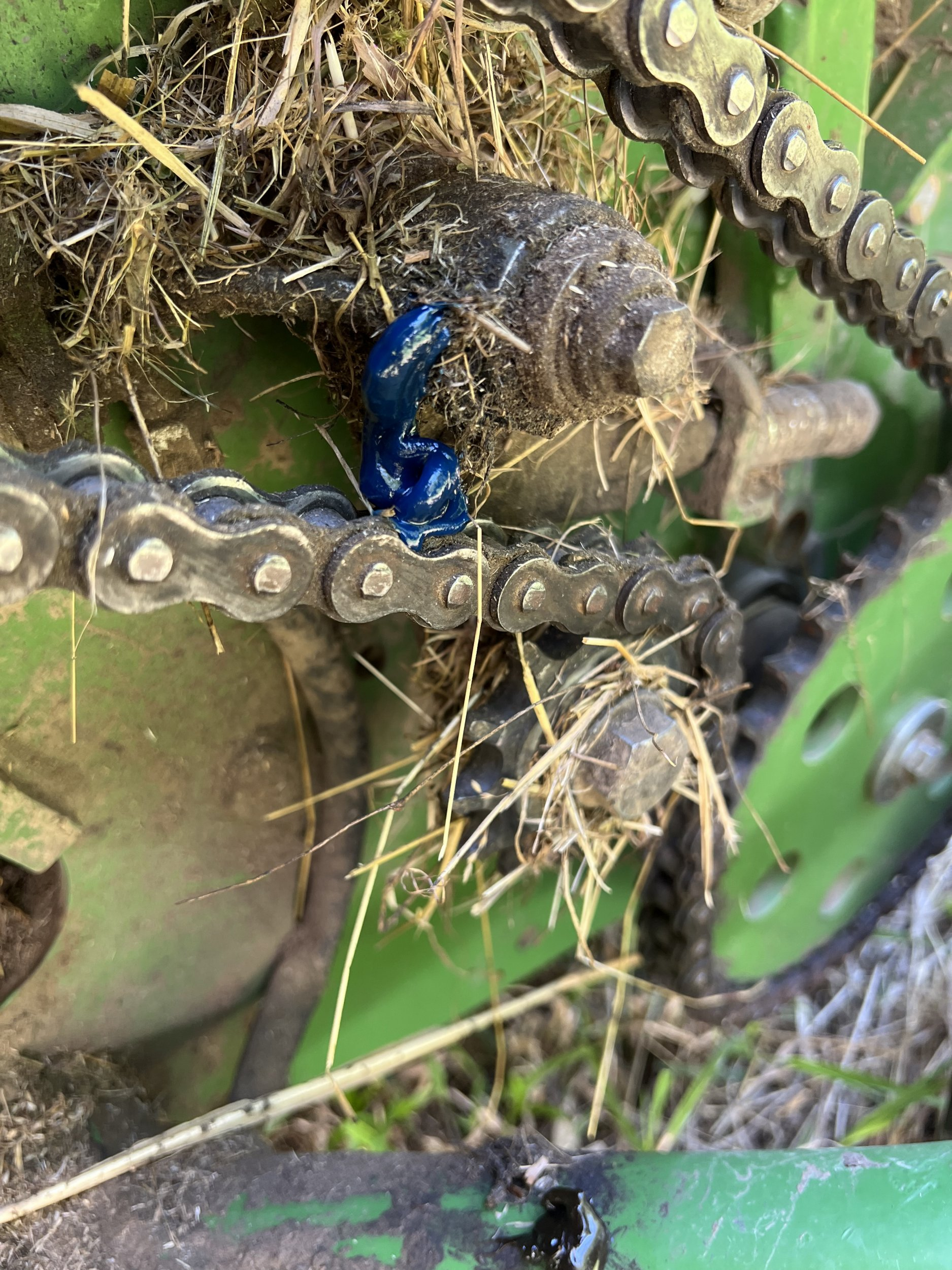

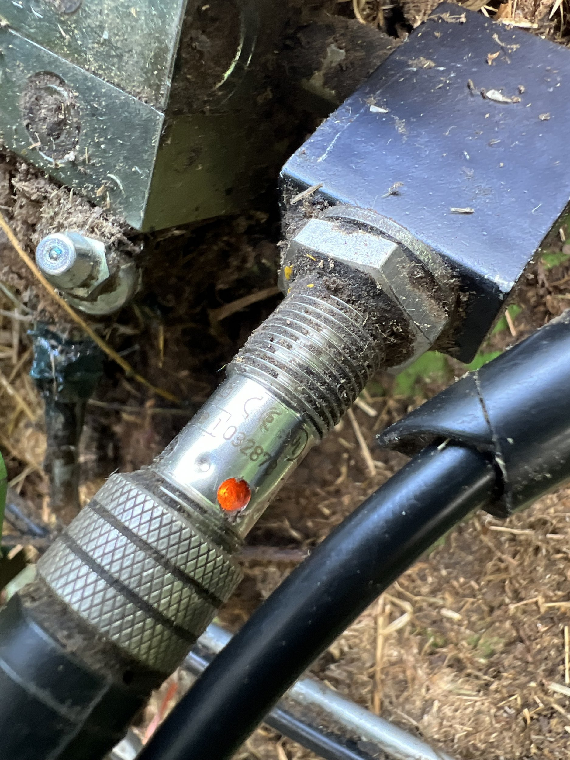

Ran baler 2 hours on 7/10, 6 hours on 7/11 and 2 hours on 7/12. Everything seems to be ok. Up at the “splitter” (it’s like a valve body with 50 lines coming off of it) there is a small sensor with a light that comes on/off every 10 seconds. The light is functioning normally.
The monitor in the cab shows normal function, but I don’t fully trust it. Itprobably gets it’s signal from the sensor shown above.
I DO see grease coming from several fittings.
It‘s about all I have to go with as removing every line is not an option.
