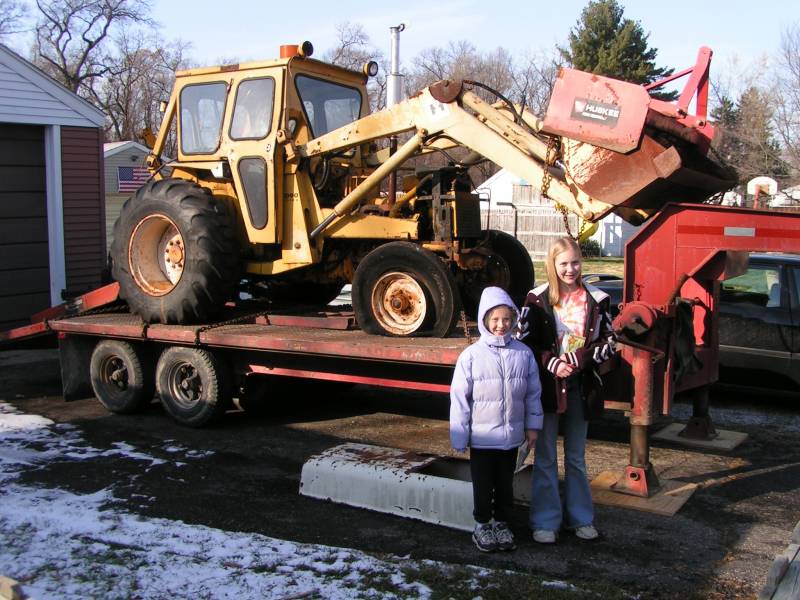

I had one in my late 70's IH2500B. It was an industrial tractor/loader with dedicated FEL and 3pt hitch on the back. It was a four cylinder gas engine with 50PTO HP. You were supposed to operate it at full throttle, according to the manual. Very fun loader to operate. Rarely used the brakes, except for tight turns and working close to something expensive, like a dumptruck or house. :) As I said in a previous post, the HST tranny outlasted most of the rest of the tractor. ;)
