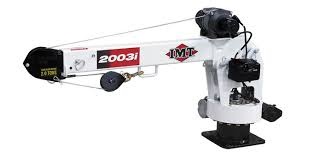

perhaps you should look at an old boom truck for the base ( auction at a tree trimming yard or crane place ) ... one that is bagged out ( bad motor/trans / etc )
/ Any body built a knuckleboom loader #8
image.jpgThe slew gear from a small mechanics crane off a service truck would be a nice starting point.

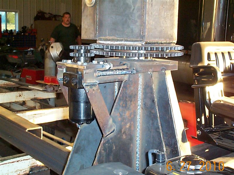

for the base, use some kind of pivot big spindle or pipe on pipe, and use a large sprocket and a roller chain with hydraulic cylinders, to pull it one could get a little more than 360 degrees. or a cable.
or a roller chain on a pivot point, driven by a hydraulic motor,
a hydraulic motor ad a large differential or gear box,

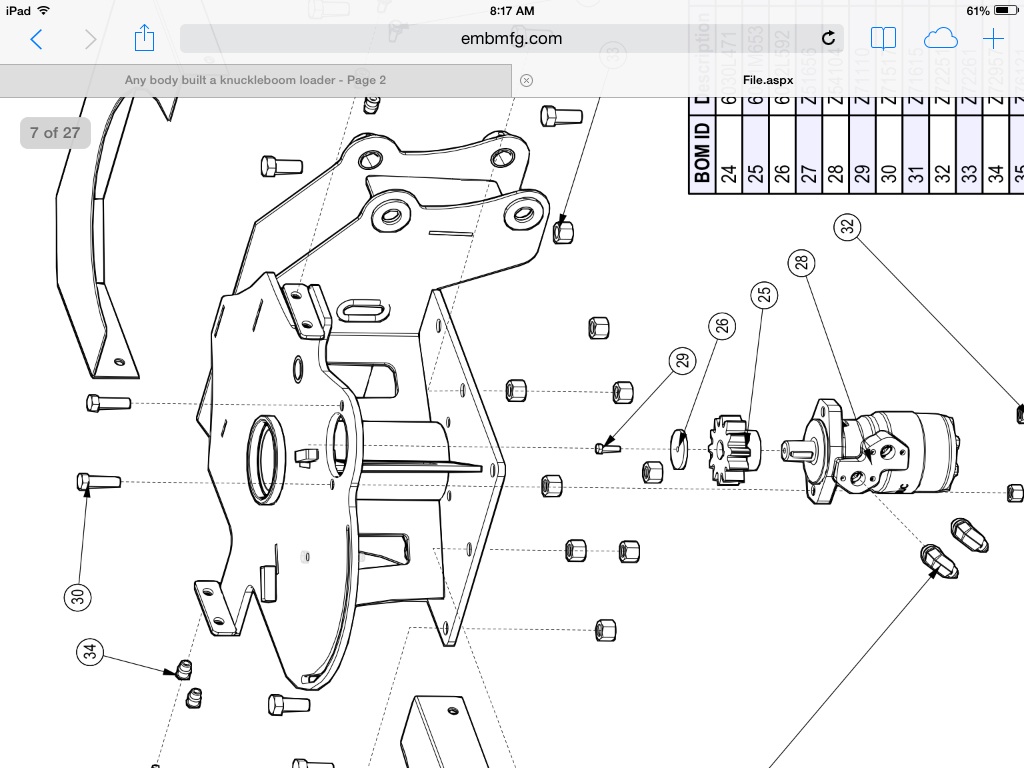

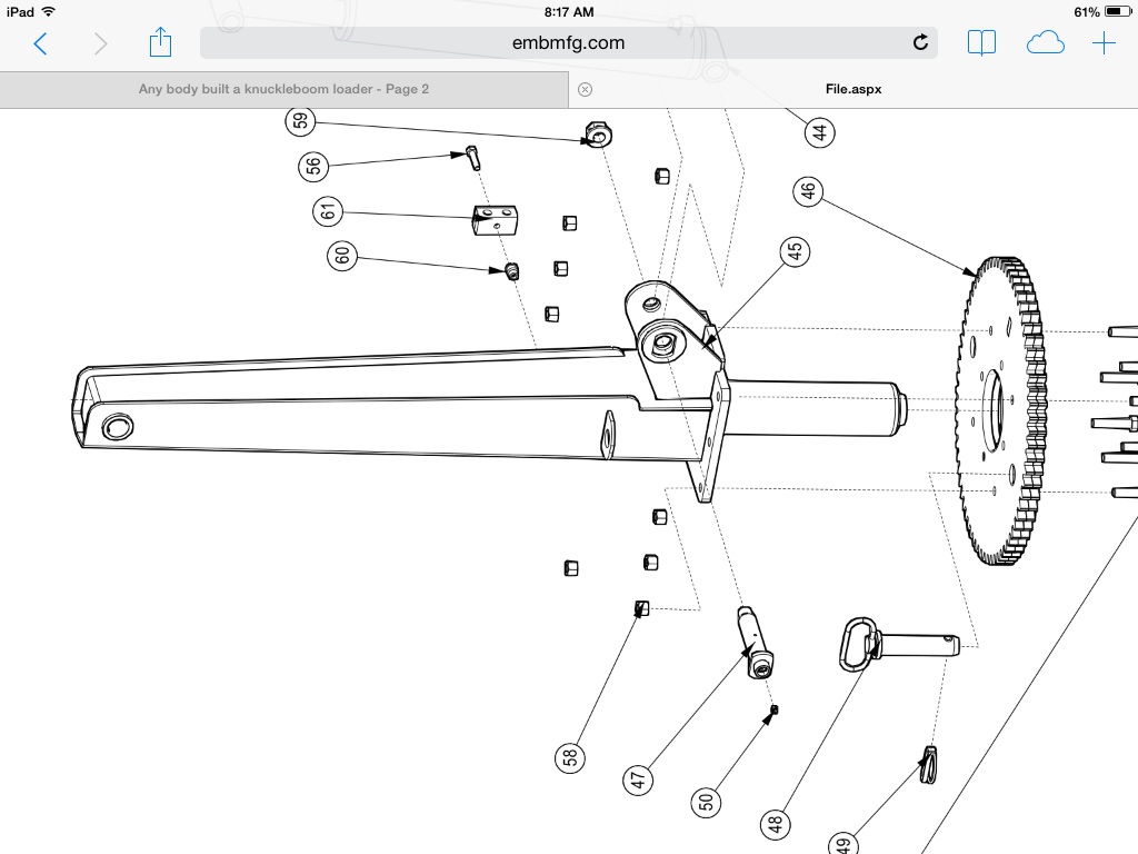

BHD, that is what I am looking for. I need some info as to the gearing of the swing, I'll have to do a little math Ouch!. but all those pictures really helps.
I had the ideal of using the backhoe for the swing. everything was there, I just needed to lighten the load. I like the design of the log loader trailers, but not the price tag. Building something similar to the log loader trailers is what I have in mind. The knuckle boom will be mounted on trailer, but it will be part of a firewood processor and used to load logs onto the processor. I have looked for Mechanic cranes, but just not any around here, or at least not anything I can rob parts off of.

I also like the sprocket/chain idea. Get a large (like 12") sprocket and cut out square or round hole to fit on whatever mast you are using and drive with hydraulic motor. I would even consider mounting it below the pivot hub, though it doesn't matter much either way.

There are a ton of atv log loaders on alibaba. They almost all look to use the same base design of a rotary actuator and some sort of slew/ring bearing. They must have a cheap source...
#18
Thanks Mike, I see that the support shaft on that loader is 3in dia. Looking at the specs for the loader, it is only rated for 900lbs. Not big enough for what I need, but the drawings can be adapted and scaled up.
