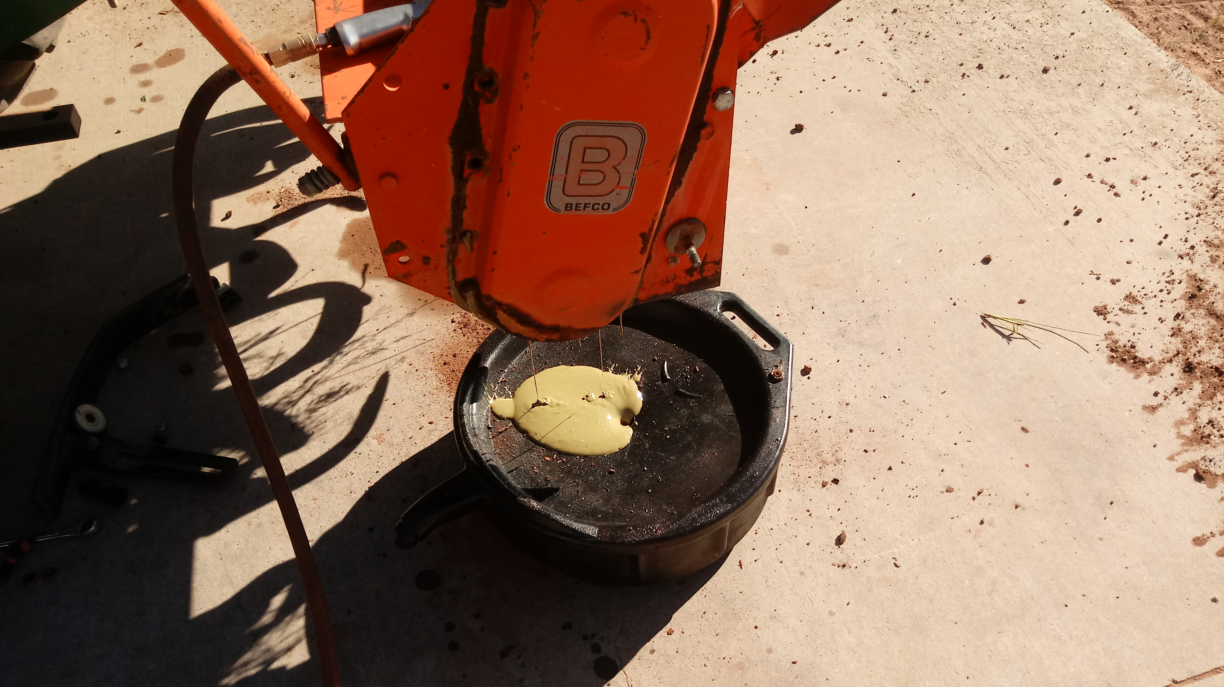

I just bought a used Befco 11-250-23x tiller. I would like to change oil in the gearboxes but I don't see a drain plug or level plug anywhere...what are they thinking? What do you guys do? I do have a seal seeping on the output shaft of the pto gear box so I can empty the oil when I change it but how much to refill it? I guess on the chain box I need to pull the cover off? Then again, how much to fill it? They both have a fill plug/breather to fill with but no level plug.
I guess I can turn it upside-down, hang it from my loader and drain from the fill/breather plug. So much for USA made....

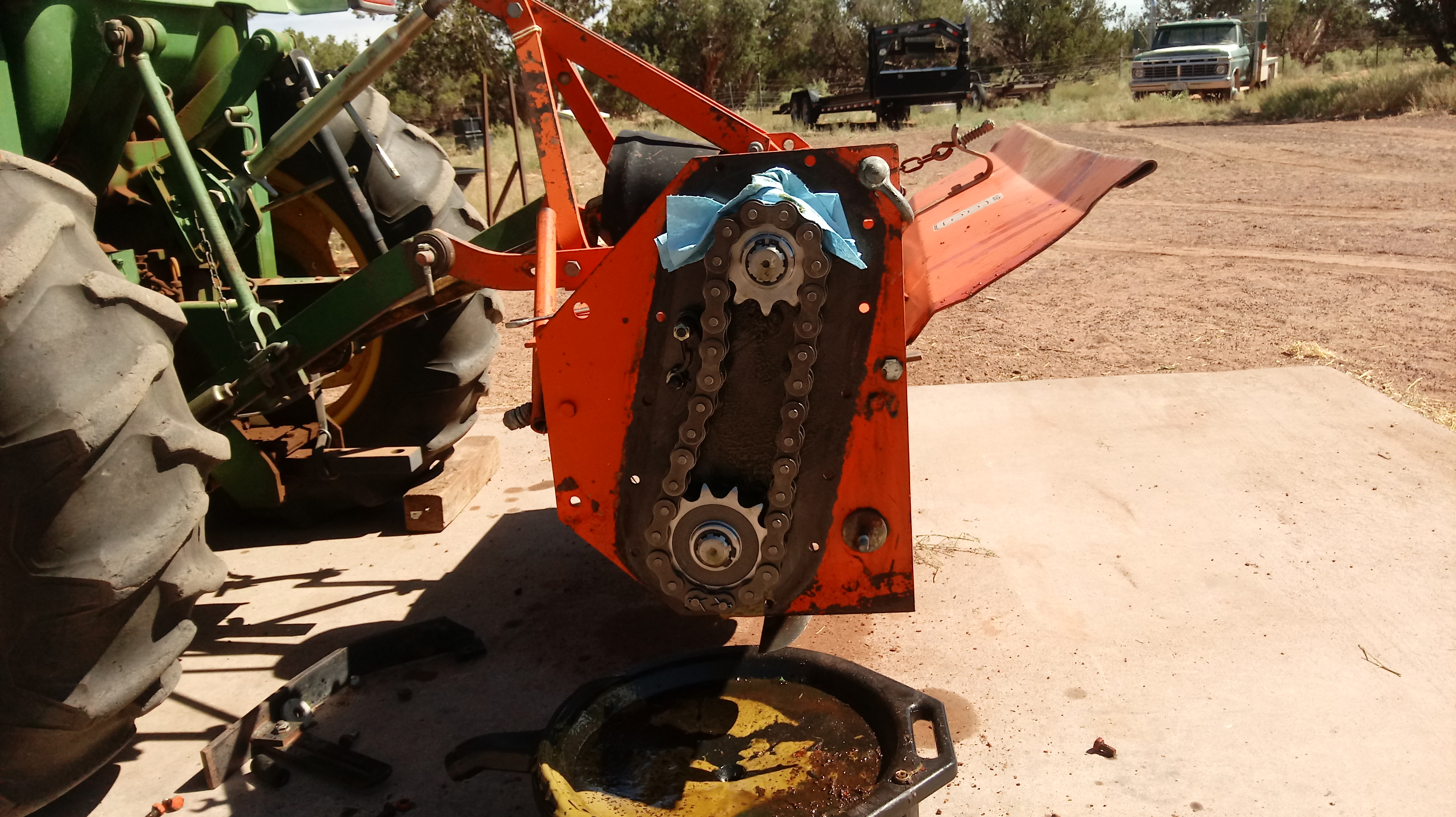

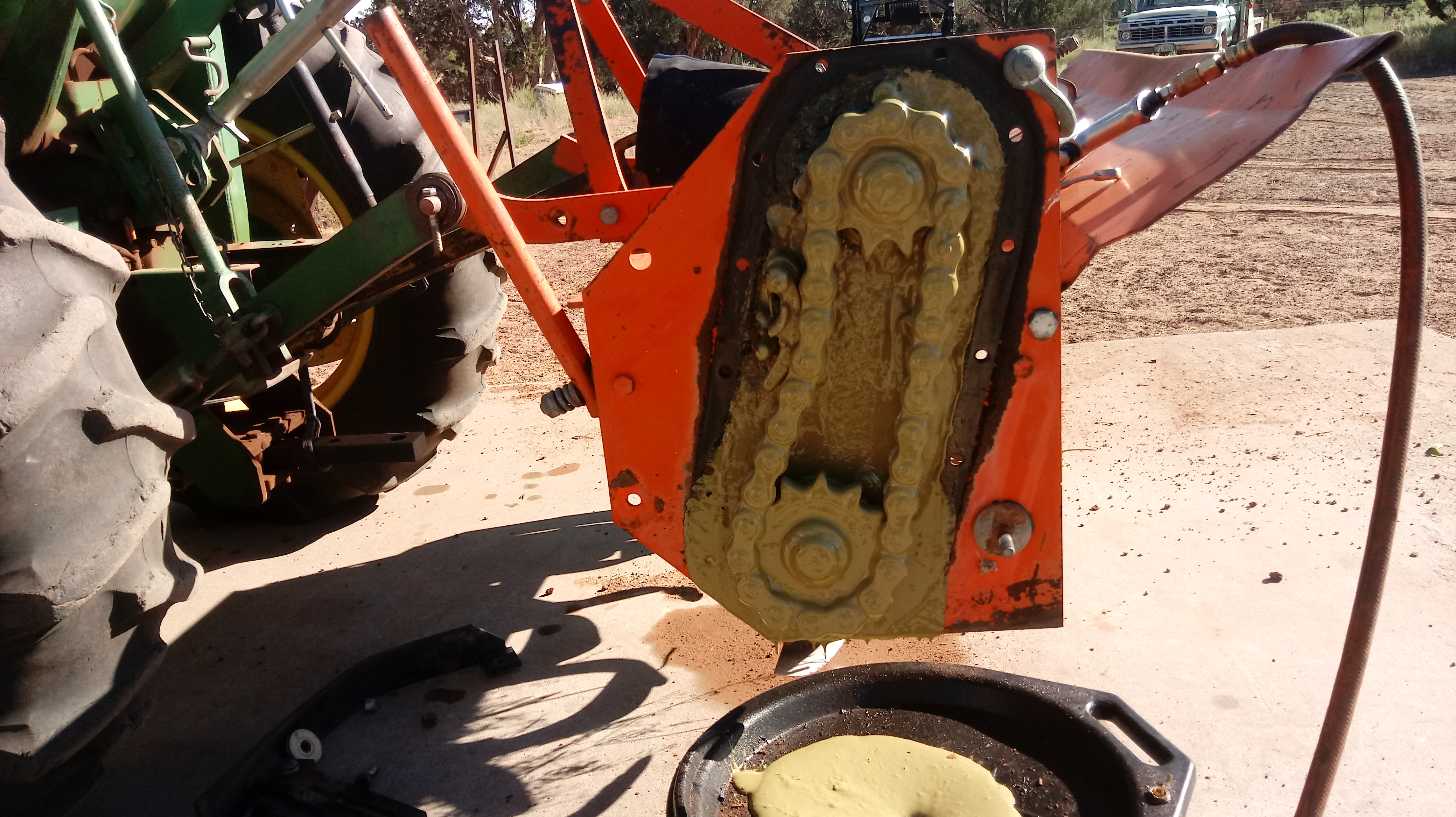

I don't have any books. I checked with two places that sell parts but no books. I called the factory and the parts guys said to take the pto box off and drain it then fill to halfway up the pinion. The chain box you have to take the cover off and fill with 2.5# of grease. They did away with gear oil now. I elected to refill with 85/140. Grease is a pain if you have to go back in and work on something. Note the nasty chain case oil. You can bet if a gear box has been stored outside it will look like this every time. The top sprocket is 10t with 13t on the bottom. You can switch them if you want more rotor speed.

If you're going to put anything other than grease on that chain I think I would weld a 3/4" bung onto the cover. That way you'll be able to check the level. If water got into it then I would expect the oil to leak out of it.

The bung would have been an excellent idea but maybe next time. I have it all buttoned up. I didn't think of that at all, I was just mad because the factory didn't.:) I still don't know what the normal fill level is so I just added a quart and called it good.
Water can get in a one way seal easy, yet the oil can't get out because that is the seals design. The input shaft seal on the chain case is damp but the output/rotor shaft seal is dry. The two output shafts on the pto gear box are wet but the input/pinion is dry. I will probably need to reseal it some day. It works really well.
Next is the pto gear box. Since I have to remove it to change oil I think I will get the two output seals first and change them while the box is off. I think the main reason they are wet is because both boxes were overfilled with the water in there.

The Flowing Grease is EP-00. It is also called Cornhead Grease or Cotton Spindle Grease. Tractor supply has the EP-00 grease # 105682899. Drain the oil out and use this product.

Pretty sure the oil level should be just below the lower sprocket shaft. The chain only has to dip into the reservoir to keep it oiled as it goes around. It's easy to overfill a chain-case thinking 'more is better'.
My geared tiller is hardly different, doesn't take a whole quart, and the 'drain hole' is also a level hole on the side of the cover vs at the bottom.
