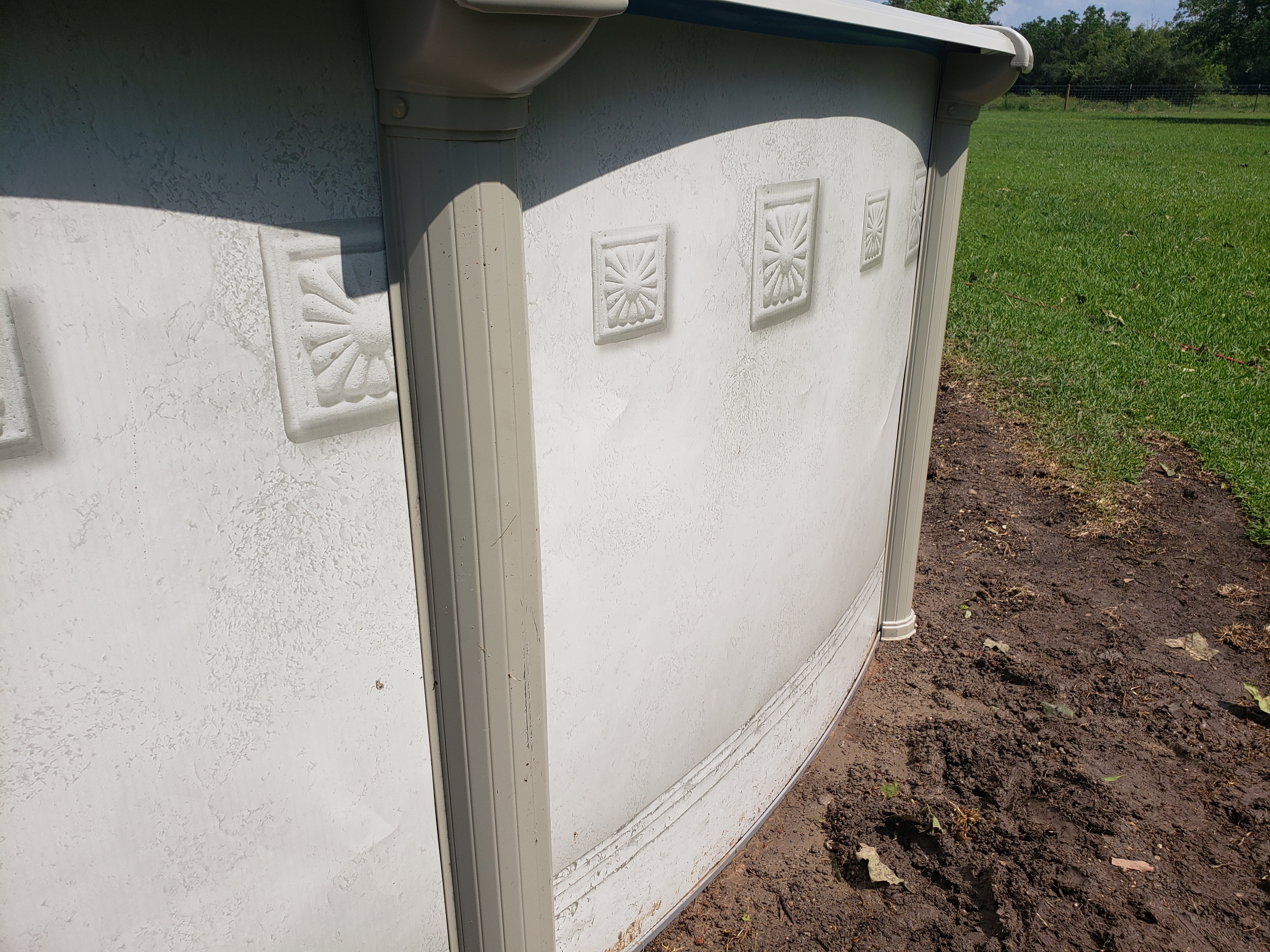

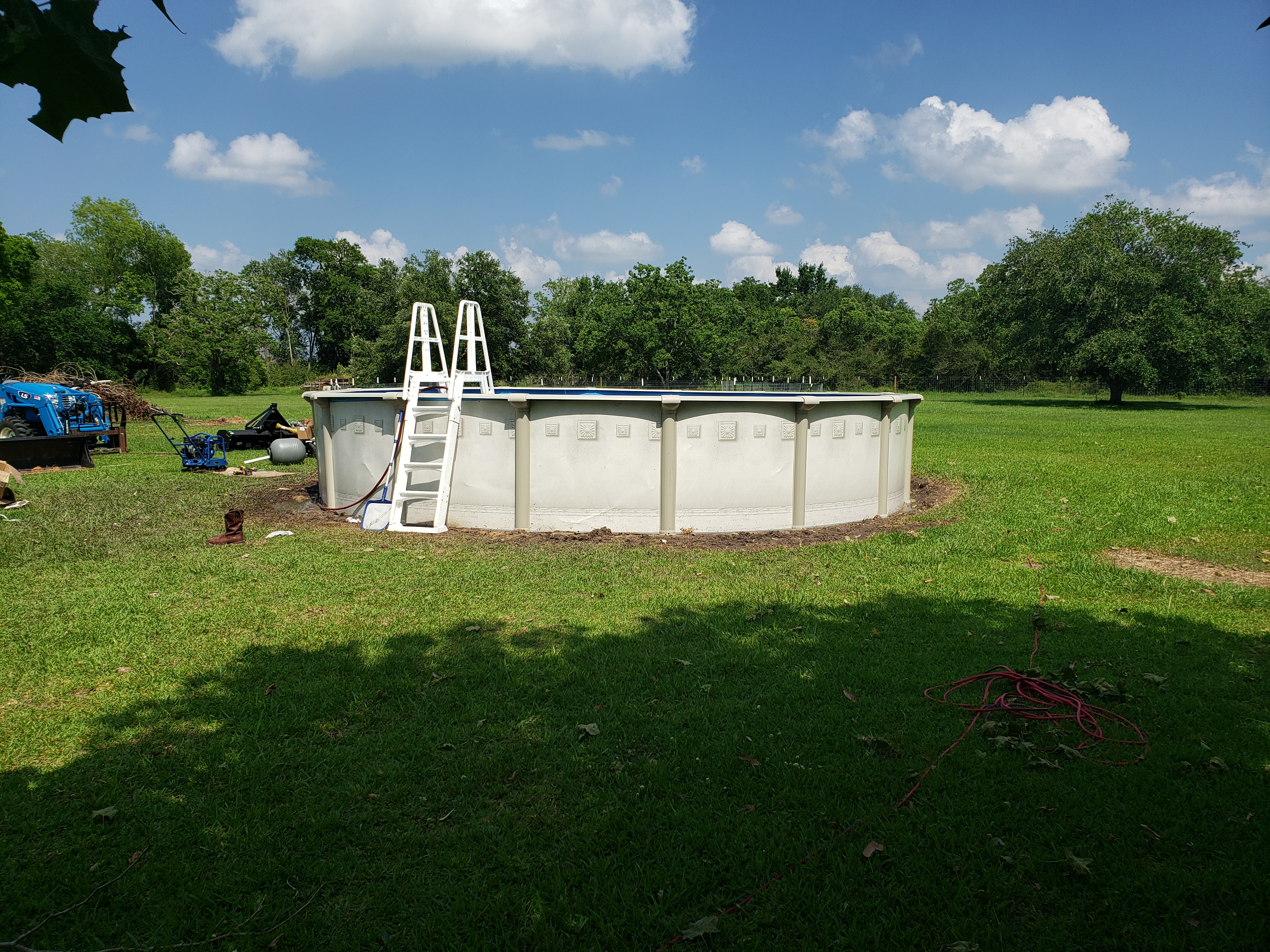

Thank you for the encouragement. I was able to salvage the pool. There are no wrinkles in the liner bottom; I made sure of that as it was filling with rain water the other day. All the wrinkles are in the steel wall, painfully conspicuous and all along the side most visible from the direction everyone will be looking at it. The pool will wear these battle scars with pride.
When I referred to sand having been laid, I wasn't even considering sand being in the groove of the track to be much of a problem. It was, I painstakingly dug it out with a nail. I was thinking of the 4+ inches sand, with the new weight of water on top of it and no wall to contain it, pushing the track outward and creating a circle larger than the circle of the pool wall. And the difficulty of shrinking the track circle back into spec with sand behind it and water on top of the sand. That also proved to be a real problem. The track moved outward along 1/4 of the circumference of the circle, by 2" at the worst part. I was afraid it would be impossible to fix. I envisioned a scenario where everything I try to do just causes a disturbance which forces more sand down and outward, pushing the track even farther from the intended position.
But it wasn't impossible, just difficult. Tools were thrown, curses were uttered, children and yard birds were frightened. I gave up more than once but kept coming back. One little bit at a time, I excavated dirt and sand by fingers, and gingerly shoved the track back under the steel wall. Pulling the wall back down into the track was difficult as well, as it wanted to buckle everywhere there was a wrinkle.
Eventually got it all back together. And then picked up where I left off with the assembly. Now with the uprights and top rails installed, and another 12" of water in it, I'm hopeful that it's "safe" now and can't be further molested by wind.

Can’t wait to see the deck!

Looking better! :thumbsup:
Did you put blocks under each vertical?

How did you know? Haha.
I wanted the deck on the side facing the house. My wife wanted it on the far side. Now that this damage is so obvious from the house I think she will agree with me. The deck would hide it.

No. I watched some videos on pool installation while shopping for pools. Some showed using blocks, others didn't. One websites I read, said that putting blocks under the uprights is a common cause of liners getting ripped. I downloaded the pool assembly instructions while waiting on pool deliver and it said to use blocks, so I had the blocks waiting when the pool arrived. The instructions in the box were different than what I had downloaded. They made no mention of blocks. So I didn't use the blocks I had bought. Until I had to excavate the supporting dirt under a section of track to get it pushed back where it was supposed to go after the high winds. I didn't think shoving mud under the track would be sufficient, so I shoved blocks under that section of track. But none under the uprights.

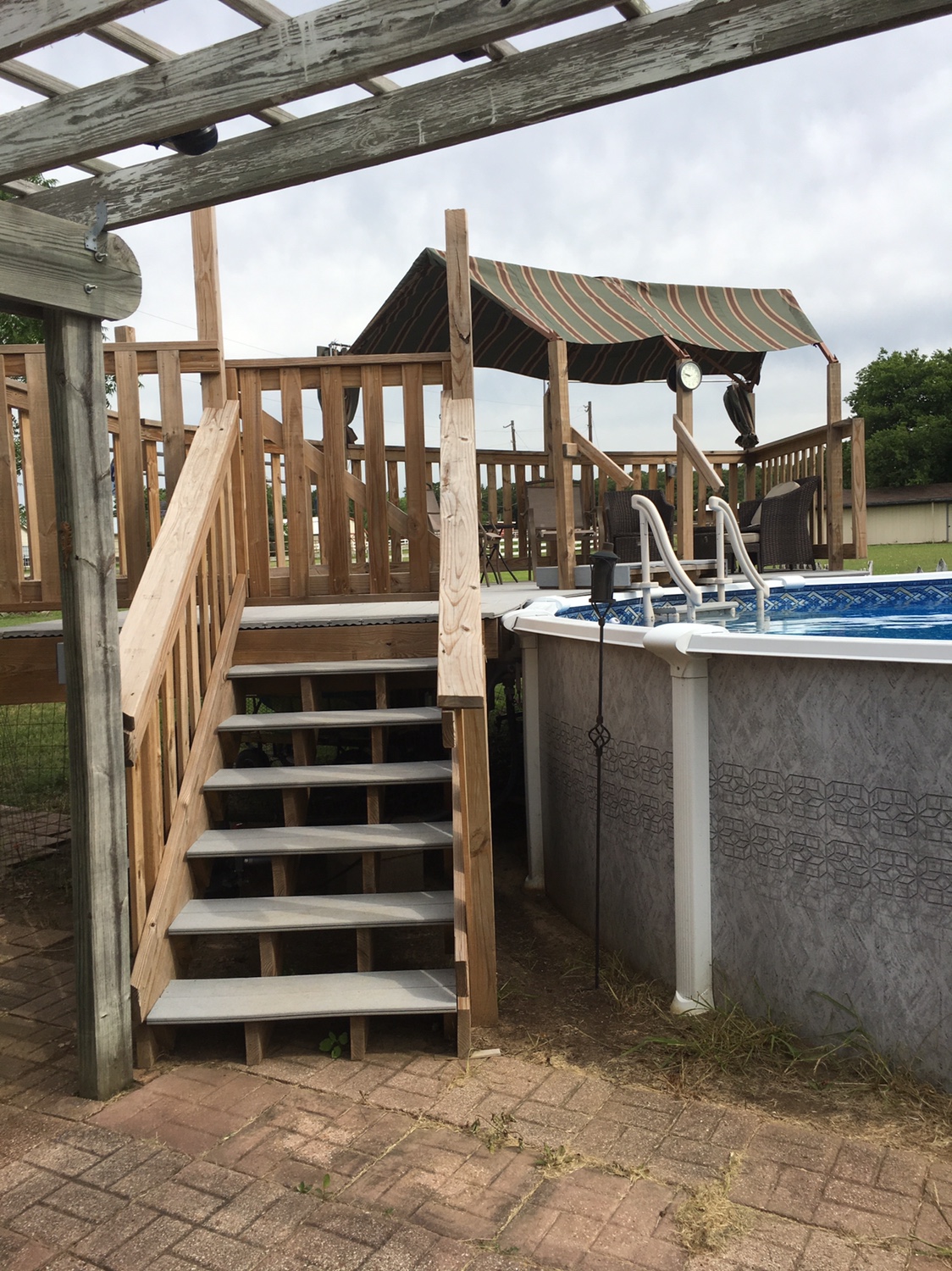

I know because after one season of climbing up and over a ladder my wife made an “executive decision “ that “we” needed a deck.
