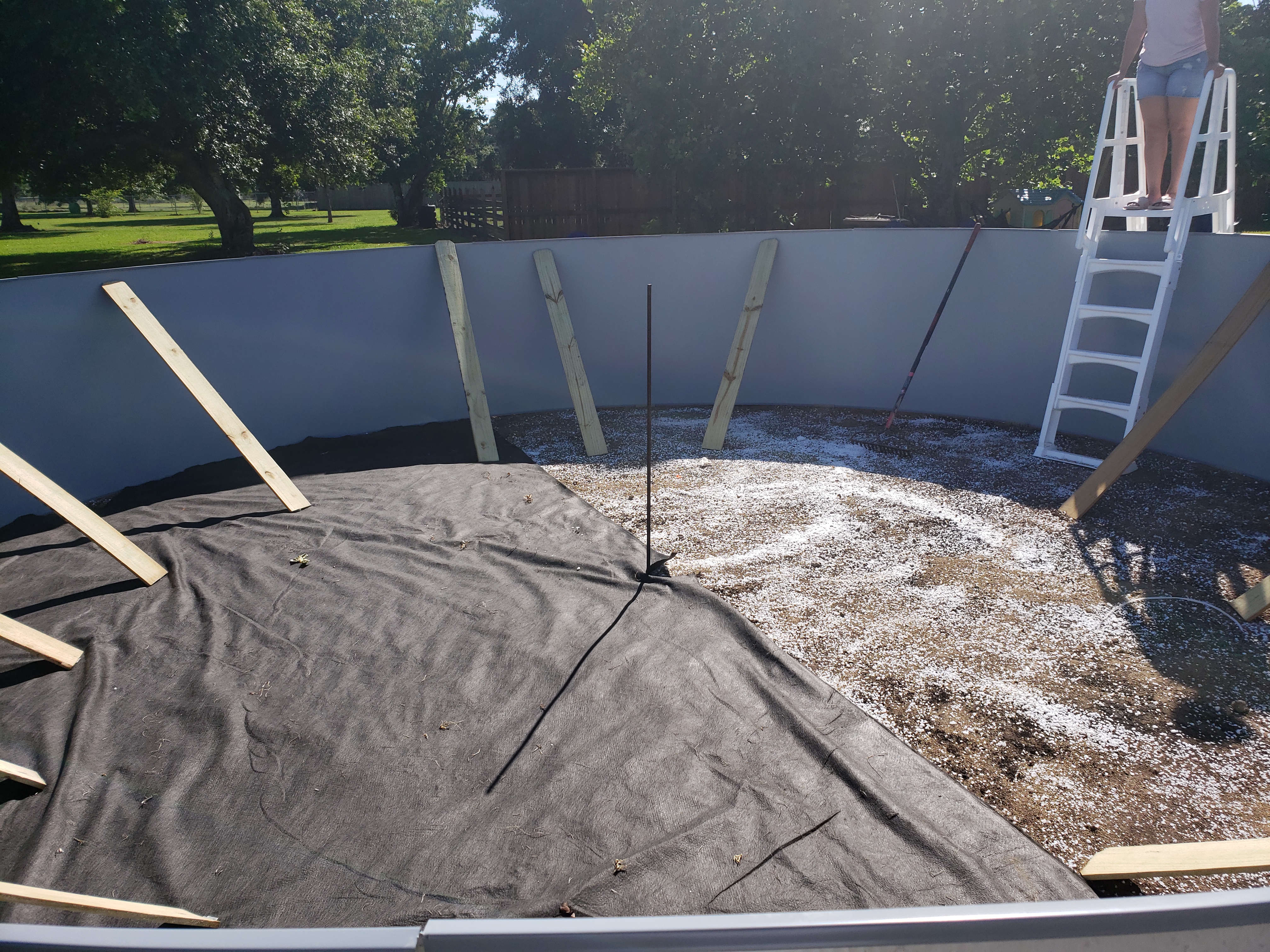

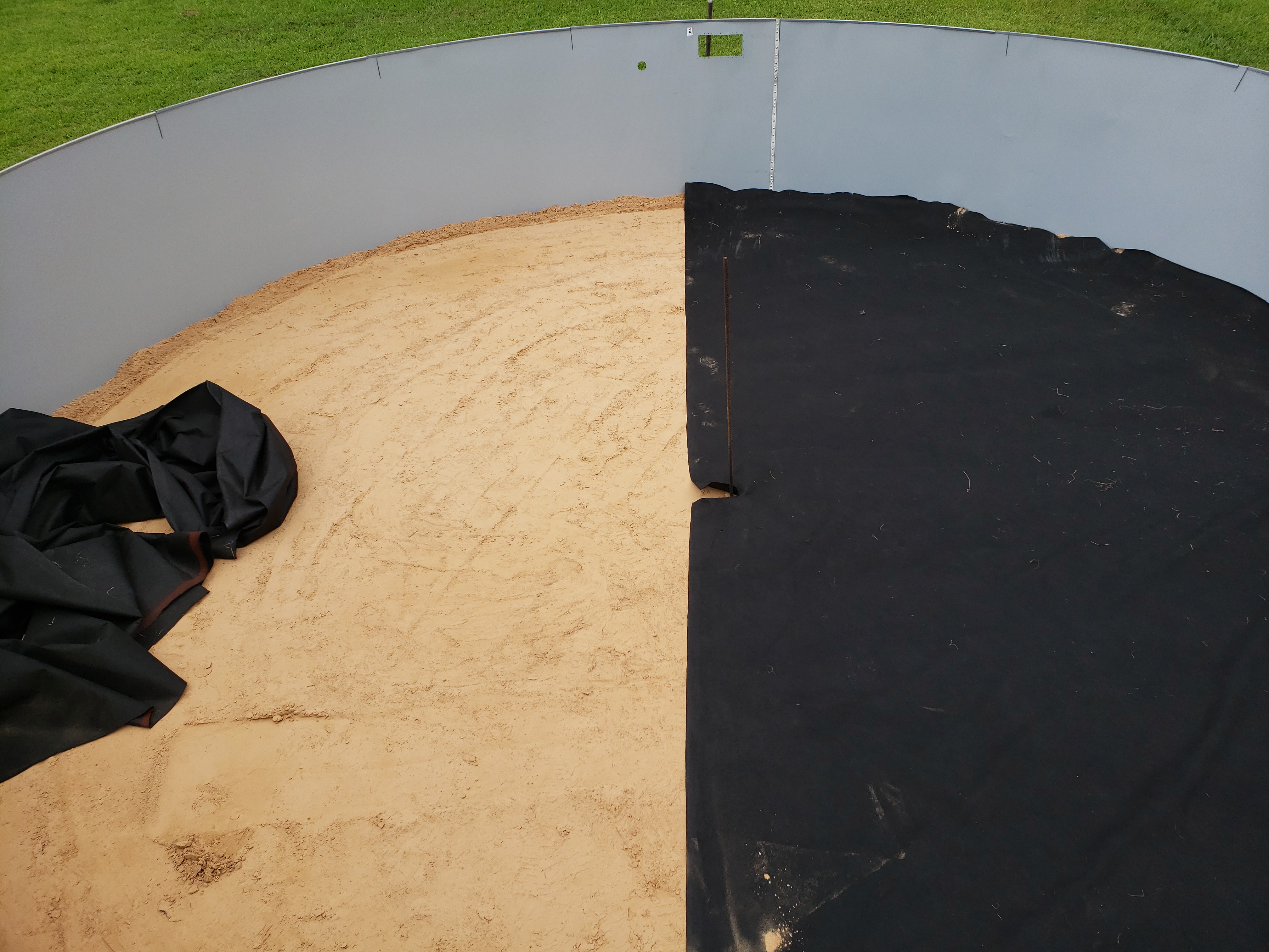

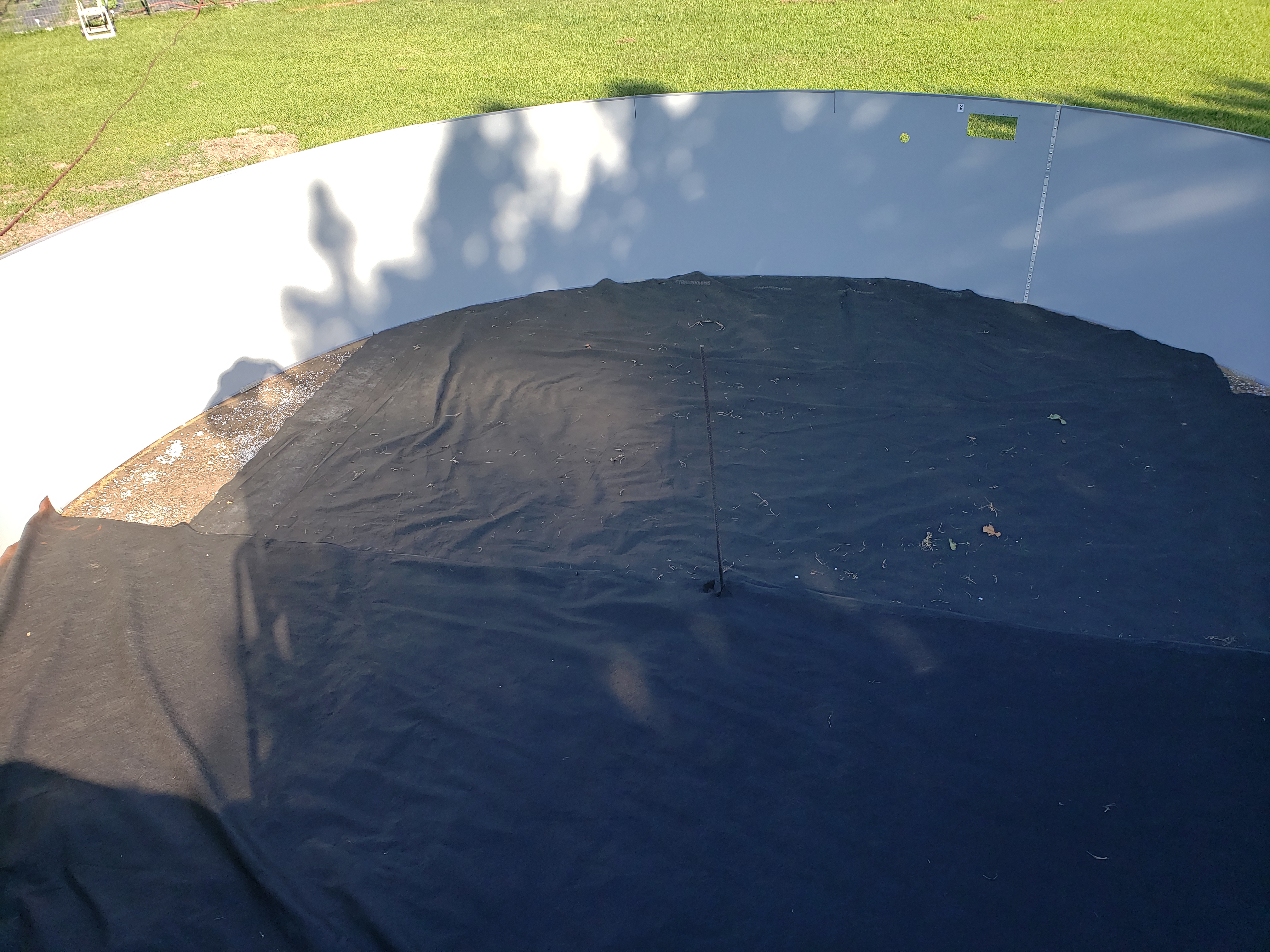

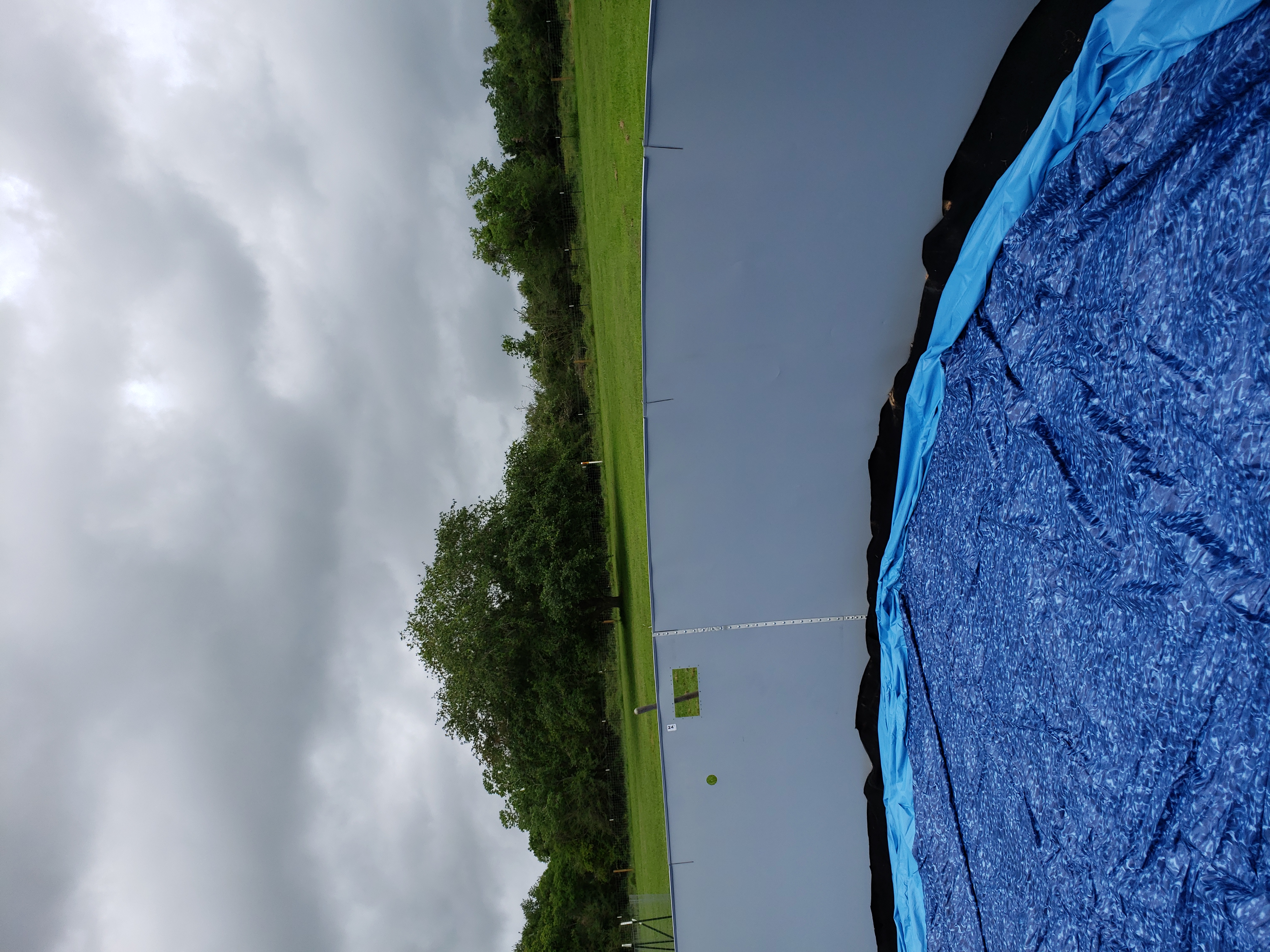

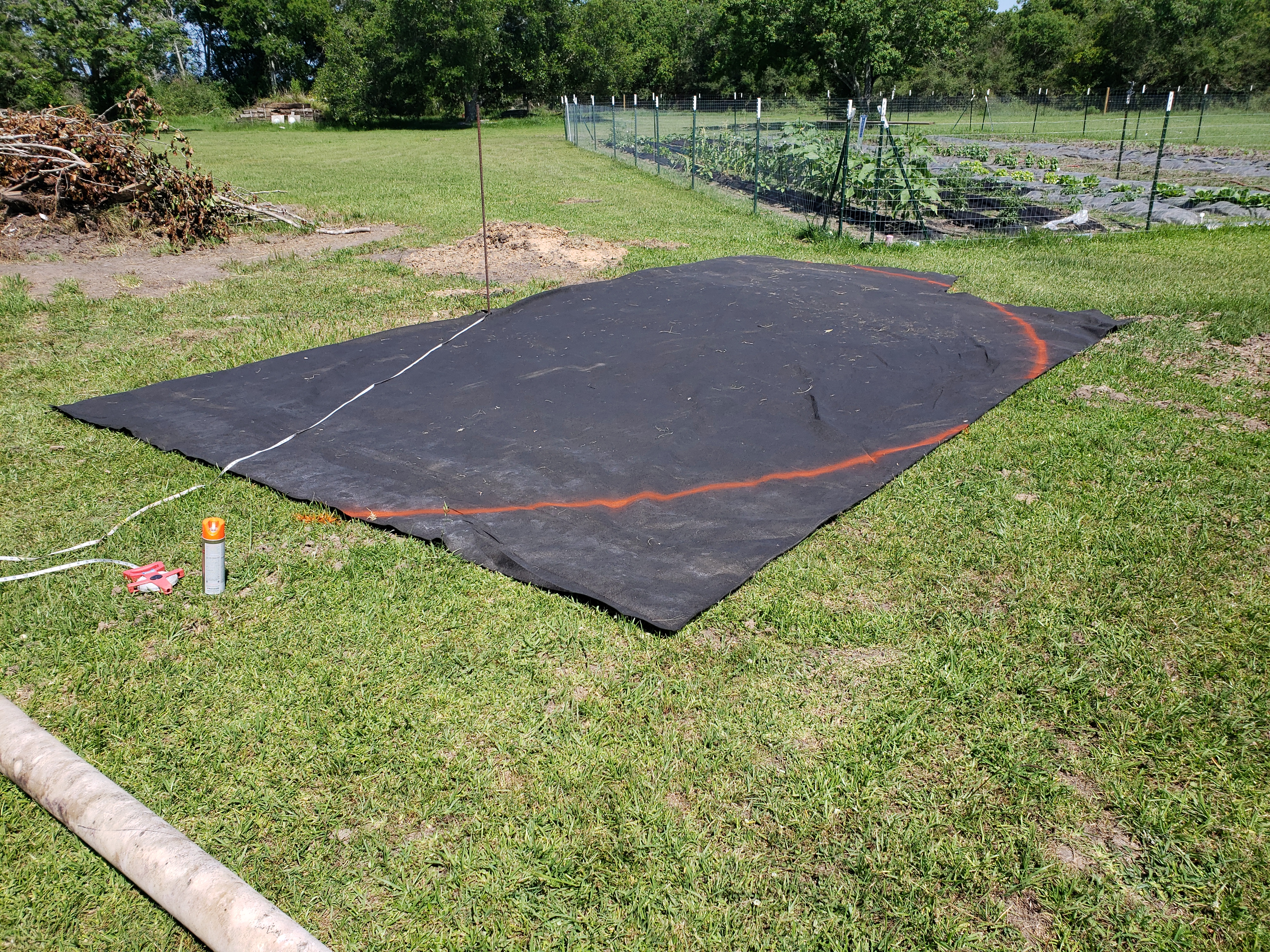

So the pool is up. I layed 150lbs of salt and 50lbs of amdro, then a layer of road fabric, then 4-6" of compacted sand, then another layer of road fabric, then put in the liner. I was out there in my underwear laying the liner as the heavy rains were coming in. By the time I was done, I was flopping around in 2" of water.
