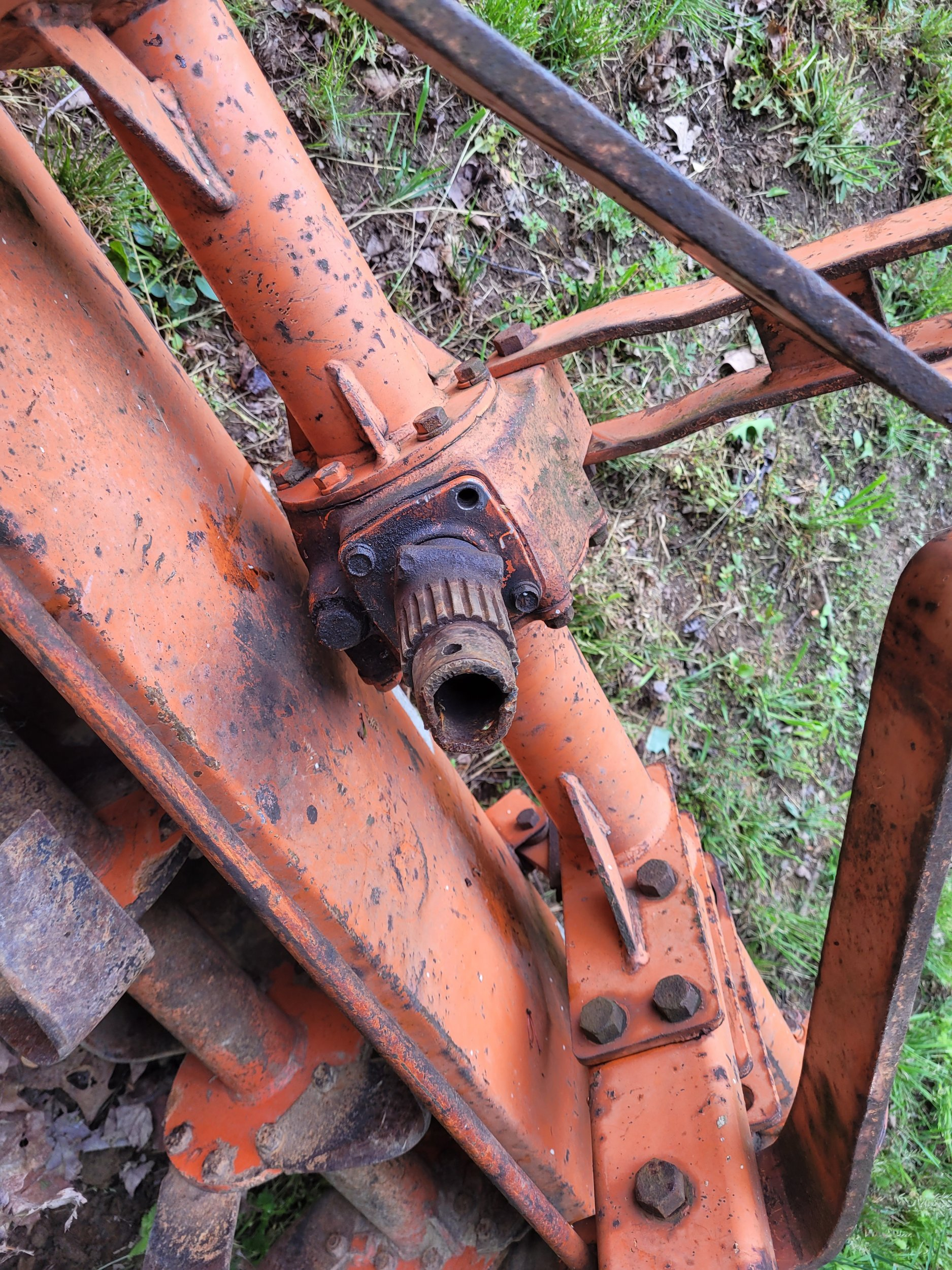

May 22, 2022 / Any advice??? #1 D dep27rn New member Joined Jun 9, 2013 Messages 12 Location Chester, WV Tractor Bobcat TC 235 Bought as is. Seller couldn't get this piece off. Looking for ideas to remove and replace so I can put a pto clutch on. There is a solid piece inside the pto sleeve. Any advice? Thanks Attachments 20220522_183800.jpg 3 MB · Views: 121

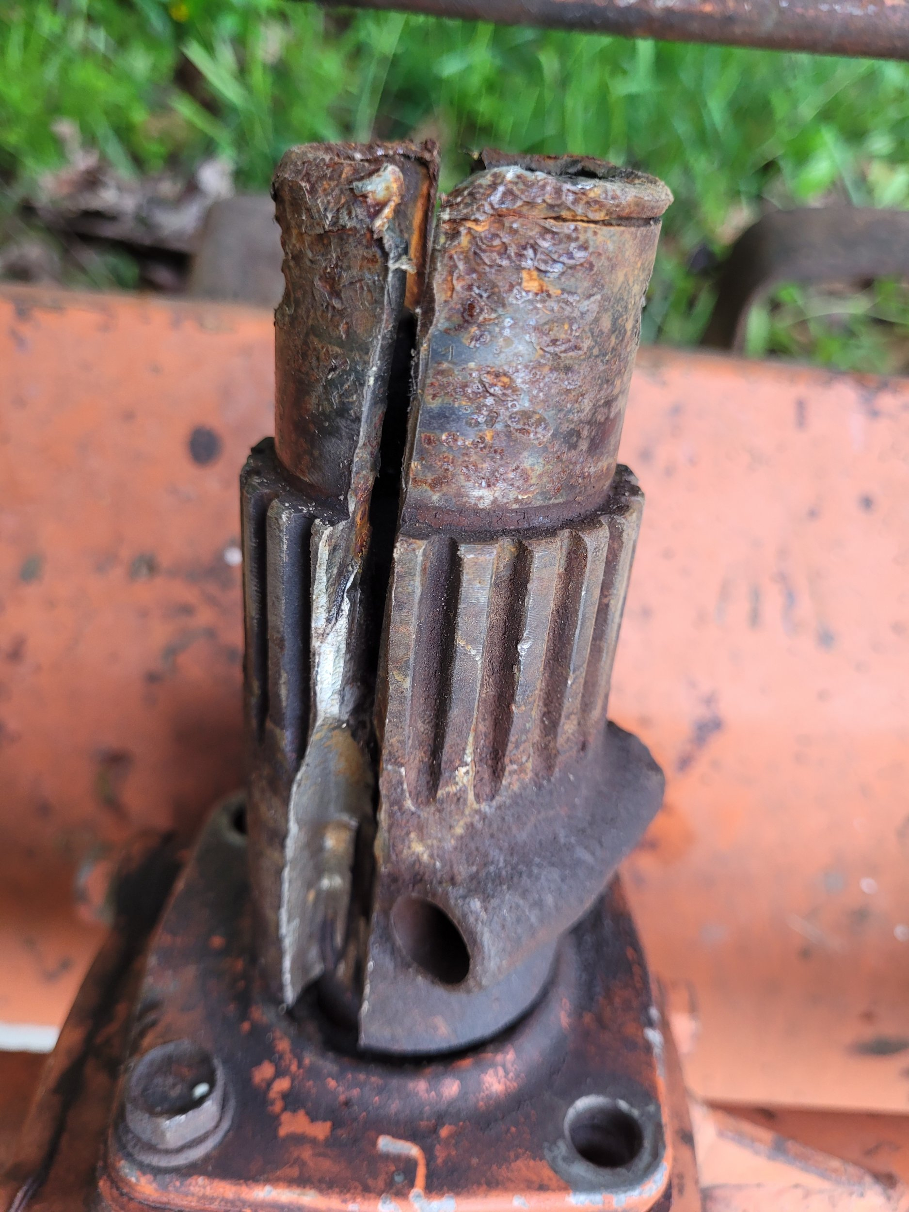

May 22, 2022 / Any advice??? #2 J John0829 Veteran Member Joined Nov 17, 2018 Messages 1,617 Location Western Ky Tractor Ford 850 John Deere 1025R It's already split on one side now split the other, it WILL come off.
May 22, 2022 / Any advice??? #3 T tshep Gold Member Joined Jan 12, 2010 Messages 418 Location Richmond, VA Tractor BX23 MLB Run a drill through the lock bolt hole.
May 22, 2022 / Any advice??? #4 LouNY Super Star Member Joined Jul 4, 2015 Messages 14,753 Location Greenwich, NY Tractor Branson 8050, IH 574, Oliver 1550 Diesel Utility (traded in on Branson) NH 8160. Kioti CK2620SECH I'll second the split the other side method.
May 22, 2022 / Any advice??? #5 M Mtsoxfan Veteran Member Joined Nov 19, 2021 Messages 1,556 Location Newark Vermont Tractor Kioti 3520SEH Holland TC29D torch?
May 22, 2022 / Any advice??? #6 oosik Epic Contributor Joined Aug 22, 2012 Messages 20,900 Location AMBER, WA Tractor 2009 Kubota M6040 If splitting the other side doesn't help - split it four ways. Gently heat the toothed outer piece - rap on the inner piece with a hammer.
May 22, 2022 / Any advice??? #7 ljjhouser Veteran Member Joined Oct 25, 2018 Messages 1,387 Location Midwest - Ozarks Tractor Kubota L4701 Angle Grinder with cutting disk?
