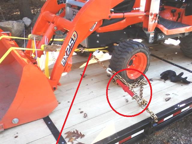

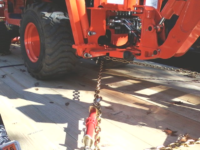

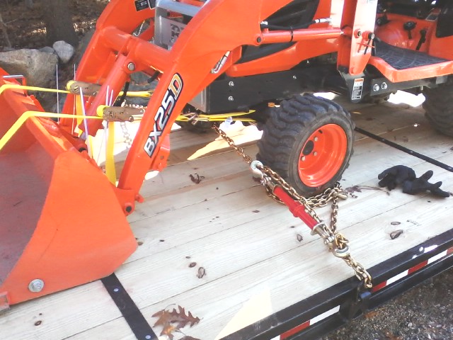

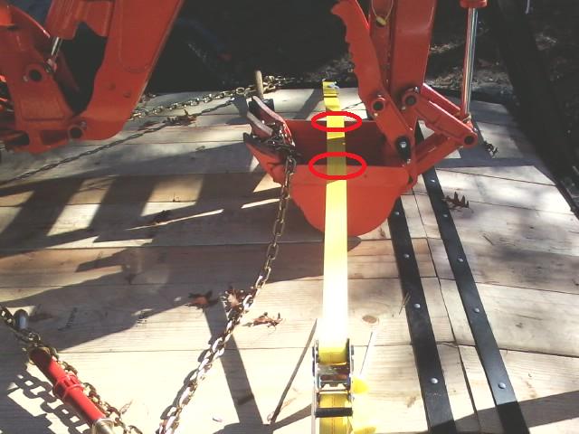

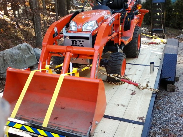

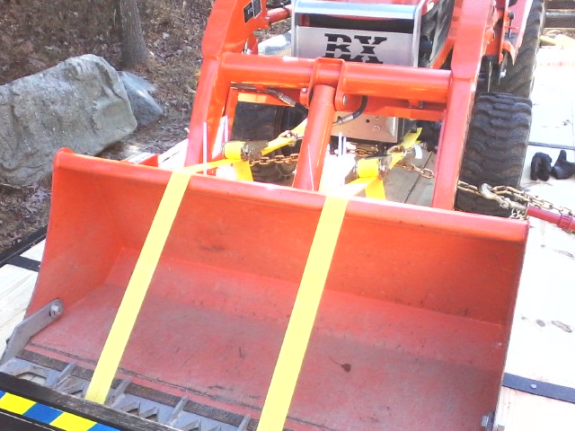

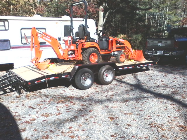

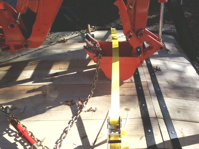

This is what I ended up with.... Thank you all!...Learned something too.

Looks good. Just a couple changes though. The front chains should not be 90* to the tractor but closer to 45* (see pic) just like the chains on the back. Also, you'll need some protection on the straps going over the BH bucket to protect the bucket from cutting into the straps (pic). I can't see how the front bucket straps connect to the trailer but they need protection if they go over a sharp metal surface as well.
Agree. Thank You. I've got a couple of ideas for the front chain. I'm also working on some used Fire Hose to use as a chafing guard. Also, I'm drawing up a welding idea that might work for the "quick set up" front bracket to give me the angle. As I said to my son..I don't want to be laying all over the trailer hooking it up after working at his house for free. HaHaha.:laughing:

I ran 10-15k lbs rated straps over the brush Girard on my L3200. There were corners on the metal, but nothing I could cut myself on unless I punched it hard. I cranked it down tight & took off for a 30 minute drive. At the other end, the strap was cut about 1/3 of the way through. Opened my eyes.
I could have done a better job finding a flat or round place to route the strap I guess. Instead I got some chains & binders, now only use those for my tractor or anything else metal that I need to secure to the trailer.

You'll need to get some angle on the front links. The machine is free to move rearwards as you have it. Also the bucket has to be anchored entirely to the deck... not back to the machine.
If you can get a solid point at the loader mount, it will be much better.
