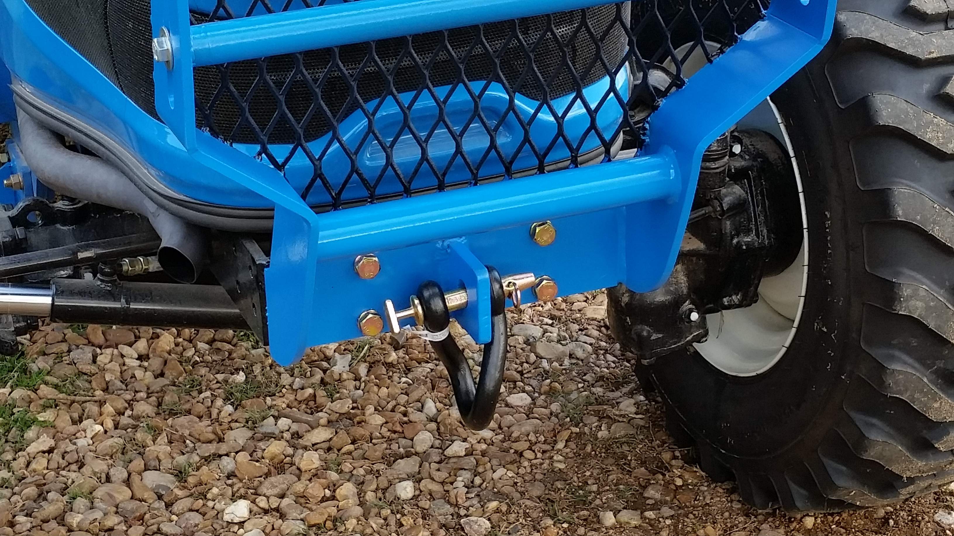

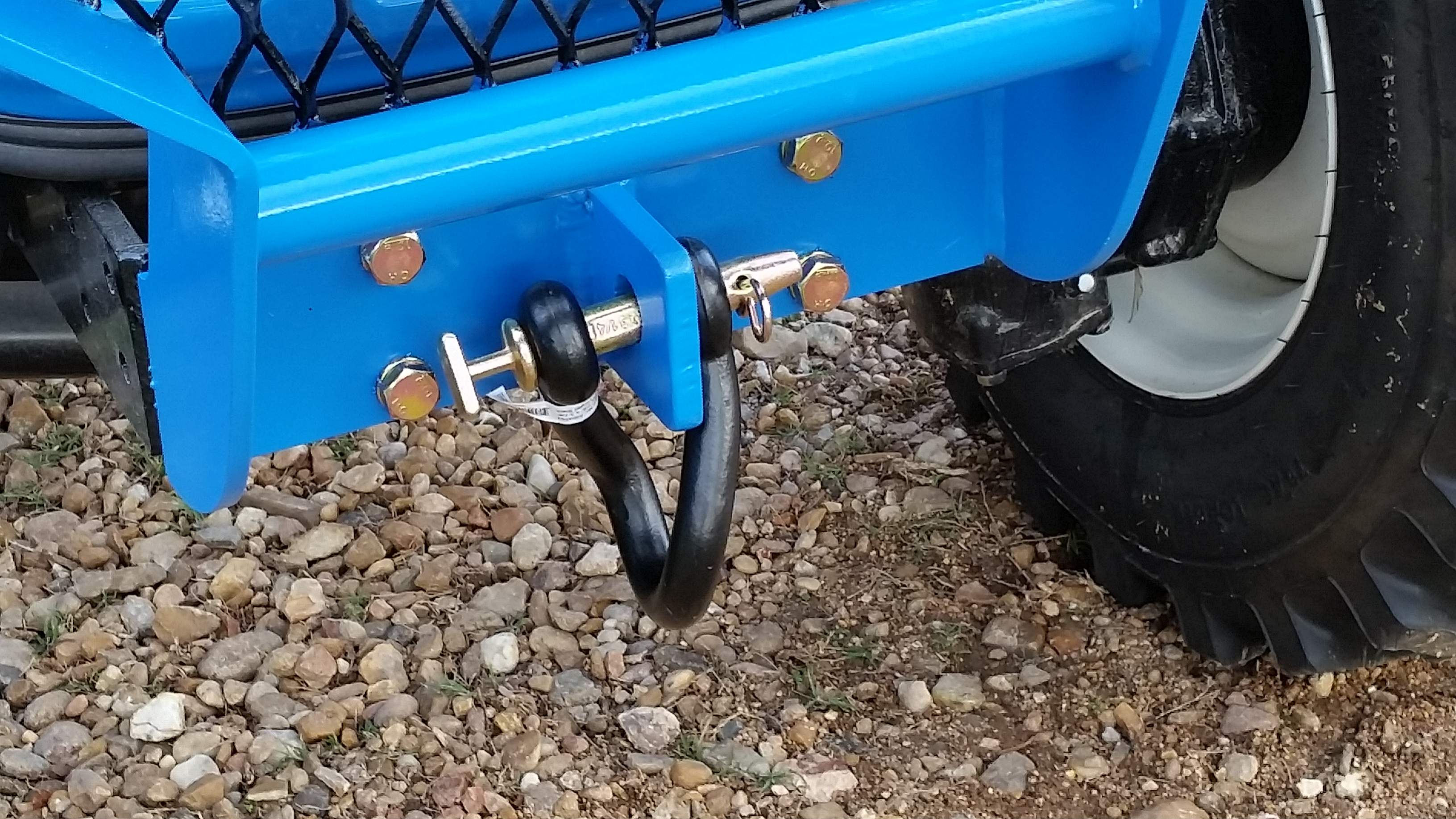

When I rebuilt my LS XR4046HC grill guard, to protect front of tractor, I added a padeye to grill guard mounting plate. I use a twisted clevis to run tie down chain through and a straight clevis attached to rear drawbar.
To secure the FEL bucket and any attached implement I use HD straps with chain and hooks on ends.
Every place the strap is across a sharp area I can place a strap protector.
After loading tractor and getting hitch weight where I want it I chain rear of tractor with chain hooked back to itself with no load binder. Then I move tractor forward to take any slack out of the chain. I run chain thru clevis, on the grill guard, and tie down using a single ratchet type load binder on front end only.

Nice clean tractor/waxed and detailed?.....neat looking welds on expanded metal grill that you added? Thank You for sharing your ideas.
