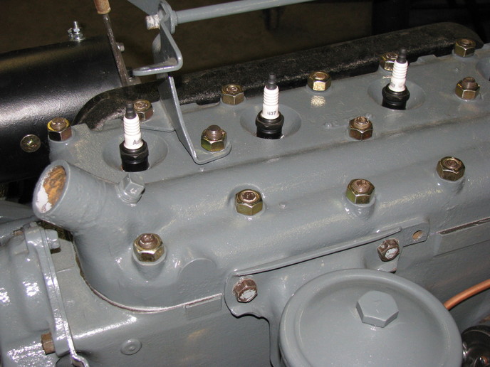

the no generator / spark is not a very good theory.
ignition draw is a duty cycled 3.5a drain at best.
you should be able to run longer than you have gas tank on a good battery witht hat level of drain.
original N head had no place for a sender. later industrial heads had a flat boss for them IE.. drill and tap.
putting it in the block drain will give you a much colder reading.
I have known people that made up a pipe coupler in the the top hos etha thad a sender fitting in it.
it's really not needed imho..

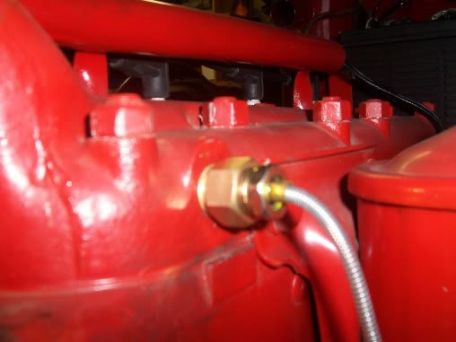

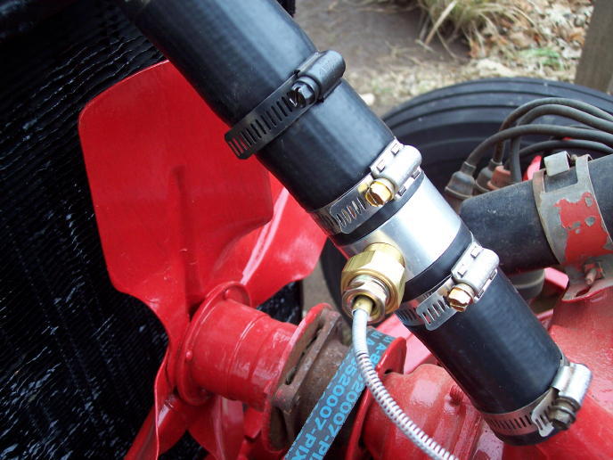

I agree with SG on the non working generator contributing to your run issues providing you keep your battery charged up.
Here's how I added a temperature gauge to mine:
Here's a couple of alternatives if you don't have the boss cast into the head:

No boss in my head I believe my 2n is mostly all original other than the rubber and electrical. I am with SG on not needing the temp gauge, for all I do which is mowing 3 hours a week I can't justify adding it if it made it this long without one.
I know some will argue that justification though.
However DB that is a nice looking setup on your tractor as well as the alternatives you showed. Thanks for posting them I appreciate it.
