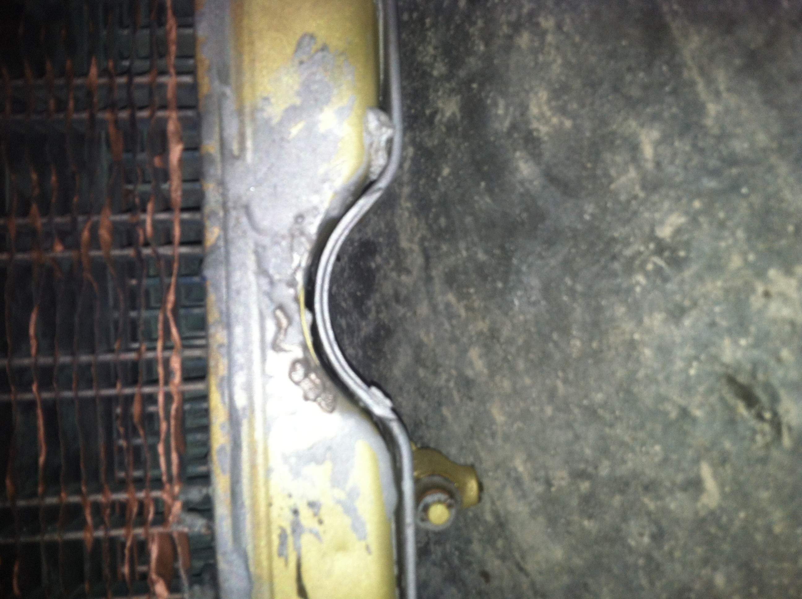

I bead blasted the the radiator and fuel tank today. Found a hairline crack in the fuel tank about midway up the front. That is why I have never been able to fill it all the way up. My dad is going to braze or solder it I wanted to JB weld it he wouldn't hear of it.
The radiator is sad story after blasting it the bottom clearly has been the victim of blunt force trauma and copious amounts of jb weld. I hope the radiator shop can save it and yes I would have them just braze the drain shut.

Bottom of radiator.

good luck on that tank.
many shops won't go to the trouble it takes to burn the jb weld off to repair..

I don't blame them. Fortunately the caterpillar dealer I work for has its own radiator shop at another branch and the radiator tech is friend of mine we went to high school together. If it can be saved he is the one that can do it, also if it can't he won't bs me about it.

My dad came up yesterday and brazed the radiator and brazed a crack in my fuel tank. All leaks are fixed now thankfully. I also did an engine oil and filter change it was very nasty oil...
I put a new 160 t stat in and a new upper hose as well as a bunch of new hardware and fixed Jerry rigs, or quick field repairs here and there that I uncovered along the way.
Ran for an hour last night and so far so good. I will have to mow tonight and that will take a couple hours.
