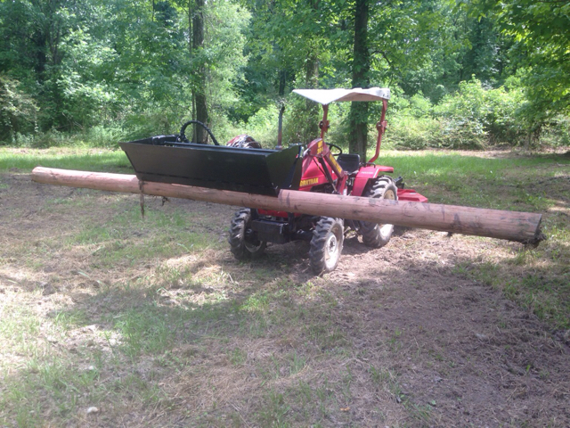

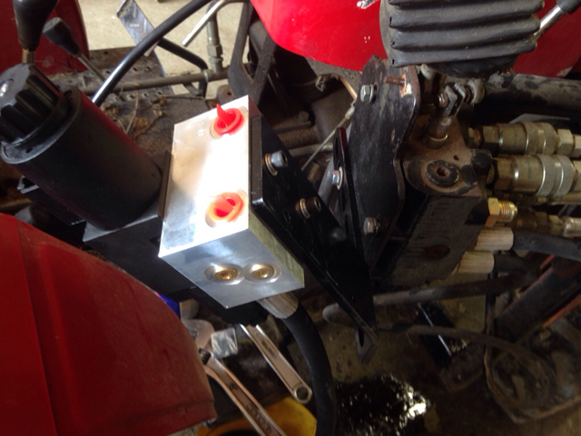

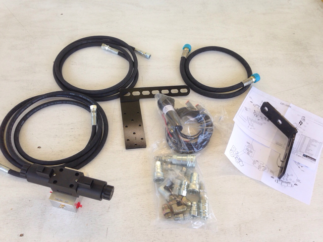

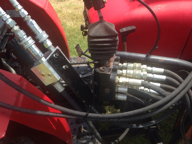

I added a 4 in 1 bucket to this little tractor, but I needed hydraulic flow to it. I used an Ansung valve kit. The kit is set up to use on some of the Ansung loaders, but I was able to use it on my loader valve set up without having to purchase any addition lines, fittings, or making brackets. All I had to do is just change the power beyond line on the loader valve to tie into the 3rd function valve.

Looks good, is that a Nortrac tractor there. How has it been?
/ Ansung CP1000 3rd Function Valve Kit
It is a similar tractor. Just with a different name and loader. We use to import the units and had loaders made for them. This is the 28hp unit. I've used one before and did better grade work then using a 35hp hydrostatic unit.
