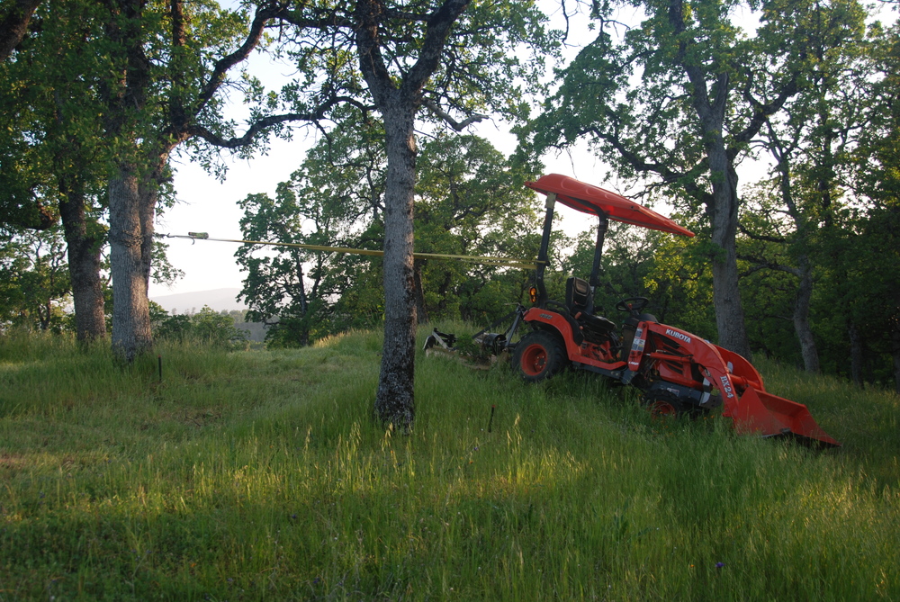

I tried to mow "just a little more" down the hill, and got into trouble, with one wheel off the ground. I dropped the FEL, turned off the tractor and stopped to think. Turning the wheel seemed to make it less stable, so I felt stuck. No way to go forward or back. I got a 4000lb tie down and looped the ROPS to a nearby tree. I was then able to pivot around the tree and get to safety. These pictures show the tractor once I had maneuvered a bit and gotten all wheels on the ground. This may be an obvious solution, but maybe it will help someone.

Glad you managed.
But with the rotary cutter on the rear, you should have turned the wheels the opposite way (from shown) and backed out with a slight lift on the 3 ph.
Brake the right wheel so the left rear wheel maintained traction and the right one wouldn't spin (may not be possible if the individual rear brakes are on the right side with the HST forward/reverse pedals).
But good thinking and now just backing straight down the hill to mow should work ok for you. :)

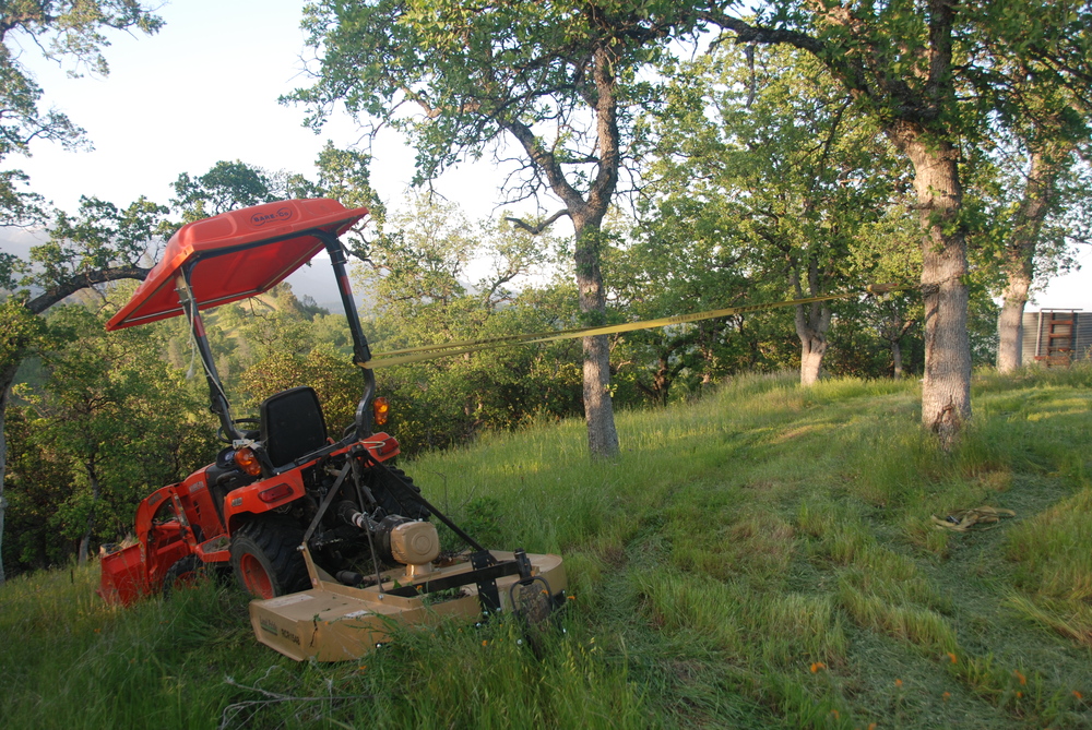

Good save! I'd bet that was pretty scary. Hard to tell from pictures, but it looks like it falls off pretty far and seems to slope to the left so you really were off camber quite a bit. Have you mowed there before? I'd be thinking about backing down the slope, but all those trees certainly get in the way. Are your tires ballasted? Glad you are OK.

I hadn't mowed there before, so fortunately was taking it slow. The immediate problem was a couple of small rocks under the wheel that suddenly changed the pitch. The sunshade is plastic, and light, but with the ROPS as a level arm, a small weight can make a big difference. That was easy to see when I attached the tie-down. Just a couple of easy cranks brought the tractor much more vertical. I'm guessing just 100lbs of force made it safe, and was why I didn't worry about the force on the tree. I know in theory turning the wheels downhill should have solved the problem, but it felt so unstable when I turned either direction I figured it best to stop and play it safe. Given the side tilt I was uncomfortable using the FEL to push the tractor back up the hill too. Lots of little lessons learned for me.

Hard to tell from the pictures but do you have you bush hog swung all the way to the left?
That will also have an effect if it is on the downhill side.

I wonder if you'd been able to back down that slope? Maybe not quite the same route...little bit more across the slope.
This is based upon what I think I see in that second picture...which may not show the whole situation.
This is just a question...not a criticism...

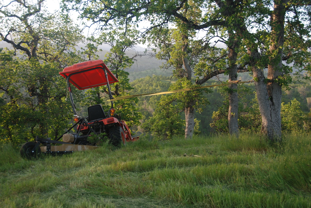

I think you did everything right by playing it safe, stabilising, and taking it slow--as witnessed by the fact there's no damage to you or the tractor. From your pictures I too would have been reluctant to turn more directly downhill for fear of being unable to crawl back out or further destabilising things.
Hilly terrain is dangerous and demands extreme care when operating "near the edge". Even when one is familiar with such areas conditions can change. Taking a slightly different track and running one tire over a previously unnoticed mound, depression, or rock can dramatically change what previously appeared as a stable condition.

After looking at the pictures again, you can see how the cutter drifted sideways, downslope. Seems like the anti-sway links must have been pretty loose to let it get as far as it did and I'm pretty sure this contributed to the near rollover (although the leftward movement made have happened after the fact).
When backing down a slope, a cutter is going to track the path of least resistance (especially on rutty, uneven ground) and I just follow as long it's cutting somewhere near where I need to mow. Sometimes I have to raise the cutter to get it back on track. Got to watch when doing this though..especially on a slope!!

Backing down the slope is certainly the way to do this in the future. The only problem is that is much slower that just driving forward across the slope. Tightening up the three point is a good point - it was tight when I started, but seems to loosen up after a few hours of mowing.
