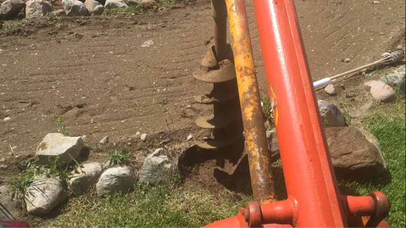

My auger managed to get mangled after hitting some roots.... Still works fine .... this is a Danuser F-8

My bit tip is the standard screw tip seen on most augers. I saw that fishtail/butterfly auger tip you upgraded top on two different OEM augers but never was able to find out what the difference would be vs. the standard screw tip. So I did not purchase it as in my soil my thought was it would get broken. My auger tends to jump around a lot while digging most holes due to the flights hitting rocks or large tree roots. My whole property was a forest prior to me clearing a homestead and driveway location.

I drilled hundreds of holes and only got it stuck when I was in the learning stage. After a few traumatic experiences, I learned to dig in small increments, reduce the PTO speed and raise the auger back and forth so it could clear itself out. After figuring that out, I didn't get it stuck for the next 10 years. Just a thought here that may not apply.
Yep, I know how to drill holes. I think what happened was it drilled down okay, well as okay as one can have on my property, and was able to drill past a protruding rock in the hole that the flights missed or scraped over as it went down. I was down and up with the auger every 9" or so until I got about 2.5 feet deep and then it would not come back up. I gave it more power as I recall and it just drilled deeper and then broke the shear bolt.
Once I finally removed the auger and was able to clean out the hole manually with a rock PHD, I did bring up a few rocks along with a bunch of dirt. But no direct evidence of what may have happened. Maybe I let it get too deep before cleaning the hole or maybe not. Butt it is done now and filled with a post and concrete :)

When I bury my auger, it's because I've gone through the red clay and into the grey clay. That grey stuff is a lot harder and it holds together more, so the auger tends to bury itself into it instead of breaking up the dirt like it does in the red clay. Most of my land is red clay and I've only hit the grey stuff in a few places.
I'm not strong enough to turn the auger with my 4 foot pipe wrench, but with a ten foot length of 2 inch pipe over the end of the wrench handle, it's pretty easy, just awkward keeping the wrench in place.
