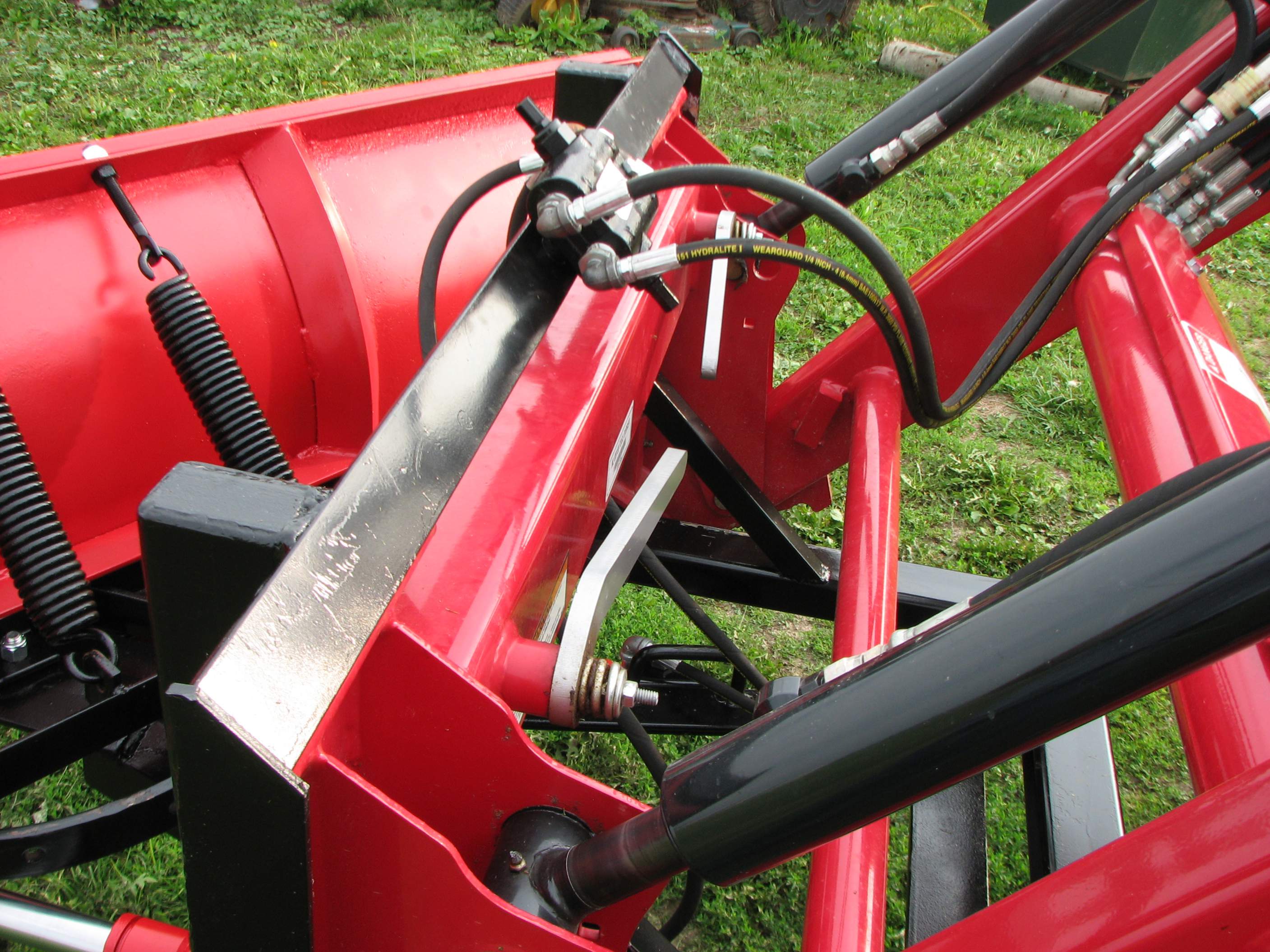

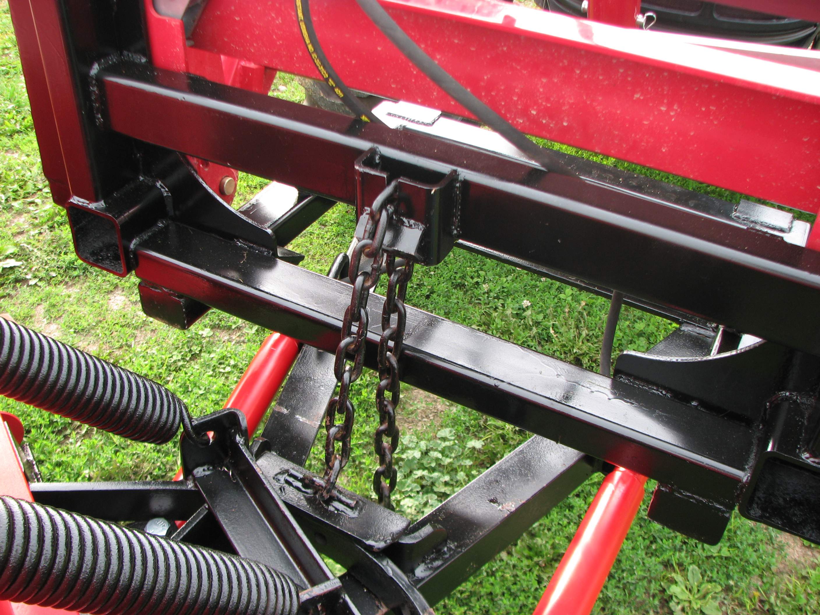

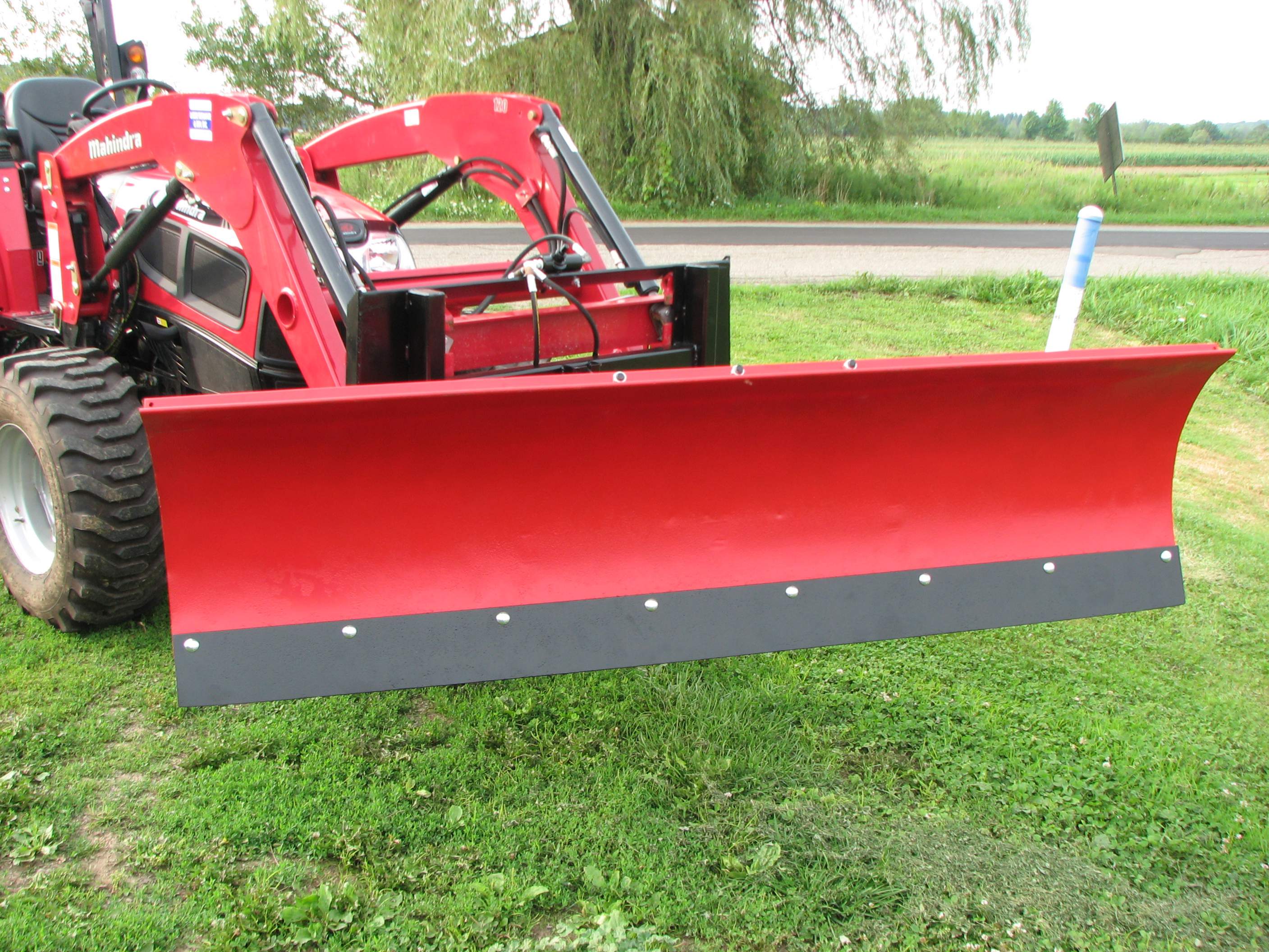

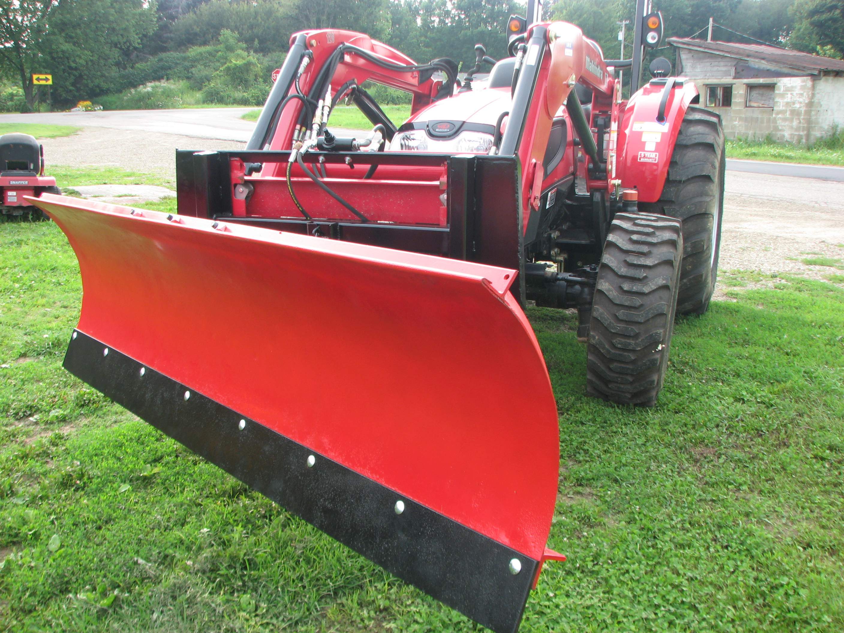

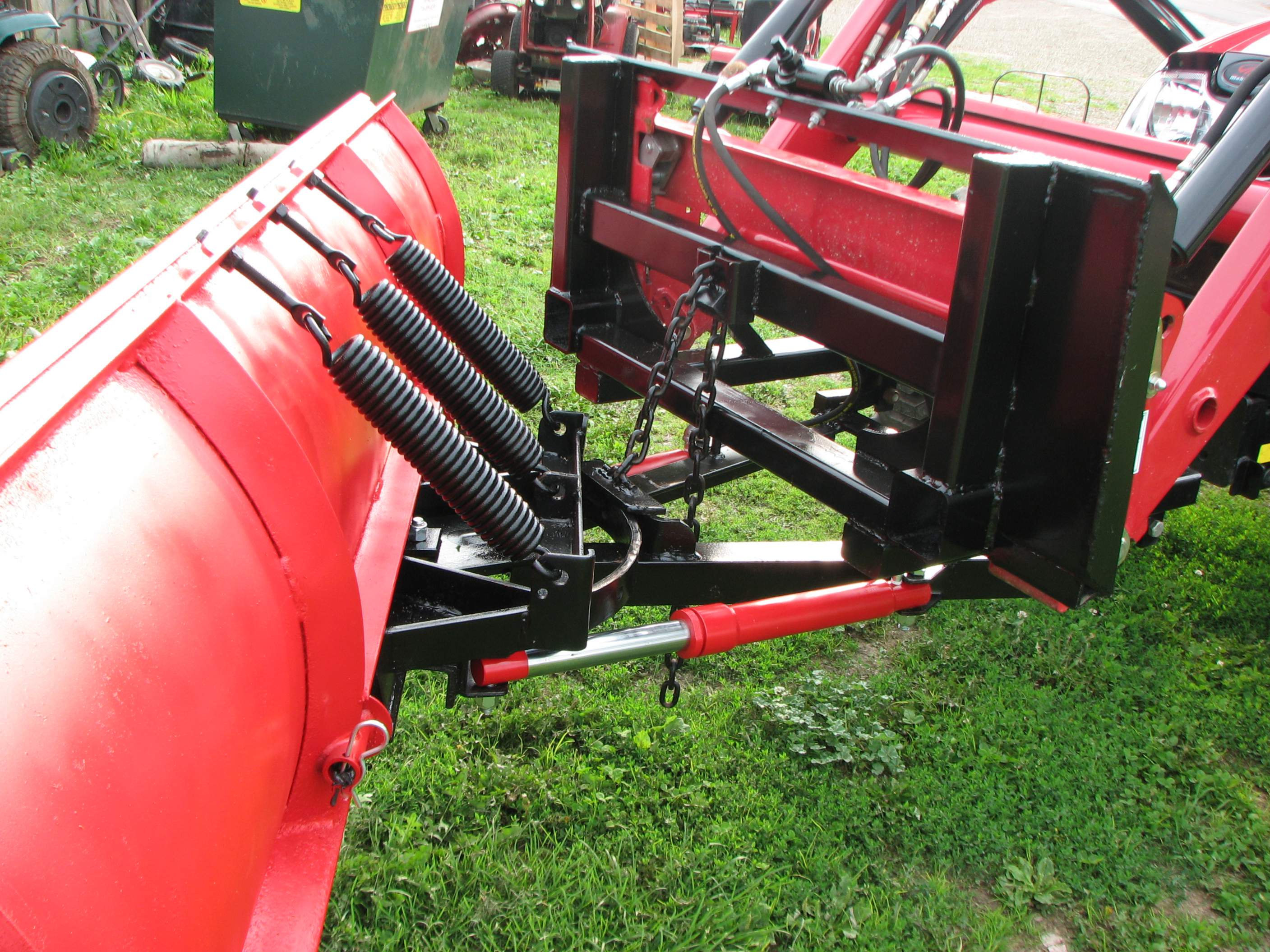

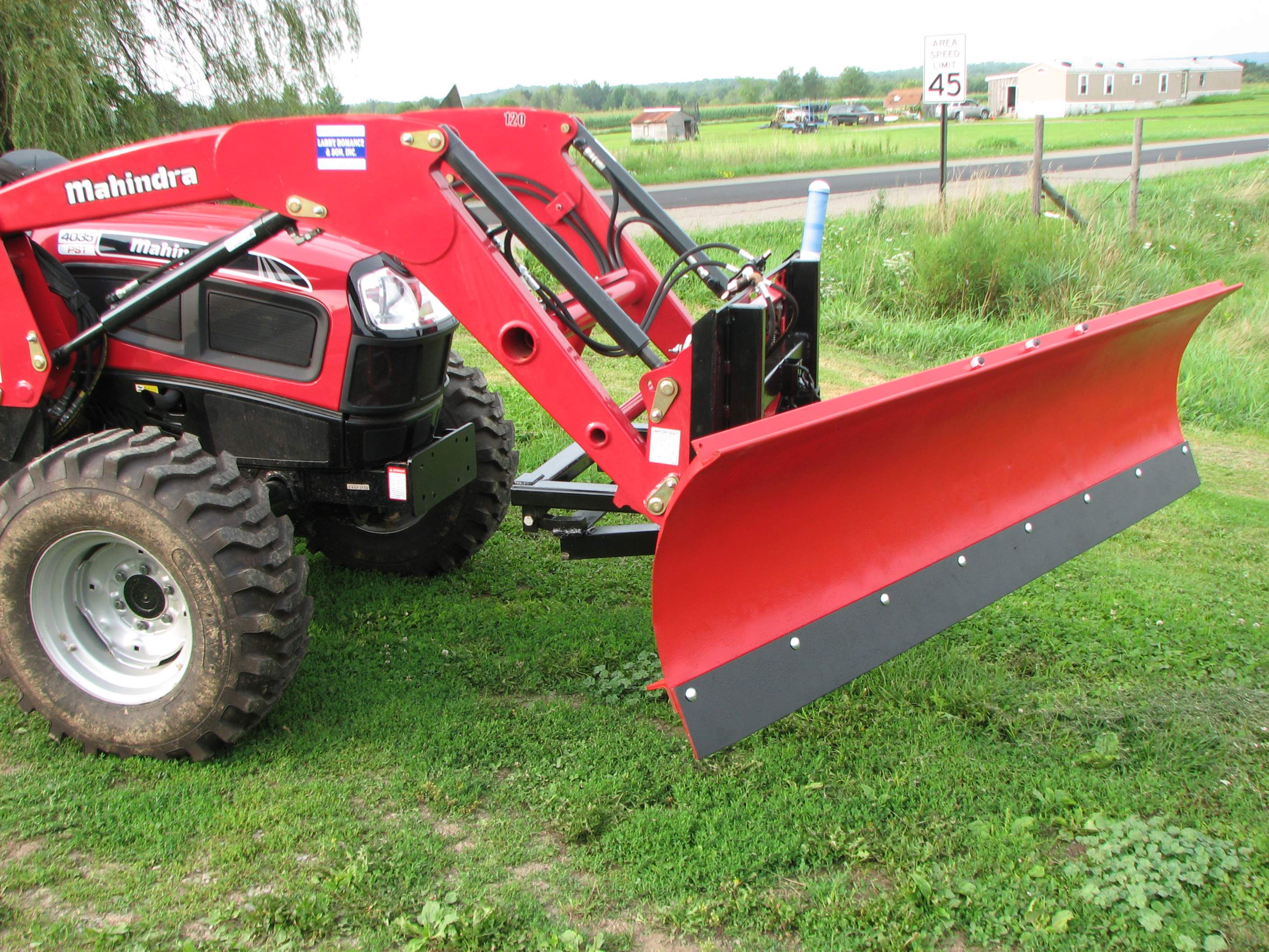

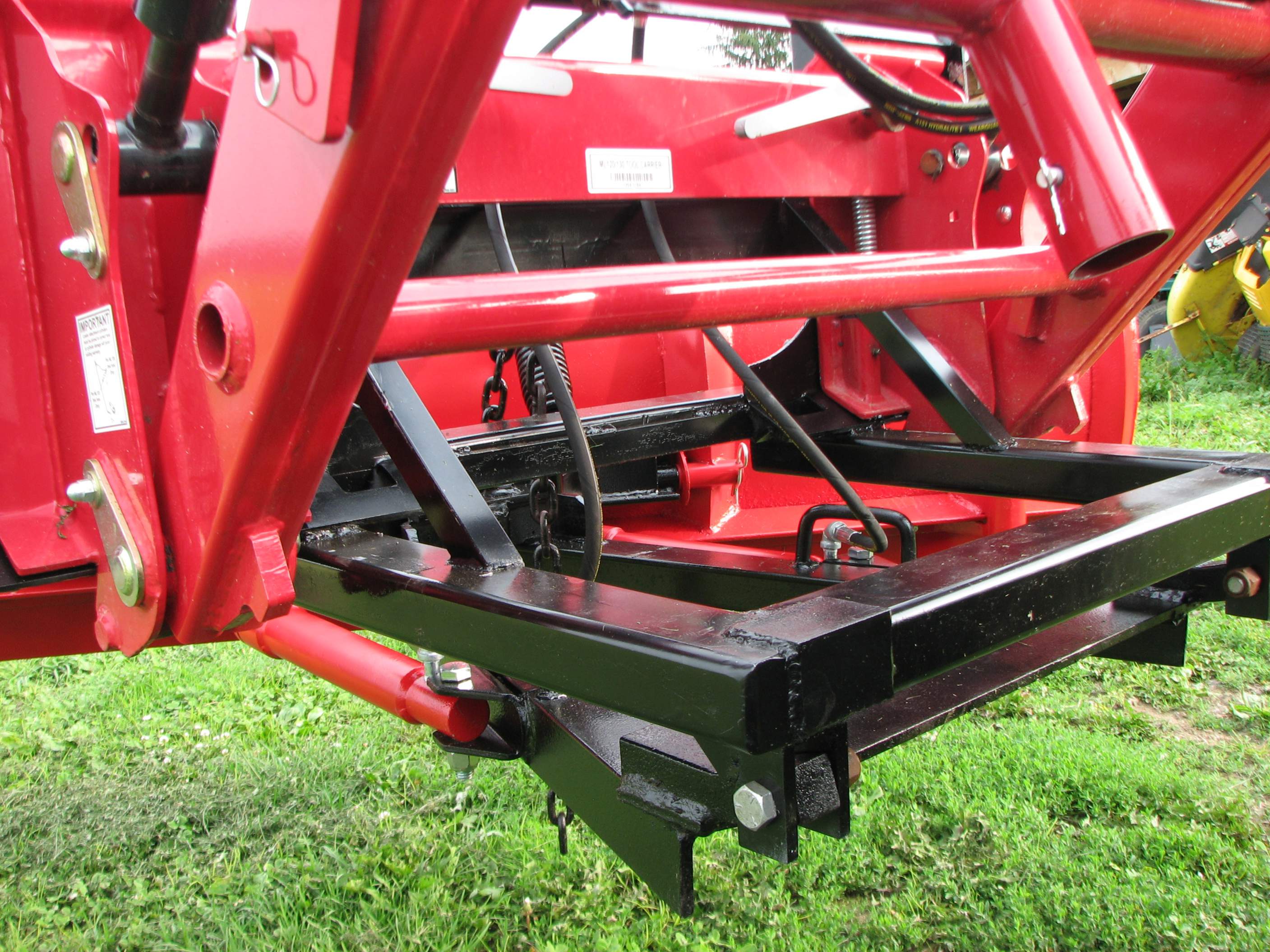

Finished the plow today, just need to mount the edge markers. Got the hydraulics plumbed into the rear remote, it works beautifully. The only thing I have a problem with is setting the relief on the x-over valve, does anyone know how to do this or have instructions?

Looks good.:thumbsup:
/ Another QA plow build thread. (Need help) #23
Excellent build ! Bet you could build and sell a few of those !

I just left my crossover at factory settings. I forget what it is set at, but it us in the specs or on the web page. I think it was like 2200 psi or something appropriate for a typical 3000 psi system.

The plow looks great. Thanks for the pictures.
/ Another QA plow build thread. (Need help) #26
Good looking build. Quite similar to how I built a Meyer plow for my JD 3320......keeping blade back near the loader. Well done.
