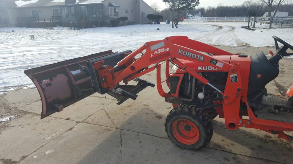

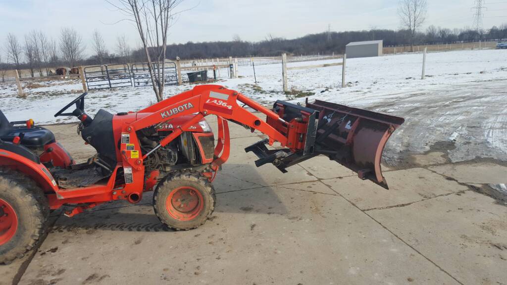

I hooked up my son in law's snow plow which I fabbed up a month ago. I'm going to declare victory on this project.
Later this week I'll weld the quick attach plate to the bucket. uploadfromtaptalk1452110008765.jpguploadfromtaptalk1452110014294.jpg
   / Another pin on to SSQA Conversion #67
I would say you did good. Putting the plate on the old bucket should go easy.
