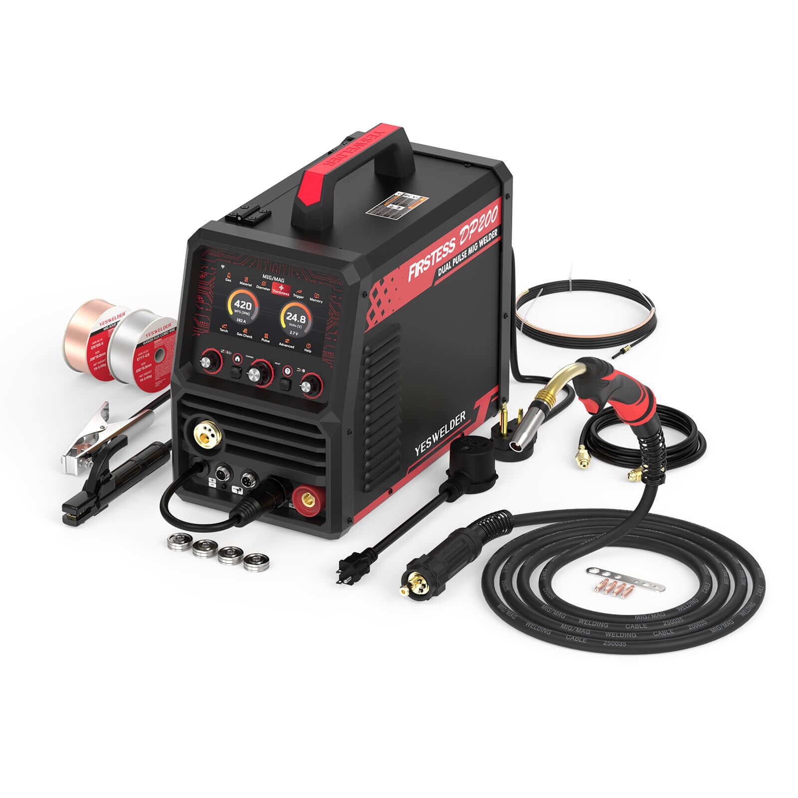

Here's my $0.02....
If you are ok with buying Bullets for China ( and a lot of US machinery is now rebranded Chineseium ) then take a look at the YesWelder brand.
I have the older version of this model, I really recommend that you run it with 240v vs 120v as I kept popping breakers to get enough heat with 120v. But it is possible.
I looked at a lot of name brands and not so name brands and I couldn't beat this machines price vs. performance ratio. Right now about $550. No way does HF even come close, either.
Get the 20' welding gun/cable with the standard consumables - it's extra but so worth it.
I run gas when I can - but did a F350 dump body with brand new steel with flux core for a friend. Just remember to flip polarity when moving between normal wire/gas and flux core.... I was stupid at first and couldn't understand why the thing was laying down streams of fluxcore BBs.... Oops!
I'm also running their 65 amp plasma cutter - works nicely for little $$$.
Good luck, Blake
If popping breaker on 120V the problem is not the welder but supply amperage for 120V receptacle.... Upgrading to a 30 amp circuit solved the problem for me with my Hobart Handler 140....

120v supply @ 30A can get you by, when there’s no other option, but the cords and connectors are all more expensive (AWG-10, or larger for long runs), and it certainly creates some uneven loading on the panel. Best to configure to run 240v, when at all practical.
