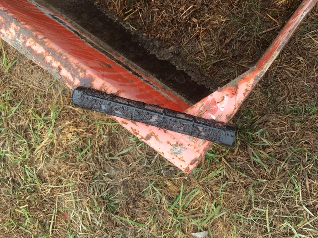

Do you have any pictures of the debris from the screen? Sounds like it could be brake material that has separated from the disk. I would definitely recommend removing the filter relief and checking it to be sure it is not stuck open. You will not see oil level from the fill hole unless it is extremely overfull- probably would take at least 5 gallons overfull to see it there. I also think I would drain the oil and remove the sump screen. The vacuum could be dislodging some of the debris from the screen as you remove it and then as soon as you start it back up, could be sucking it back to the screen.

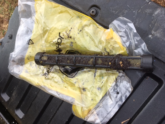

Yes, the vacuum must be pulling the debri away from the screen. The pic of strainer on plastic wrap was last week when I first pulled it out.
The savcond time I pulled it out (using the shop vacuum) there was very little crud. Today (draining all the oil) crud FILLED again. Pic of strainer on grader box.
So, yes the vacuum must be pulling the crud away. Amazing!

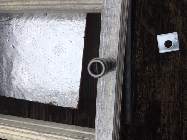

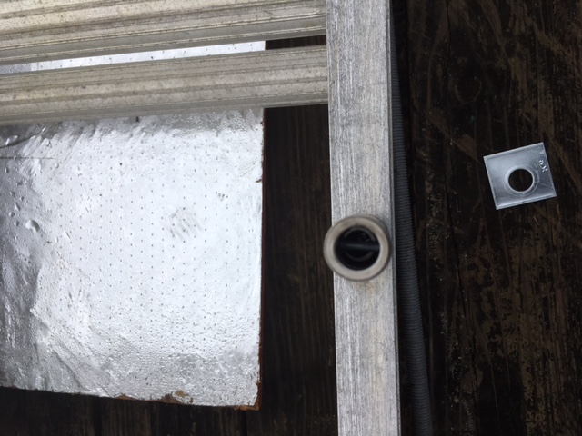

The top of the trans does not have to come off to replace the brakes, although it can be helpful to flush out the housing. Inferior or improper oil can help deteriorate brakes, but the biggest enemy of wet brakes is water. If the oil gets contaminated with water, it loosens the lining from the brake disks. There are no rivets in the service brakes on a 2155, but there are some rivets in the park brake band. The material in the screen appears not to be parking brake. I see you included photos of the filter relief valve. Was there any debris in the slot in the side of it? That is where dirt usually gets stuck causing the plunger inside to stick open.
   / Another JD 2155 Hydro Thread #57
No, there was nothing in or around the filter relief valve.

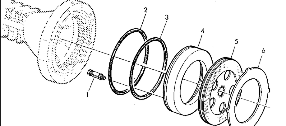

When repairing brakes remember to push back the dowlpinadjusters that retract the brakepiston ! To do that fit finaldrive without gasket and thightern. Then remove and fit gasket .
