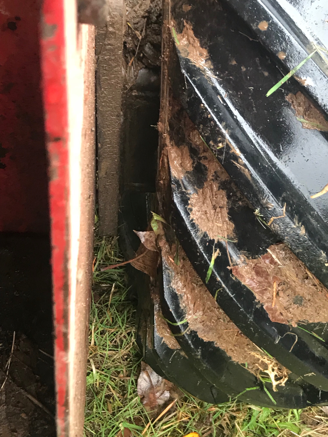

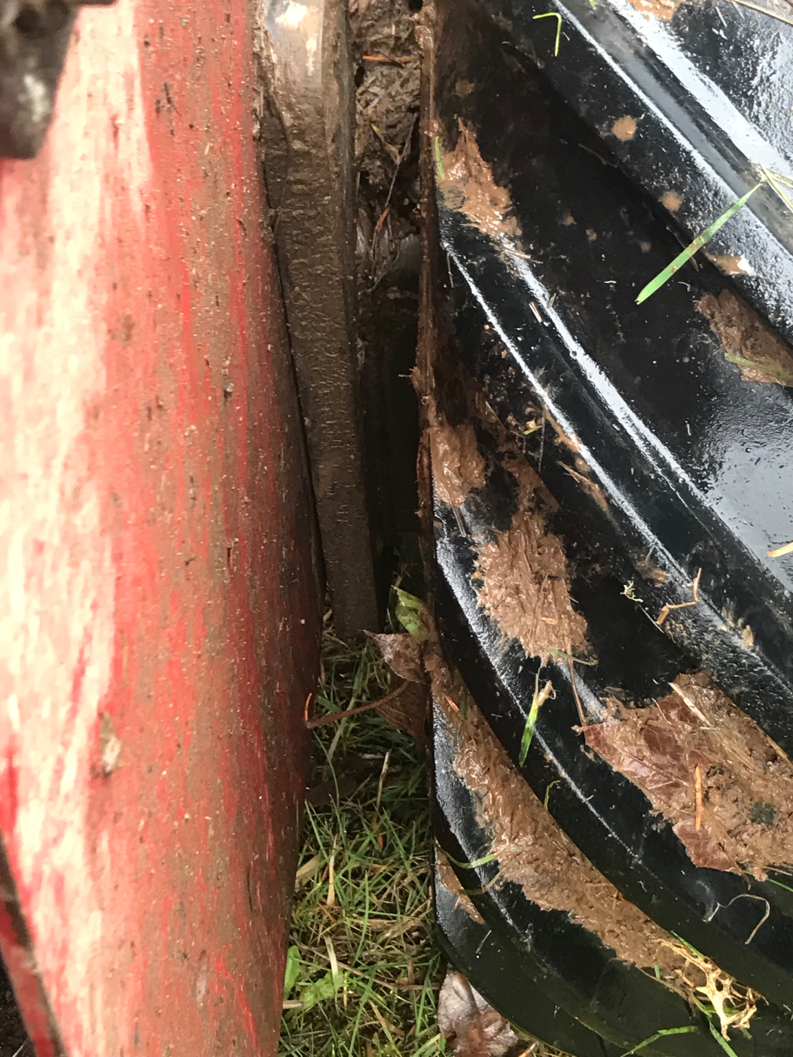

So take a look at the picture. Notice the gap? This should be flush On further inspection 2 of the 6 bolts holding the wheel motor mount to the chassis are broken off. As well I am missing a bolt on the other side. Broken off. Haven’t checked the rear bolts yet IMG_5295.JPGIMG_5296.JPG

I am wondering if it isn’t the chains I run with. Too much traction. Again the history of the Machine is checkered. It could be something that has been missing since the beginning and I never put it together. I will never know.

By wheel motor mount, is that the box the wheel motor mounts into? I thought those boxes were welded onto the frame.

Every machine is different. For me there are 6 hex cap bolts holding the motor mount to frame.

Are you running duals like it shows in the picture? If yes this puts a lot more strain/ torque on drive train and might explain the broken bolts. I have seen duals break the axles on farm tractors.

Yup, I have duals but the machine is designed for it. I am waiting for the other dual wheel owners to chime in and see if they have all 6 bolts. Tomorrow I will call the factor to confirm how to remove and will get some new ones put in.

Spoke to Terry at the factor (OK i was typing too fast). He says once in a while he has heard of one working loose and letting go. Mine don't look like they loosened but maybe one did and then took another. Anyway, should be an easy fix, just have to pull the welder out and accept a lost day of work.

Fixed the bolts today. Found a hose with a slight weep and need to get a weekend hose. Had to tear the motor mount down. Got the motor on it’s own and it seems product numbers are ground off. Oh well.
