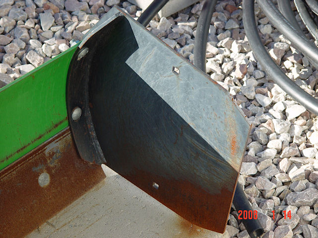

Do you happen to have a photo of the rear blade side plates? It is on my list of projects to build a set for the back blade posted above. I am especially interested in how the side plates are braced. I am thinking of running a diagonal brace (angle or pipe w/flattened ends, etc) from the front edge of the side plate inward to the blade just above the cutting edge. The plates would be 1/4" thick plate and bolted onto the blade with a couple of angle iron tabs. Do your side plates have any additional reinforcing?
I'll try and get a couple of pictures for you and post them. I usually just use one end plate when I want to channel dirt to one side. They are heavy and the only reinforcing is a strip of flat welded on the plate that acts as the attachment point to the rear blade.

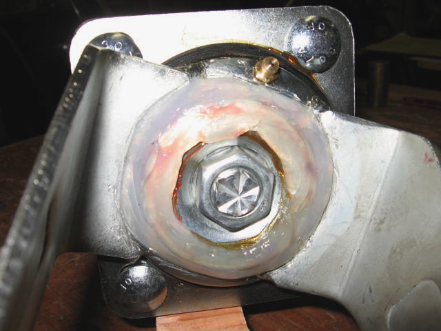

Yes, I doubt the HF wheels will last. They have bearings, but not sealed well despite the specs stating they were. The pivot bearings have zerks, the wheel bearings don't. The pivot bearing race has an exposed gap at the lower ball bearing race. I made a silicone dust cover for them. After masking I packed the race with a needle grease gun attachment (Kragen Auto) then removed masking and greased the outside of one race for silicone release. I was going to take pictures of the process but didn't. But here is the finished seal. When it sets overnight (or longer) I'll see if the release worked.
Other posts have used the HF wheels so I thought I'd give them a try...cheap. I've already begun to think about replacing them. The wheel is not difficult, it's finding a sealed pivot assembly that's hard without spending a fortune.
Well time will tell, in case you get this idea maybe it will save you some money. Once the bearings went out on a HF wheel I though I would get smart and buy some sealed bearing. The bearings never wore out but the rim holding the bearings failed. This was on a 3'x4' atv cart so I never carried more than a 3-4 bags of corn. After the rim failed I ran it for a season as it (hey it still rolled!!) until I found the goat card wheels.

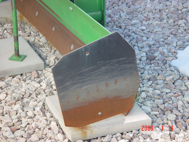

Here are a couple of photos of the Frontier/Woods end plates on my rear blade.
Thank you for the photos.
I had thought some diagonal bracing would be needed to keep the side plates from flaring outward. I see carriage bolt holes top & bottom on the side plates and on one of the photos a corresponding carriage bolt hole at the top of the blade. Do you use a diagonal brace through these holes or do you find that a brace is not needed?

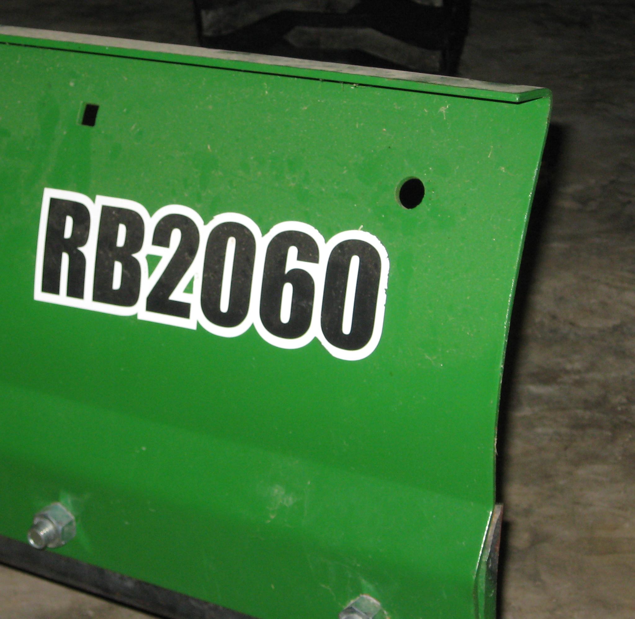

RedDirt - Nice build. Those look like they will work well.
I have the same problem getting the bandsaw to cut straight and shim it just like you.
mjncad - the holes in my Frontier blade are located at the top of the blade and I still can't figure out what they're for.
That square hole is what I thought may be for a diagonal brace for the optional side plates.
But I don't see (on yours) the lower round hole that mjncad has for his side plates. (?)
Sorry, not meaning here to Runner's post.
I use the end plates as is from the factory and haven't felt the need for more bracing. They are pretty stout and heavy.
