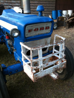

Did as instructed, copied down what I could read and went by a local shop to find a manual. Apparently I have a 1965 Ford 4000 that was built on August 17 during the day shift. The third row of numbers started with a B which supposedly means that it was built in England? Any way, glad to know that, just ready to get started. Up first is to get the tach cable connected to the dash, then get all of the lights wiring working properly. Currently no lights work at all. Not sure if it's bulbs or wire, so testing the connections on the switch, then moving to the lights testing for current first. I see no real reason to upgrade to a 12v system other than potential better battery charge between cuts, anyone have an opinion about that? At this point, I guess I need to move this thread off to the proper forum here, but just to stay with the theme here, I paid right at 3k for the beast. Feeling like it was a good deal. The motor runs like a champ, tires have several years left on them and an all around solid ride minus some work I'll need to do on the tins. Adding a pic to show that front end from an iPhone pic. Thanks for the help guys. Looking forward to getting this thing back in shape!!

That's quite a weight box on there. If you don't need it, will it come off easily?

Latest update is that I've swapped out most of the fluids, (more this weekend) worked on the wiring to relocate the headlights, and get that 300 lbs basket off the front and primed. I've also put a primer coat on the rear wheels to ready them to be rotated outward. Local folk in the area tend to rotate tires outward to provide better stability on some of the hills. Also got a tach adapter to go onto the generator, granted I swapped out the generator and voltage regulator. The battery light was staying on after cranked and heard that it could be either. But have learned in the past to replace both if one is causing the other to go bad.
