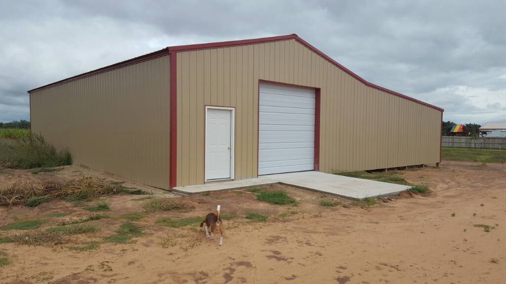

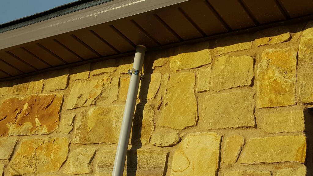

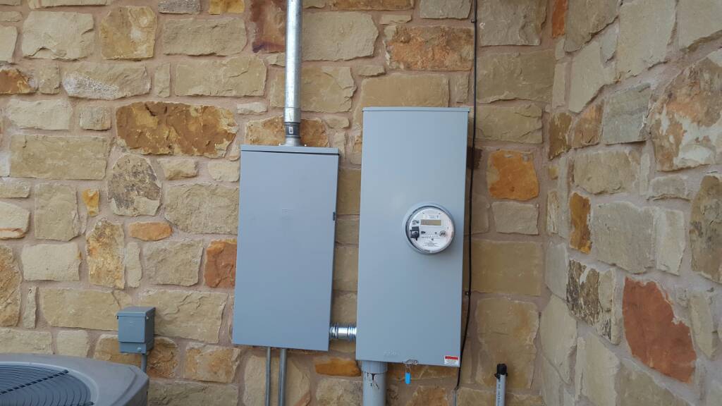

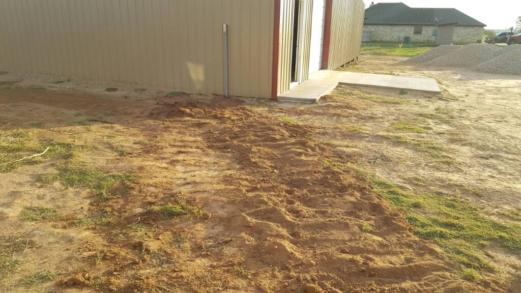

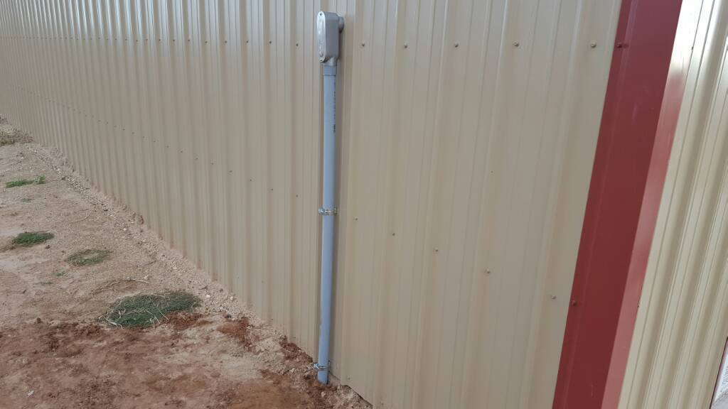

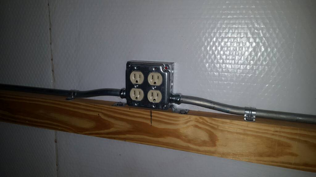

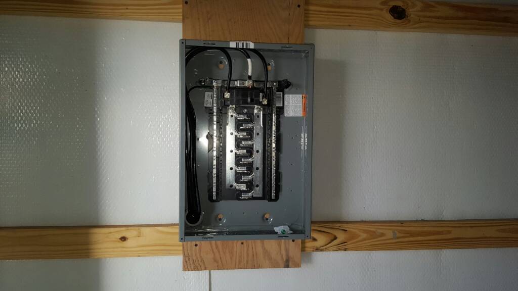

Just finishing up mine....I have a 30x50. We ran 100 amp service to the barn from our 200 amp service at the house. I used copper, as others have said a little more expensive, but I wanted to do everything right the first time. We installed 10, 4 bank outlets on the long walls, outlets on each end, dedicated Compressor, 20 amp, outlets in each corner in the ceiling, outlets on each exterior wall, 20/30/50 amp Rv box, switches on each and I have drive thru doors. I put 6, 48 inch 6 bank LED lights for the ceiling interior and a dusk to dawn flood on each door outside the barn on switches as well. Also an outlet dedicated for my garage Openers. Also go with a large panel, so you have plenty of space. Everything is ran is metal conduit for protection. The reason I added some many outlets, etc. Is due to my thread on here asking the same thing a few weeks ago. The best as others have said as well, is do it now. Get everything you could need in the future and do it once. Yes it costs more on the front end, but I should never have to upgrade......good luck. I am in West Texas.
