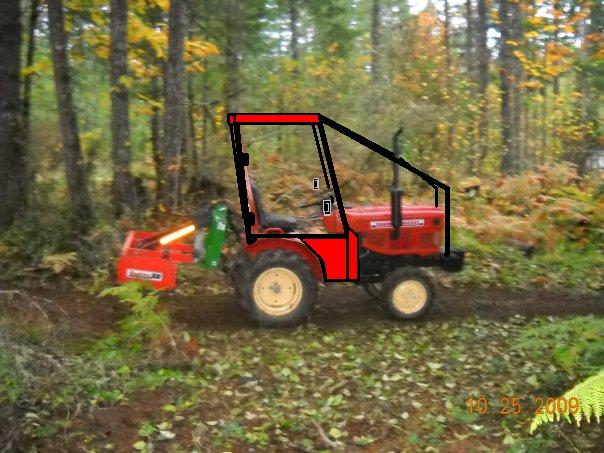

So how much did it cost? It makes it seem posible to put a cab on my yanmar for snow removal.
/ Another DIY Cab...MF GC2600 #9
I wouldnt mind having something like this.... The bars over the hood would be to save the hood from logs or falling branches.
