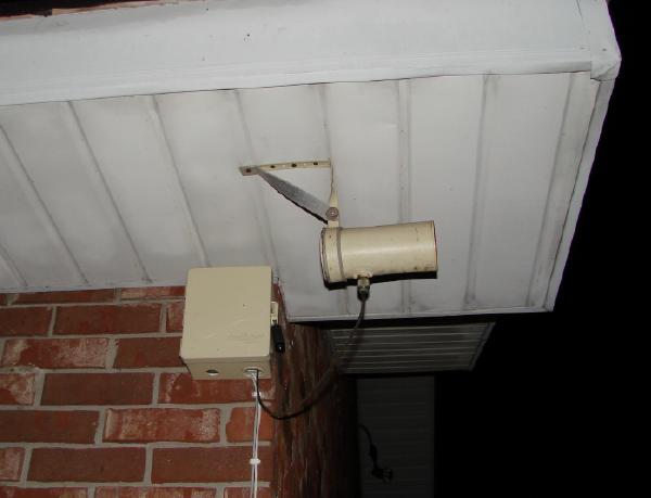

Snowridge, have you played with the cantennas at all? I had access to some sophisticated design software and facilities but was unable to get satisfatory results. The goal was to beam wifi out to an ice fishing shack.
/ Another Computer Question #59
This is the cantenna my son installed at my home. His house is on my property 600 feet from mine and he shares my high speed internet connection. There is no other home in the direction my antenna is facing for over 500 miles so we probably took a lot of security precautions for nothing. He says this system is working better than when he had cable connected directly to his house.:)
/ Another Computer Question #60
600 feet is decent range. To get to the fish I need to be about a kilometer or two out. Many sites claim they get 2Km from a pringles can. Maybe I'll experiment a bit more.
