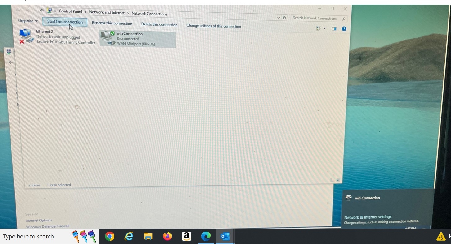

If your other computer and phone are seeing the Wi-Fi connections, then the router setup should be OK. I think a good starting point would be to confirm that there is a wireless networking device in the new computer.
Go to Start - Windows System - Control Panel - Network and Sharing Center. Click on Change adapter settings. Look for an entry that says Wi-Fi.

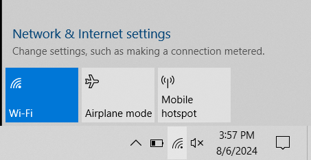

I did that as the attached photo shows after I clicked on "start this connection" the box popped up at the right bottom of the screen that says "change settings such as having the connection metered".
yea that photo shows you don't have a wifi card installed. that "wifi" is not it, thats a ppoe connection thats been renamed.
