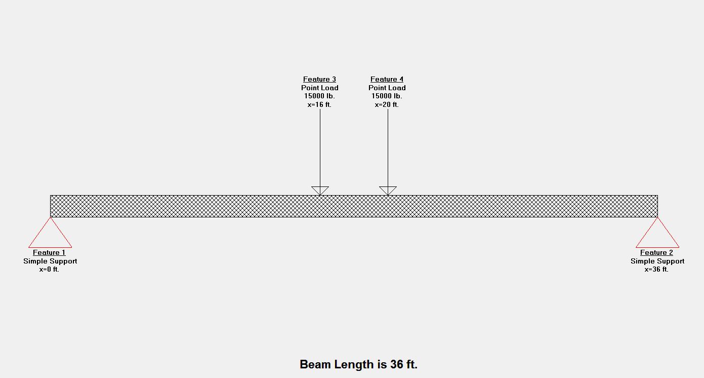

Before I take this design to an engineer, though, I'd like to be able to run some calculations on the weight capacity myself, but I can't find a good site that will give me these calculations for beams that big. I am also open to any and all suggestions on what might work given these beams. I already own them, and although they're overkill for something like this, I think their size opens up plenty of possibilities about how to build this bridge.

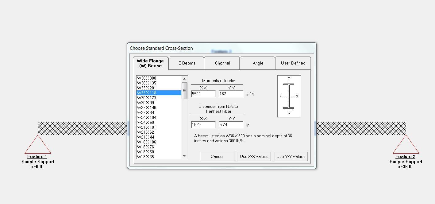

4 beams is overkill if you can come up with a good way to deck it. As for a program for the beams, download beamboy. Simple and handy. I just plugged in one of your beams, and with a 35' span, that beam will have no issues supporting 100,000 pounds point load right in the middle of the span. Deflection would be ~0.85. With a distributed load, roughly double that rating. and thats for ONLY 1 BEAM. You are talking about 4??
So now we talk about decking. If you only use 2 beams centered at 8'6", and each top flange of the beam is ~12", you will have a 7'6" span between the beams, and a ~2.5' span outside the beams. Each 4x10 would be capable of holding ~4000# load that is evenly distributed. But beyond that, calculating the decking gets more complicated than simple steel. Many different wood species and grades, many different ways to attach them all together, lower ratings for wet-service location, etc. Depending on how they are all tied together, instead of a bunch of individual 4x10's, you basically have a big 35' x 10" chunk of wood. That is where you will need to speak with a local engineer to see what is acceptable in your area. But I would think topping with 4x10's would be fine.
But no matter how strong you "think" you build, you still need to talk to an engineer and get his approval and an actual load rating. Without that, you may have a hard time convincing 80,000# concrete and delivery trucks to cross, as well as the fire department.

I might not have been as clear as I should have been....this is not a "DIY by guessing" kind of job. I will certainly be having a local engineer do the planning and final calculations and tell me what I need -- but I was trying to do more of the design work myself and hopefully come up with a feasible idea instead of spending the engineer's time on design. I had downloaded BeamBoy and must have been doing something wrong because I wasn't having much luck in getting a deflection and/or weight rating, so I appreciate the calculation on my behalf. And "pier" was a poor choice of words, since I know that the abutments on which these beams will rest are going to have to be pretty heavy duty and will take a lot of cement to form.
