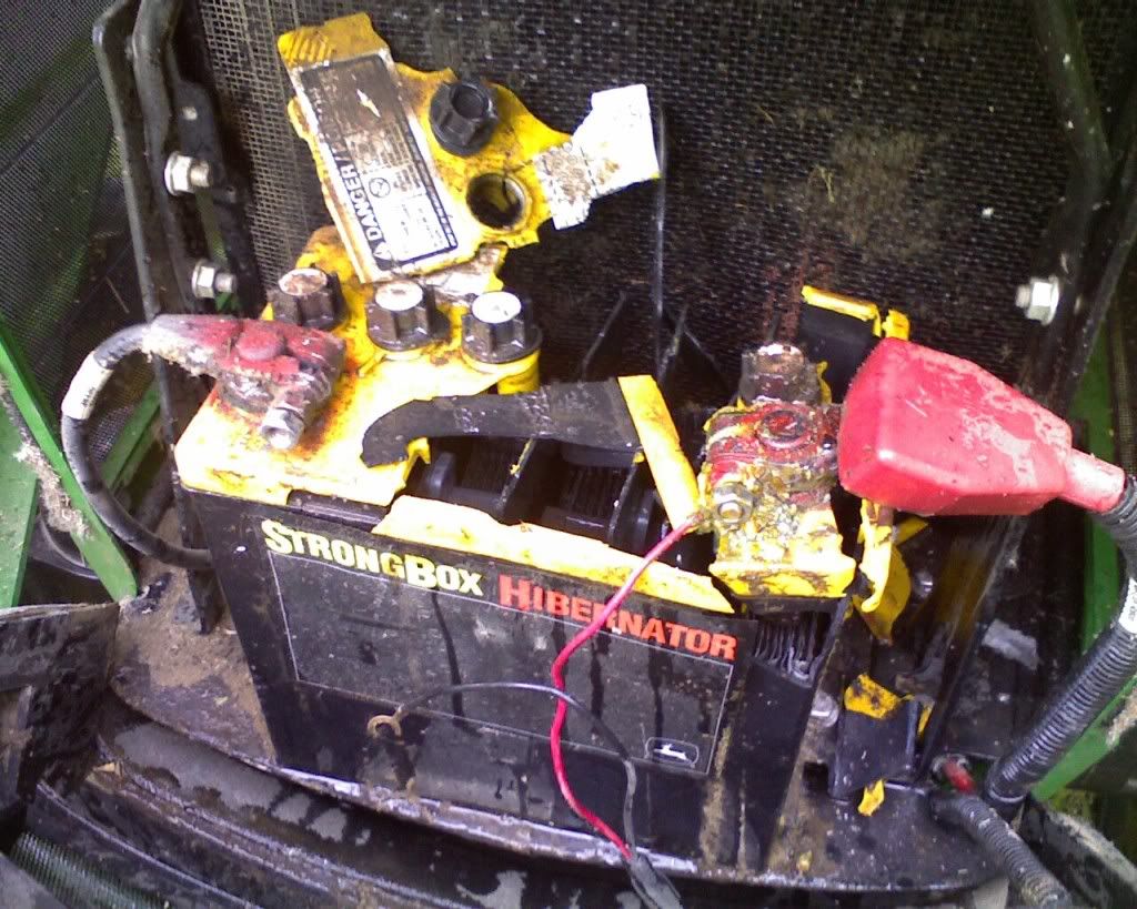

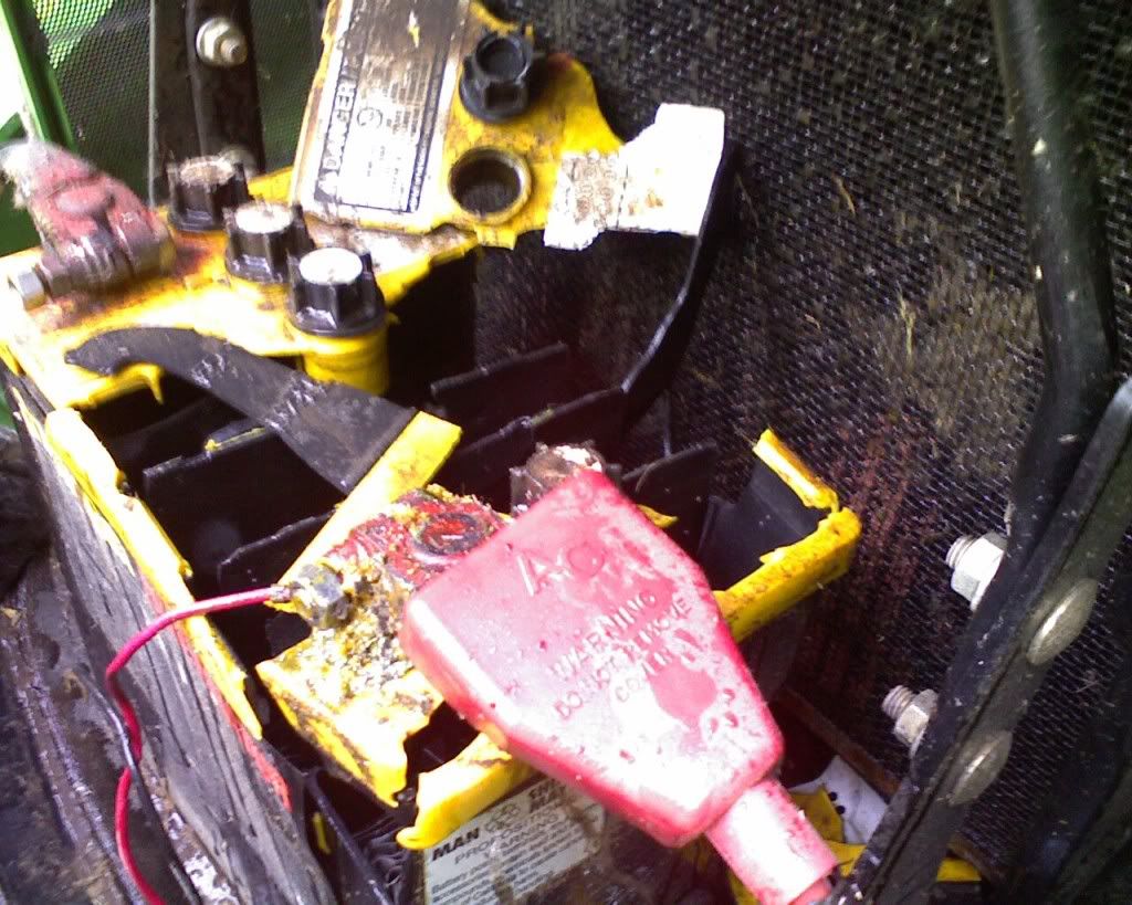

So I was using the tractor to mow some grass out at the farm on Thursday, in preparation for a party. I stopped the mower to check my phone and call my wife for a minute. When I turned the key to start the mower again boom goes the dynamite. A big boom, and then smoke started rising around the engine compartment. When my dad and I looked under the hood, this is what we found.
Fortunately the battery was as far away from me in the driver seat as possible so I didn't even get a drop of battery acid on me. We grabbed a car jump battery and were able to drive the tractor up to the barn and rinse it down. Then on Friday we neutralized everything and installed the new 5th generation battery. My dad was hoping for a glass mat battery, but apparently J.D. doesn't have one for our model. This one is supposed to vent differently. We will see.

The blowing up part is the hydrogen that is produced during the charging process. Wonder what is producing the spark? Loose connection?

I own a Dodge with a Cummins diesel and two batteries. I replaced the original batteries with Interstate batteries. About three years later, one of those Interstate batteries exploded just exactly like yours. I was lucky to have my truck in my own driveway with a pressurized hose laying 10' away. It made it a non-event for damage because I was able to flush out all the acid immediately. I still remember turning the key and the huge BOOM! that followed. It was so loud that my neighbor and his wife came running to help from almost 1/4 mile away.
My theory is that the battery fluid gets low, allowing a large pocket of air at the top and exposed plates. With charging, hydrogen builds up inside the battery instead of being vented out. When the battery is put under the instantaneous load of starting, there is a small internal arc that ignites the hydrogen. BOOM! I believe I should have been more attentive to the electrolyte level in my battery and this would probably never happened. I'm just not sure.:rolleyes:
The result of this happening has made me very cautious about jump starting batteries or being too near one when someone starts their car. I do use a jumper battery and cables, but I always ground the jumper to the auto chassis away from the battery after connecting the positive terminal. I then stand well away from the battery while starting is attempted. Reaching over and jiggling the positive jumper to get a better connection while someone is attempting to start is playing Russian roulette. Those arcs at the posts while the battery is under load can surely cause an explosion of any hydrogen gas that is around. It's done thousands of times with no harm, but one battery blowing up will make you cautious if not overcautious. I'm a believer.:)

A close look at the picture will reveal a source for a potential spark.

I saw that loose black wire too but it would also appear that the blown off positive lead could have jerked that black wire off.
