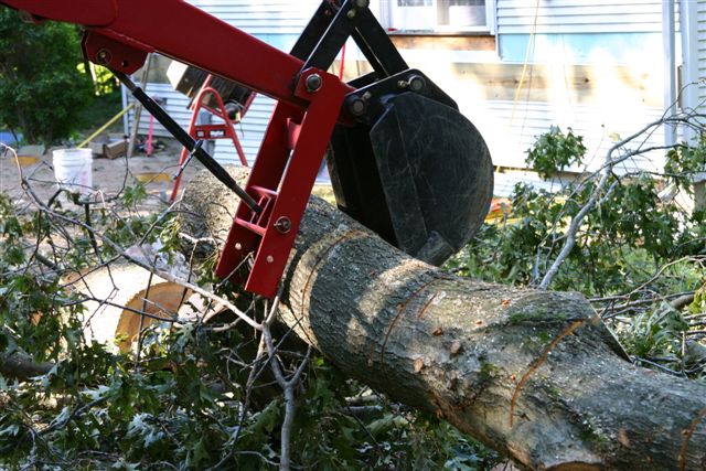

BobQ, have any more pictures or close ups of that?
mike
   / Another Back-Hoe Thumb #12
This is the only other one I have handy. Hope it helps!

Was the hole in the arm already their or did you have to cut it out. I really like the idea but I think the hole would make my small BH6000 a bit weak.
No, I cut the hole along with welding in a sleeve to add strength.
The thumb is a perfect fit inside top to bottom.
Maybe have a better look at the pic's.
If you have a smaller B/H maybe try using smaller tube?
My sleeve is 3inX1/4 wall thick the thumb is 2 1/2inX1/4 wall which makes a perfect fit.
As long as you use 1/4 wall tube it should be very strong even with smaller tube.
Hope this helps?
