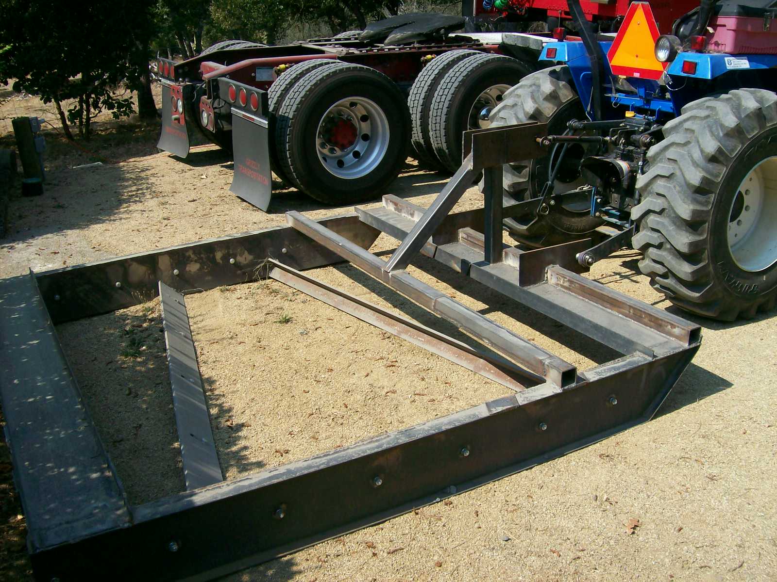

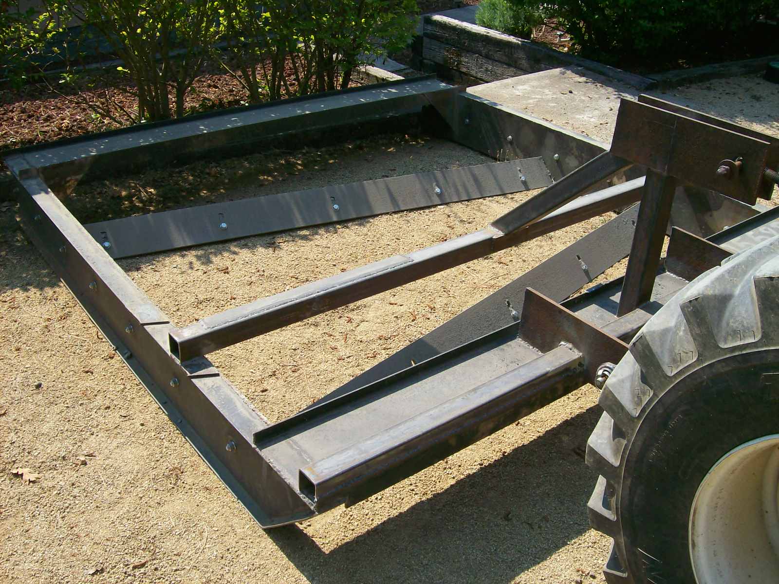

Building a road grader / land leveler and My question is this :
At what angle and pitch do I go with for the blades ?
Angle being from one side to the other and pitch being the actual slope of the blade from top to bottom .
Those who have made theirs or even those with bought ones like from Land Pride or King kutter Please help a guy out .:D
Fred H.

Those are hard questions to answer. They have been asked before and in my recolection there are many configurations that have been built and they all are said to work fine. Some angle both blades the same way to help build a crown. Some angle each blade at opposite angles for better mixing. And some, like me, have them straight at 90 degrees.
I don't know what the best angle of attack is but mine is a little steeper than 45* and it cuts like a champ. I have a 4"X4"X3/8 angle irons for blade supports. Set like a pup tent. The rear edge is flush with the bottom of the skids and the leading edge is 3/4" below the skids. Cocking it forward a little and making the blade angle a little more than 45*.
Do a search and you will get lots of ideas and opinions.

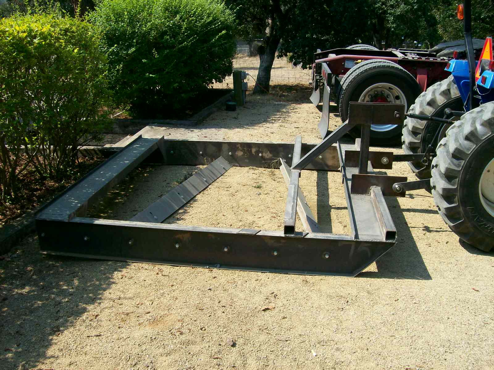

This is what it ended up coming out as , (No color added yet ) . Blades are set at 3/4" now but may move back up to only a 1/2" . One pass down each side of driveway was all I needed . Better Half and Neighbors love it .

P.S. As a side note , I ended up settling on 10 Degree angle and a 45 degree pitch of the blades . I did though forget one thing , Bought the steel but forgot
to weld it on . Two 1/2" x 3" x 8' skid shoes . Wife went to use the newer Dodge and wanted to know what the steel was in back . Duh !! Good thing I
wear a belt , Wonder how many times I would of forgot my pants by now !!
