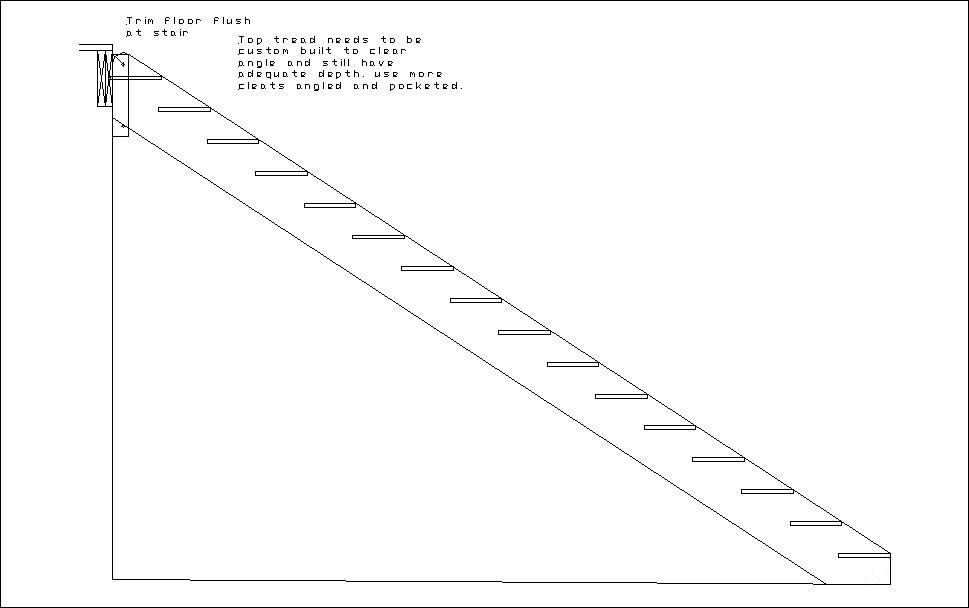

Yeah, love the DeWalt - 4 settings of aggressiveness and a blower is nice. Used it to radius the upper end of the risers so they'd swing on a 5/8" bolt between two pieces of 3x3x1/4" angle which are bolted to the double 2x12 across the face of the mezzanine.
When the stairs are down, the lower edge of the risers also rests on ANOTHER 5/8 bolt thru the angle iron pivots. Doubt it's gonna fall anytime soon....
The treads are 3/4 ply, 10" x 36", no center riser (weight saving) - so all treads have 3-1/2" ribs under them for stiffening/span. I finished all the tread install later today, no pics yet.
There'll be a chain fall on the built in place roof truss right above the lower end of the staircase, gotta weld up a spreader that'll pin on to the stair risers so I'm not trying to pull a tread up (loose) when I raise the steps out of the way... Steve

Dunno about polishing - maybe sanding, or drilling pocket holes - this pull-up staircase I'm almost done with has 527 pocket holes total, 4 full sheets of 3/4 ply, and weighs about 240 pounds total - with the 3-1/2" ribs under each tread there's zero give, and the double thickness of 3/4 glu-lammed risers flex just under 1/8" when I bounce on the middle. The mezzanine is 1-1/8 T&G ply over 2x12's, so I wanted it to not sag with me and as much as I can carry up or down - think I pulled it off :laughing:...Steve

Thanks James - besides making enough floorspace for the big saw and in/outfeed and handling full sheets of 3/4 ply alone, the angles/spacing got a little tricky - when I converted the 36x48 pole barn, I wasn't intending on it being mostly a wood shop so I had the concrete guy put a 1" in 12 foot slope toward the big door -
So I measured everything in the field, duped it in CAD and kept rise/run "gentle" to accomodate an old fart carrying more than he should :laughing:
Surprise - I only had to do one "minor" tweek and it actually fit :eek: - most of the screws are 2", they lack about 1/8" of coming thru the outsides of the risers so they reinforce the glue lam (not that it'd be necessary)
Here's a jpg of the overall cad layout, shows the top pivots. Sorry, didn't convert the details but (ahem) this DID start out being about an old welder :ashamed:.. Steve
