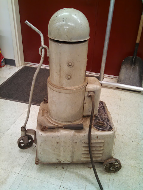

Anybody know anything about this machine? Is there a name for it that can be shared on a family-friently forum? :D I assume the armature is an old-school method for increasing the frequency.
I "found" three of them in the crawlspace of an industrial building (in 2005), gave away 2 and kept one. Its still sitting there today.
Is it worth using? Worth selling? Doorstop? Is it 3phase?
attachment.php
This isn't my pic, its from google images. I tried in the crawlspace but cant get a good pic, the flash illuminates dust and it cant focus.

Looks just like the three phase battery chargers we used to use for our old electric forklifts.

Old school dc welder. Always called them r2d2. Do not know actual name. A/c motor spinning DC generator, pretty decent welder in general. DC only as I recall, most were multi voltage also.

I learned to weld with one of those at a trade school in 1953. Believe they were made by Hobart. WW II ships had them and they had a DC powered motor to drive the welder generator. The one at the school was 460 volts AC on the motor end. They were an Industrial grade unit and bullet proof. Voltage and Amperage output were both adjustable. DC output only. If my memory is not failing; GE and Lincoln also made similar ones. They were called a "torpedo" After WW II you saw lot of them for sale as war surplus. I would bit my money on it will work if intact and not been corroded in the inner works. Don't blame me if my memory has failed; I tried.

AKA "The Fireplug"....ps it's not 110V. lol:thumbsup:
