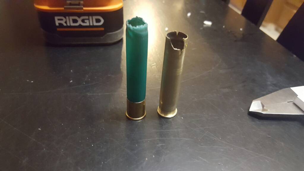

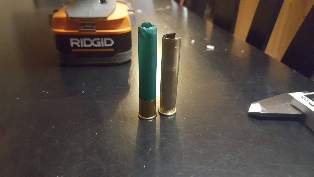

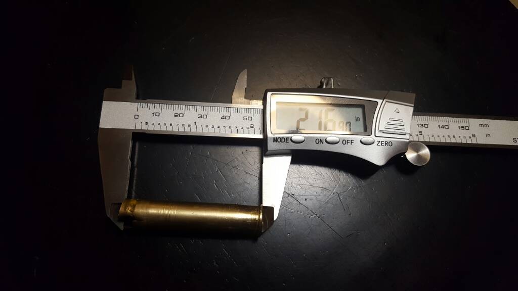

So, here is the first semi-succesful attempt. Ad you can see, the case filled the chamber, but the neck blew out. Next attempt will be a milder charge and all. So, the problem was, that the rim thickness has preventing it from chamberring correctly. I filed the front side of the rim, and it worked. once I get some fire formed right, I'll post more pictures. uploadfromtaptalk1493596609432.jpguploadfromtaptalk1493596613018.jpguploadfromtaptalk1493596616368.jpg

was the action closing fully?

It locked up fine, but I found this .33 British to .41 Shotshell Conversion | Welcome to SurplusFirearm.com and followed their instructions. Only thing I can think of is that it locked up, but wasn't fully closed enough for the firing pin? I probably won't have time to mess with it anymore for a couple of days, but I'll do 4 more with a slight down load of powder and bevel the front side of the rim as well. These, I might just leave the large rifle primers intact, since it doesn't seem there 'hardness' was the issue. Actually, I my bevel and then pop the primers with the gun, before loading new large pistol primers and mild powder loads.

Yup, if not fully in battery pins may not fly.

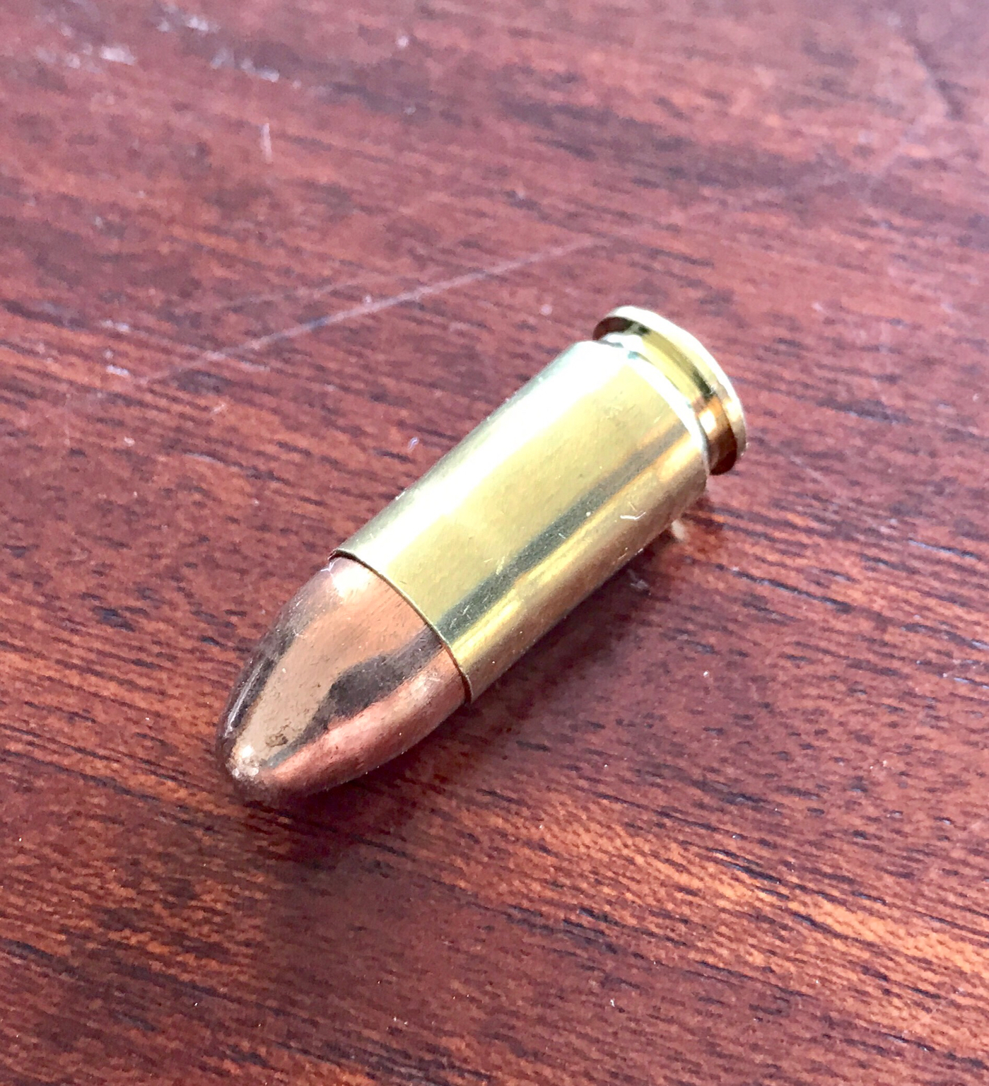

Really would help if you posted some close up pics. Hard to comment as it is a relative thing. Here's a pic of the American Eagle that I have been shooting lately.

Pictures didn't really show anything well. I did pick up some PPU 9x19 115gr for $10.99/50 at Rural King in Gainesville today. Much better (imo) ammo for same price.
