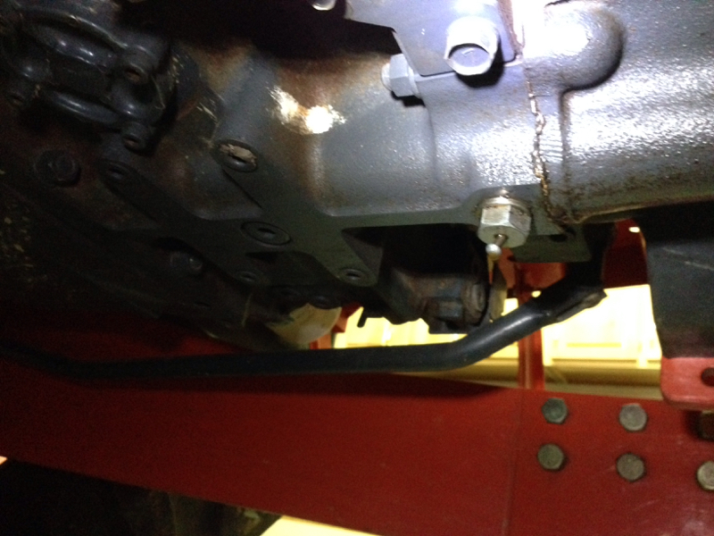

I have a Kubota L3240 that has about 760 hours. It has a vent on the bottom side about in the middle of the tractor which is pictured below. It has been leaking small amounts of oil for a while, but yesterday it started leaking severely. It will sit and idle and not leak at least not very bad, but once it gets hot it starts leaking in nearly a stream of oil. Based on my limited research there is a seal that is blow instead the tractor. Based on the information I have gathered it is relatively inexpensive, but requires the tractor to be split in half to change. I'm not looking forward to doing that.
   / Am I going to have to split my tractor to fix this? #2
Since the front driveshaft was relocated/redesigned to run inside the housings, the seals at the clutch area have proven to be a problem. Normal leakage is little or none but the clutch housing has a bottom drain as a safety to keep the clutch dry. The oil that appears there is trans hydraulic oil so yes the tractor comes apart to replace the seal(s). Only you can decide when its enough of a nuisance to justify the job. In some cases putting oil-sorb diapers on it is adequate for a while.

Most likely it will, according to my dealer there is a seal at the front of the propeller shaft that can cause this, but most likely, it's something more serious. Mine failed under warranty and was replaced.

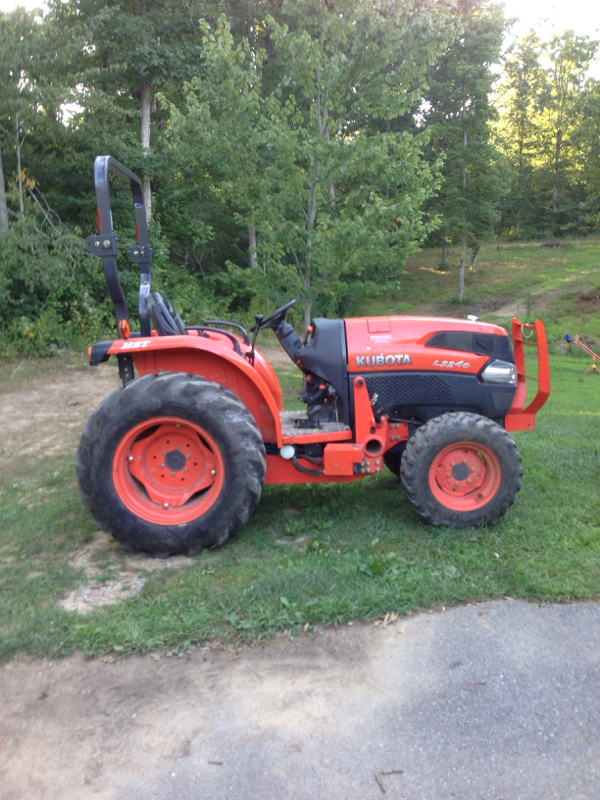

I got the easy part done. I haven't ever driven my tractor without the backhoe or loader. It was kind of depressing. image-4051205462.jpg
   / Am I going to have to split my tractor to fix this? #9
Yes it is. Pretty naked.
   / Am I going to have to split my tractor to fix this? #10
I got the easy part done. I haven't ever driven my tractor without the backhoe or loader. It was kind of depressing. View attachment 475603
I like driving mine without the loader! The power to weight ratio goes way up. It's fun to wind out the throttle and stomp on the go pedal.
