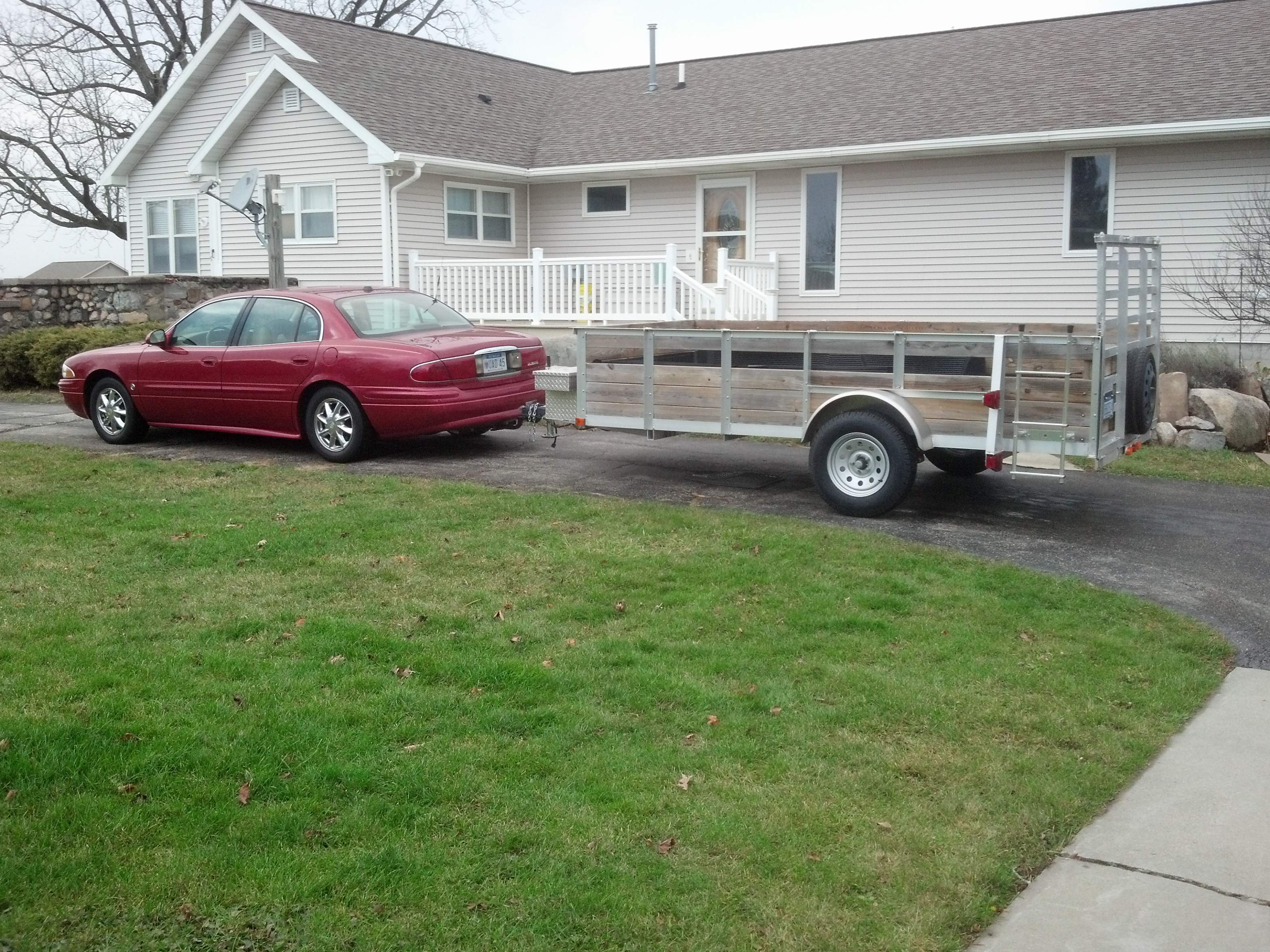

I am on my second Legend brand 6'X12' high side utility trailer, and would never own a steel one in Michigan. The trailer weighs 740 pounds and the Dexter axle is rated at 3,000 pounds. The sides and deck are 5/4" treated pine and the entire unit is super strong, and it has a ramp gate that tilts down. The reason I am on my second one as I sold the first to my brother who was always borrowing it. You pay a premium for aluminum but will always get it back when resale time comes. My '04 Lesabre can easily pull this trailer and has 1200 pounds of cargo capacity in it before it exceeds the 2000 pound tow rating of the car.
